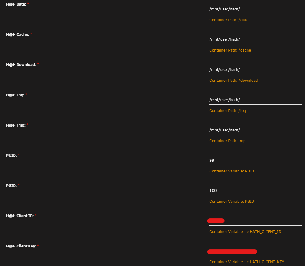

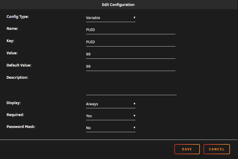

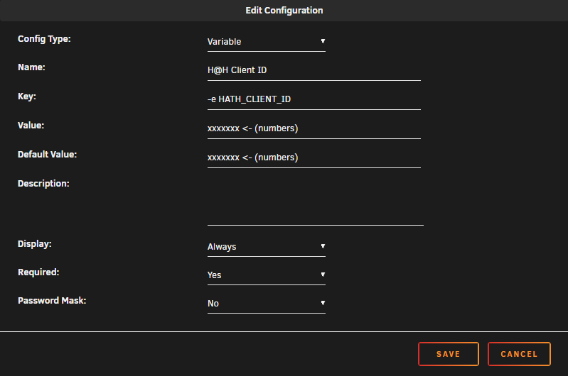

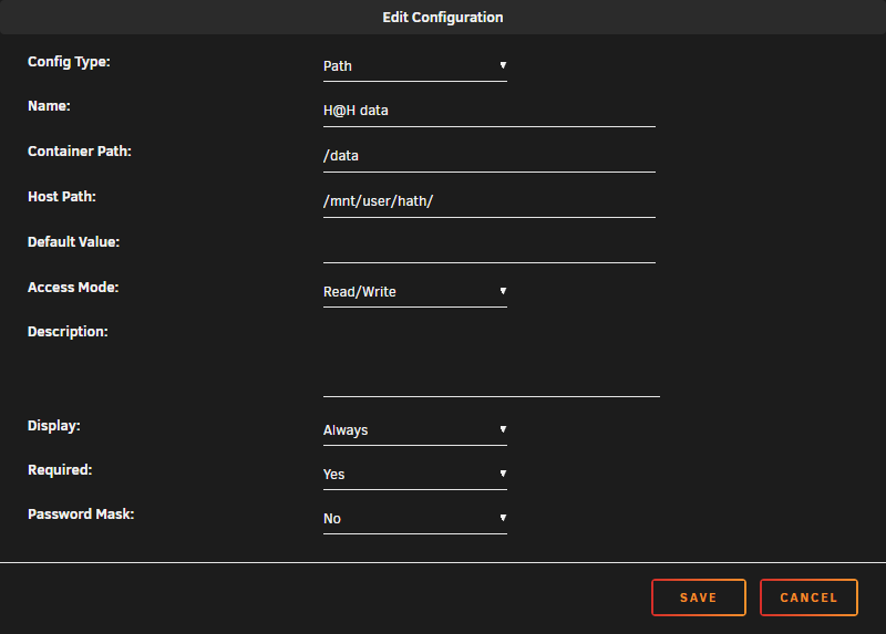

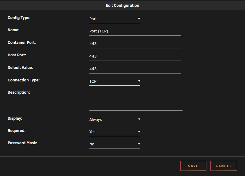

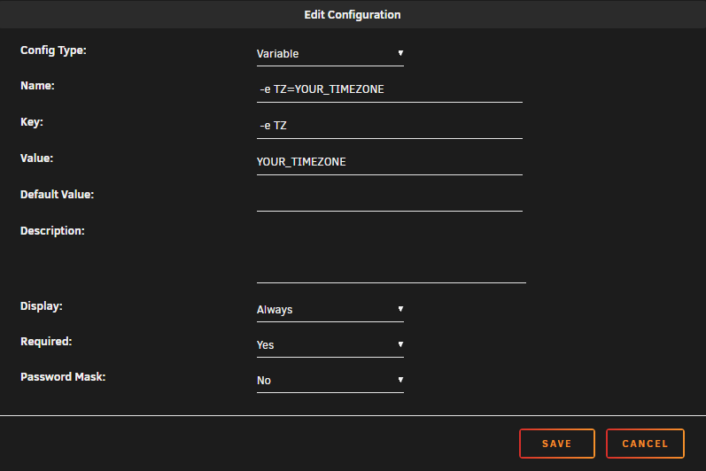

1a. How exactly do I enter the values correctly, which I have specified in the given URL?
1b. How wrongly/correctly have I made the indications which are to be seen in the screenshot?
2. what else do I need to do to make the container work?

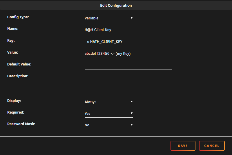

You don't need the "-e " in any of those variables.  It's implied already since you're creating a variable and what you're do is creating a variable named "-e variablename" instead of "variablename"
Unless you're running the container on its own dedicated IP address (network: br0) then the host port you've specified of 443 is already in use
Thanks. I have changed this part.
But what do I have to enter in the timezone (TZ) variable so that it gives my correct time? Is this the correct format? -> Europe/Berlin
Edited by AceBurn90
no, unraid by default will pass unraids time zone as variable to the container.

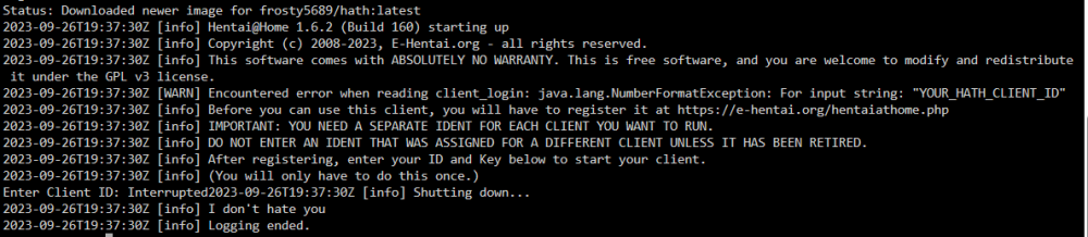

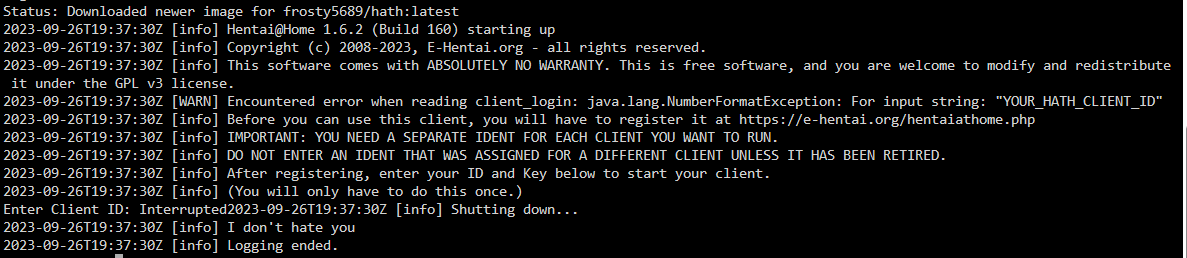

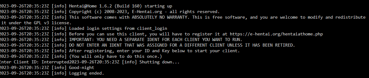

Now I have saved my files (took 2.5 days). After that I could start the Docker Container for the first time but I got this error:
2023-09-23T07:50:27Z [info] Hentai@Home 1.6.2 (Build 160) starting up
2023-09-23T07:50:27Z [info] Copyright (c) 2008-2023, E-Hentai.org - all rights reserved.
2023-09-23T07:50:27Z [info] This software comes with ABSOLUTELY NO WARRANTY. This is free software, and you are welcome to modify and redistribute it under the GPL v3 license.
2023-09-23T07:50:27Z [WARN] Encountered error when reading client_login: java.lang.NumberFormatException: For input string: ""
2023-09-23T07:50:27Z [info] Before you can use this client, you will have to register it at https://e-hentai.org/hentaiathome.php
2023-09-23T07:50:27Z [info] IMPORTANT: YOU NEED A SEPARATE IDENT FOR EACH CLIENT YOU WANT TO RUN.
2023-09-23T07:50:27Z [info] DO NOT ENTER AN IDENT THAT WAS ASSIGNED FOR A DIFFERENT CLIENT UNLESS IT HAS BEEN RETIRED.
2023-09-23T07:50:27Z [info] After registering, enter your ID and Key below to start your client.
2023-09-23T07:50:27Z [info] (You will only have to do this once.)
Enter Client ID: Interrupted2023-09-23T07:50:27Z [info] Shutting down...
2023-09-23T07:50:27Z [info] Your business is appreciated
2023-09-23T07:50:27Z [info] Logging ended.

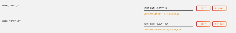

youre missing the enviroment variables
and then youre also missing the key value, as in my case (since java expects a number, not letters)
Edited by Mainfrezzer
What do you mean by "youre missing the enviroment variables"?
The HATH_CLIENT_KEY consists of 5 numbers which I have entered.
The HATH_CLIENT_ID consists of capital and small letters
and numbers, which I have also entered.
HATH_CLIENT_KEY - 12345 (not my key)
HATH_CLIENT_ID - abCdeF123gHiJk456789 (not my ID)

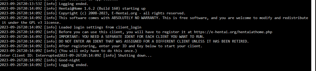

In "/mnt/user/hath/data/" there is a file "client_login".
In this file is the following text -> Note the dash after 12345 (adjusted):
12345-abCdeF123gHiJk456789

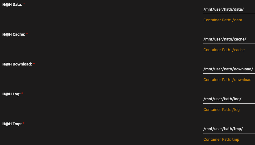

And while we're at it, in the second screenshot here, is the file location correct like this?
Edited by AceBurn90
I found the issue, for some reason its not really doing what its supposed to do.
the container creates a file, which i can only assume, is supposed to hold that info. But it seems borked. So you would to modify following file, in my case now
"/mnt/cache/hath/data/" there is a file called "client_login" there you have to set the content like "123456789-YOUR_HATH_CLIENT_KEY"

juding by my output. You need to flip it, ID first, then key
I have swapped ID and KEY in the Text. In the Screenshot you can see that I have it right side up.
Since the file was generated automatically by the program on my old Windows desktop "server" three years ago.
This means that there must be some other problem.
I also just noticed that there is nothing in my appdata folder in the hath folder.
Edited by AceBurn90
In the file. the file content has to be flipped by hand. The client_login has to be ID-KEY
The stupid file only gets created once but never edited. So its absolutely pointless to even set the enviroment variables in the first place

I just noticed. Your text and image is confusing.
But the screenshots shows the other way around xD
12345-abCdeF123gHiJk456789 if thats what you currently have and the key is 12345, it would need to be flipped. Thats what confused me.
Since i dont have an account, this is as far as i can get
i would say, thats enough on my part. no more errors. For any account related inquiries on a varity of website im no help^^

I have already written several times that the file is correctly saved and the content is also correct, because it has already worked like this for 3 years.
Can you took a screenshot auf your appdata/hath folder and what it looks like?

I am now using you modifyed XML and it works.
I can not tell exactly why.
I have added the Registry URL: https://registry.hub.docker.com/r/frosty5689/hath
And changed Network Type to Host
Then I changed my file path from:
cache - /mnt/user/hath/cache/
Data - /mnt/user/hath/data
Downloads - /mnt/user//hath/download
Logs - /mnt/user/hath/log
Tmp - /mnt/user/hath/tmp
to (see "appdata" changes)
Data - /mnt/user/appdata/hath/data
Downloads - /mnt/user/appdata/hath/download
Logs - /mnt/user/appdata/hath/log
Tmp - /mnt/user/appdata/hath/tmp
After that, it worked.
Thanks for your effort

Thats good, glad i could help.
The host mode certainly fixes the need to figure out which port is needed since i had no clue what to map there :D

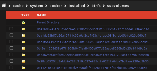

The reason for this is that the cache data is wildly distributed in the directory:
“cache>system>docker>installed>btrfs> subvolumes > {several folders with number & letter combinations}"
Like this:
I now need to adjust the location and move the cache data all to the designated place and at the same time keep the downtime as short as possible.
But now I don't know how to find the right cache data from all the folders and move it to the correct cache folder.
Do you or anyone here on the board know what the best way to do this is?
