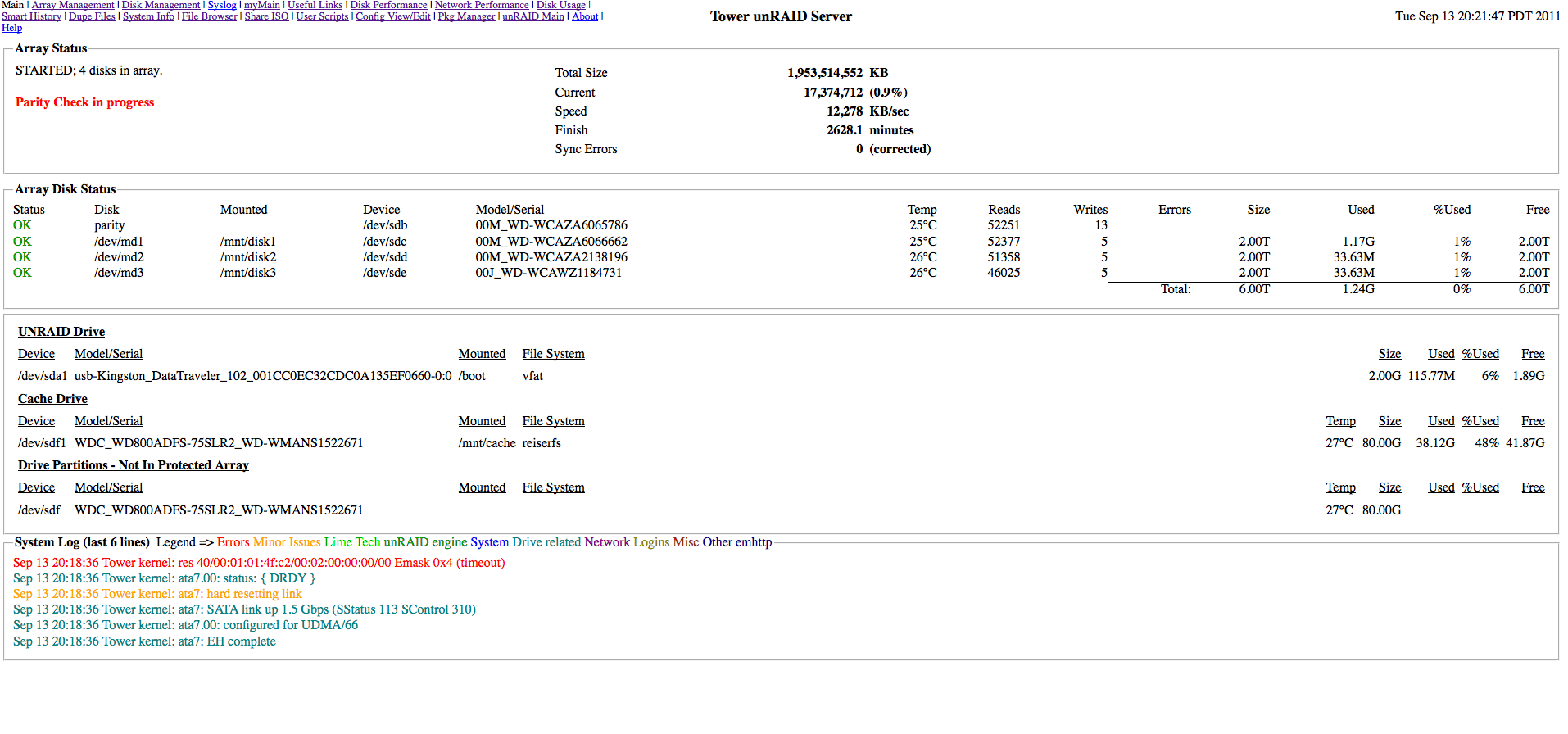

And the fact that going from page to page on the web interface and bringing up unMenu takes anywhere between 10-30 seconds each. After a reboot its quick, for a bit - but then it is back to it's normal slow response.
I also attached a screen cap from unMenu that shows some errors.

Attached Syslogs are with the CPU settings as they were and then with clockspeed, voltage, etc all set as Auto in the BIOS.  It seems like the core unlocking is a one-way door?  I am not too familiar with OC'n machines and def not the current crop of processors so I am not too sure what is going on there.  I basically defaulted everything and then turned off cores 2,3,4,5,6 (only has '2' though I think) in the BIOS. Shows up as the Athlon either way, though I am certain that the unlocked cores are off.  Read a little on the chip and it seems like it is one that people mess with, unlocking the cores, raising the clockspeed, etc. - it seems to be able to be pushed pretty far, though it's not needed in this case.
Couldn't get a hold of my friend but I am fairly confident that is is not overclocked and if there are more cores unlocked they are off. I remember my friend saying that 2-cores was fine and overclocked those was fine if I put in a bigger heatsink and fan (on it is just the retail AMD one).
Maybe someone more familiar with ASUS boards will now what I mean here but when it is booting you see 'Press 4 to unlock cores' and you can hit '4' on the keyboard and it  shuts off.  When it boots up again the 'Press 4 to unlock cores' is not there and it says something like 'Cores unlocked'. You can then go into the BIOS and selectively shut down the cores.  Funnily enough, it always says 4 are unlocked after the initial 'Press 4 to unlock cores' message comes up and you hit 4.  The POST screen has a 4(up arrow) icon next to it. Pretty sure it only has 2...
Where I am at now:
Did the BIOS changes, plus made sure all the audio and unnecessary comm ports are off.  Enabled the Realtek NIC and pulled the Broadcom. Pulled the M8 SAS for now, there are no drives on it. Pulled the 2-port that the Cache drive was on.
unRAID booted up, I was able to get around the web interface OK.  No red in unMenu and all my existing drives were there and the shares were available.
Went to my Movies (ISO) folder where I had copied 8 movies... only one was there (though it was a complete file and useable). The errors were probably the cache drive like was mentioned above and it was probably trying to copy from the cache to the regular array but was having issues.
Wrote directly to a couple of the disks from a USB 2 HDD connected to a laptop that was connected to the LAN, around 26Mb/s average.  When I copied from the HDD on the laptop to the disks it was around 32 or so.  Read from the share shifted between 90-105, so that seems about right.
Rebooted and started the memtest, which is where it is at now.
Feel better about where it is at, given how it was behaving. I will probably add the SAS card and put a different drive on there and ensure that unRAID can see it and add it to the array.  Like I mentioned, I don't care about the 15th drive slot at this point so a replacement PCI stat card isn't a concern (though I could try it with some other drives I have).
If anyone has info about ASUS boards and the Sempron 140 and where it should be as far as cores and clockspeed let me know.

Can't access my unRAID bios...but here is a comparison of what is being posted in the syslog:
M4A785-M and Sempron 140 CPU (mine)
Aug 31 20:26:16 Tower kernel: Detected 2712.372 MHz processor.
Aug 31 20:26:16 Tower kernel: Calibrating delay loop (skipped), value calculated using timer frequency.. 5424.74 BogoMIPS (lpj=27123720)
Aug 31 20:26:16 Tower kernel: Mount-cache hash table entries: 512
Aug 31 20:26:16 Tower kernel: CPU: L1 I Cache: 64K (64 bytes/line), D cache 64K (64 bytes/line)
Aug 31 20:26:16 Tower kernel: CPU: L2 Cache: 1024K (64 bytes/line)
Aug 31 20:26:16 Tower kernel: mce: CPU supports 6 MCE banks
Aug 31 20:26:16 Tower kernel: using C1E aware idle routine
Aug 31 20:26:16 Tower kernel: Checking 'hlt' instruction... OK.
Aug 31 20:26:16 Tower kernel: SMP alternatives: switching to UP code
Aug 31 20:26:16 Tower kernel: ACPI: Core revision 20090903
Aug 31 20:26:16 Tower kernel: ..TIMER: vector=0x30 apic1=0 pin1=2 apic2=-1 pin2=-1
Aug 31 20:26:16 Tower kernel: CPU0: AMD Sempron 140 Processor stepping 02
Aug 31 20:26:16 Tower kernel: Brought up 1 CPUs
Aug 31 20:26:16 Tower kernel: Total of 1 processors activated (5424.74 BogoMIPS).
Yours...
Sep 15 06:31:40 Tower kernel: Detected 3013.992 MHz processor.
Sep 15 06:31:40 Tower kernel: Calibrating delay loop (skipped), value calculated using timer frequency.. 6027.98 BogoMIPS (lpj=30139920)
Sep 15 06:31:40 Tower kernel: Mount-cache hash table entries: 512
Sep 15 06:31:40 Tower kernel: CPU: L1 I Cache: 64K (64 bytes/line), D cache 64K (64 bytes/line)
Sep 15 06:31:40 Tower kernel: CPU: L2 Cache: 512K (64 bytes/line)
Sep 15 06:31:40 Tower kernel: CPU: Hyper-Threading is disabled
Sep 15 06:31:40 Tower kernel: mce: CPU supports 6 MCE banks
Sep 15 06:31:40 Tower kernel: using C1E aware idle routine
Sep 15 06:31:40 Tower kernel: Checking 'hlt' instruction... OK.
Sep 15 06:31:40 Tower kernel: SMP alternatives: switching to UP code
Sep 15 06:31:40 Tower kernel: ACPI: Core revision 20090903
Sep 15 06:31:40 Tower kernel: ..TIMER: vector=0x30 apic1=0 pin1=2 apic2=-1 pin2=-1
Sep 15 06:31:40 Tower kernel: CPU0: AMD Phenom II X4 B45 Processor stepping 02
Sep 15 06:31:40 Tower kernel: Brought up 1 CPUs
Sep 15 06:31:40 Tower kernel: Total of 1 processors activated (6027.98 BogoMIPS).
Sweet, so mine is faster...  8)
;)  I haven't had it lock up or shut down, even when it was slow on the web interface I could log in via telnet or get on the console on the machine and shut it down.  Looking online it looks like that its pretty popular chip to run at 3.5+ (even with the standard heatsink).  I will resign myself to the fact that it's at least stable from the CPU standpoint, unless someone sees a reason it might be unstable.
Here is some info about unlocking and overclocking:
http://www.techpowerup.com/reviews/AMD/Sempron_140/12.html
ASUS as an 'unleashed' option, that's what unlocks the additional cores on certain AMD chip families (gleamed from skimming a couple sites). The clock speed on mine us up though, so not sure what the deal is there.  I will investigate more tonight.
It seems stable.
Writing to it at 22mb/s (writing TB's of data).  Pulling over gig averages 105 or so. Peaks of 120 or so now and again.  This is to a Win 7 box and the file transfer speed being reported is probably not super accurate...
At any rate, it seems fine as is.  Left to do is to bring on the SAS card and a few more drives next week.
Of course, I got my 4th disk (already a refurb from WD - it precleared real slow) showing DISK_DSBL and writing errors.  Parity, Disk 1 and Disk2 are fine.  Can I just pull that 4th and pop in a new one (when I get it)?  Is it best to just pull it right now so it doesnt get more data written to it?
