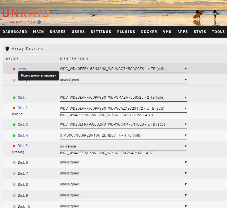

So bit of Schrodinger's cat (If I don't look its still fine) and I was out of town for weeks. Following "dboonthego" 8 steps above. Now I have Disc 2 showing as "wrong" (since I put back original 2TB drive in. And this is to be expected). But also Disc 5 shows as "missing". Parity disc still shows red "X" as before. I am thinking it is bad/loose cable on disc 5 so will try to check all connections again.
deathstar-diagnostics-20231015-1642.zip
Ok...I have changed power and data cables to Disc 5 twice. It is still showing up as "missing" where last time (before I was out of town for weeks) disc 5 showed up just fine. The rest same as above (parity is "disabled" with red "x" and disc 2 says "wrong", which is expected).
So.....if we think parity might be dead, and now possibly disc 5 might be dead? I have no clue. How screwed am I?

Try swapping disk5 cables with a known good disk, if it still doesn't show up it's likely a disk problem, in that case since there's no way to recover disk5 you can do a new config to recover the data from the remaining disks.
So I tried a "known good disk" from another computer and plugged it in even if it were to say "wrong disk" but it still shows "missing" in Disk 5 slot. So I also tried with different power AND SATA data cables in the Disk 5 position. Is it the SATA connector to the motherboard that is dead?
Not sure if this is related issue but when I have been troubleshooting this issue It takes ~2 min for Unraid server to boot up where on second PC I can "192.168.x.x" into the Unraid GUI. Sounds weird but I can only access GUI when Unraid PC is "cold" (meaning first 2 reboots or so...~10 min) before it appears to warm up and then no GUI access at all and no command prompt ping (pinged google then my 192.168.x.x Unraid server).
I keep peeling back this onion which is why it is days between my responses because I am extremely frustrated and life happens in middle where I have consecutive hours to troubleshoot.
I am open to more suggestions but from all that is being said it looks like disc 5 is dead/unresponsive or possibly on my motherboard that SATA slot to disk 5 is also dead? So in order to recover data on 4 out of 5 disks above it said "you can do a new config to recover dat from remaining disks".
How the heck do I do that? Again I really appreciate all the help for a noob.

Tools -> New config
Note that any data on the missing disks 2 and 5 will be lost.
