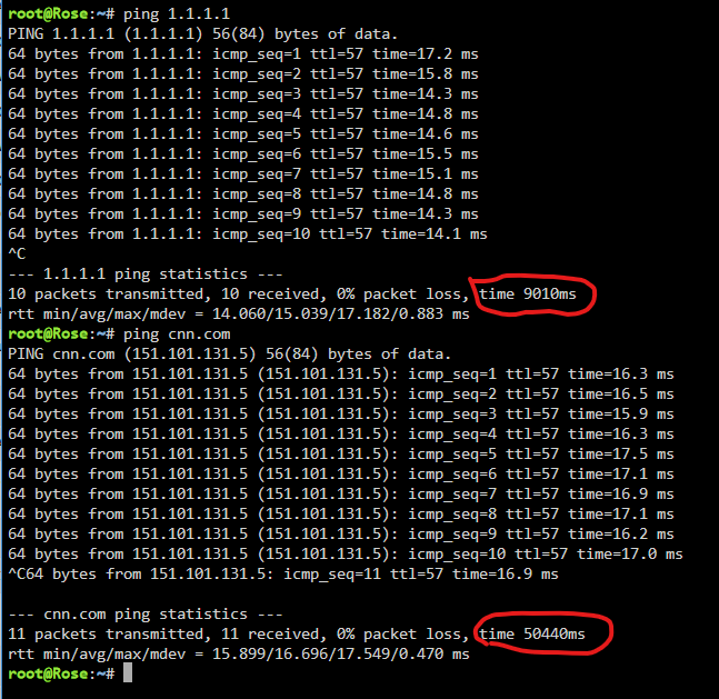

Example of Problem:
I never noticed it until the OP posted up his first query and I tested it.  It is not a problem for me as my use profile is strictly as a NAS.  So any DNS queries are minimal and the next time is inconsequential.

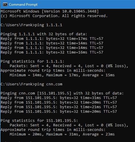

Here is the ping response from my Windows PC for comparsion:
