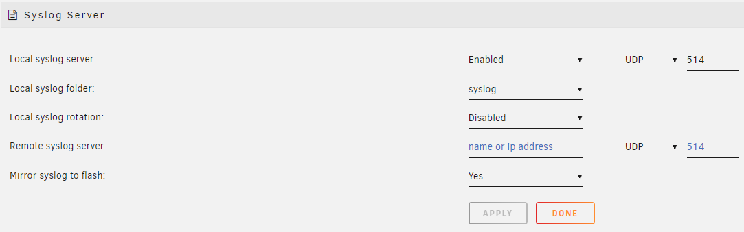

The syslog in the diags is incomplete, enable the syslog server and post that after a crash.
Thank you for that hint. Didn't know that unraid supports syslog for a while now - well I don't read the patch notes.
I configured it like so - I hope its correct:
Afterwards I restarted the server and unfortunately it crashed immediately after few seconds. I got this behaviour for like 4-5 times.
After a short break, the restart finally worked and I was able to access the server again for a while.

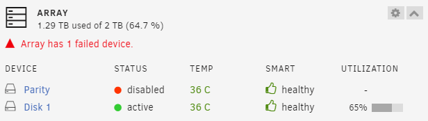

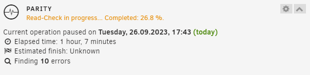

    • And after approx. 1 hour and 6 Minutes Parity Check: Parity Disk failure - finally I got something meaningful that started to make sense.
    • The Parity Check paused because Unraid stopped the Parity Disk
    • Then I tried out what happens, when I resume the Parity Check -> crash
  • After reboot the Parity Disk is still disabled by Unraid now

    • I started a self test on the disabled disk -> strangely Unraids result says everything is fine
So I guess its clear, that one disk is not working properly. Now I need an advice what to do. My plan is now to shut down the server until I have new disks. I have no parity anymore and I don't want to risk something.

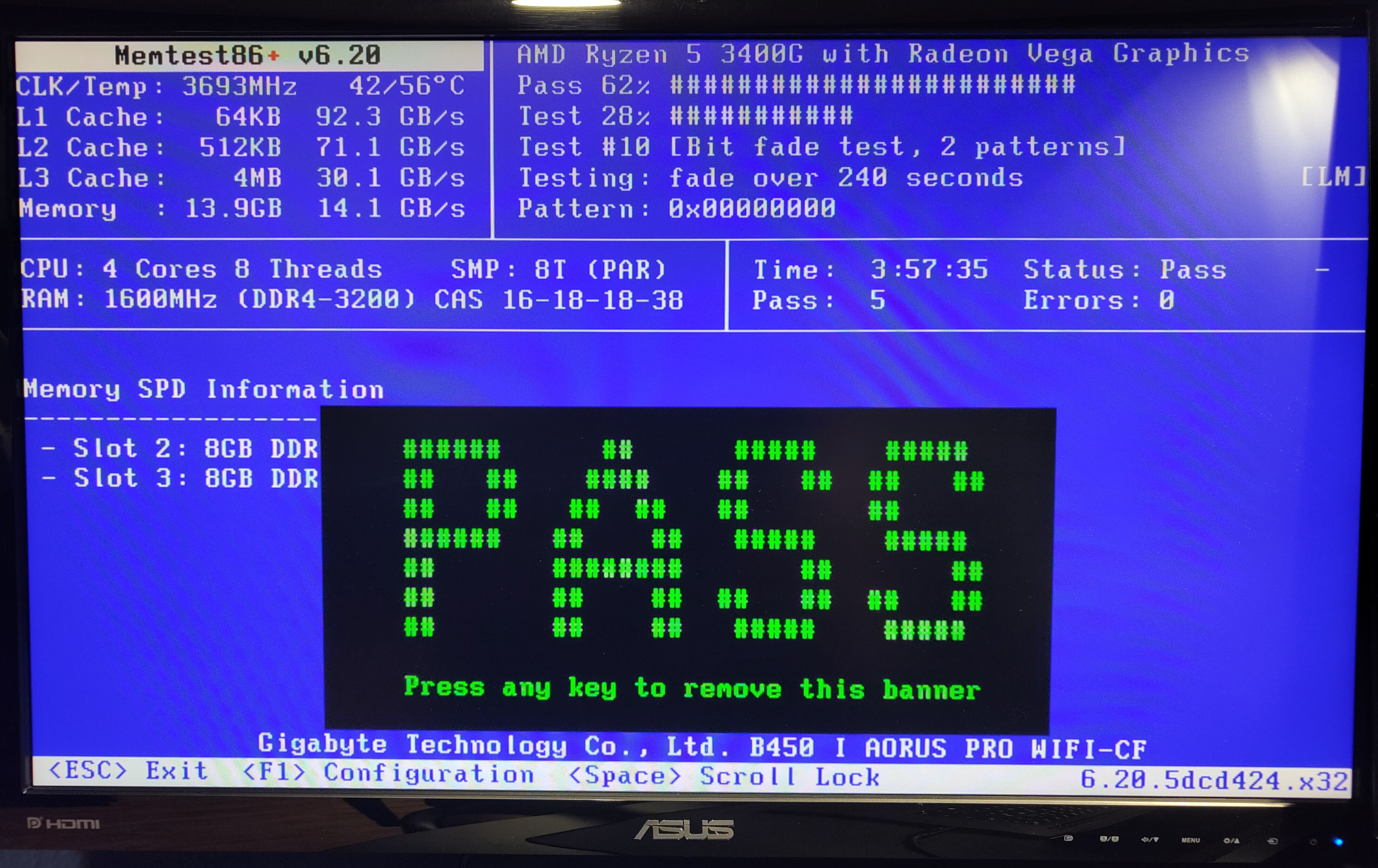

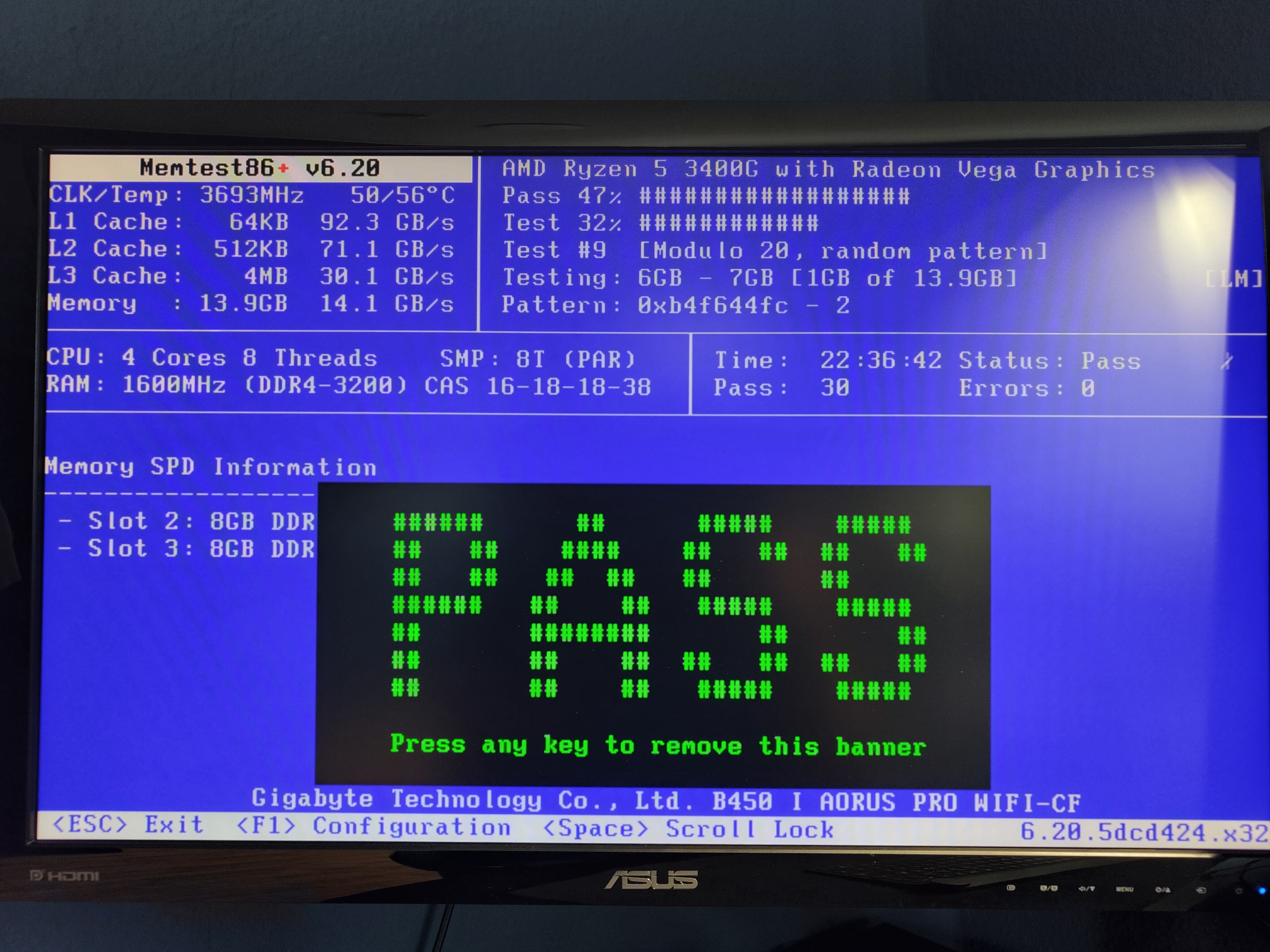

I installed the newest version of memtest86+ on a usb stick and its running now for few hours.
Until now it got no errors. As far as I read on the internet, there is at least a recommended memtest time for at least 24h. But I guess that the ram sticks are fine, idk. I think I will leave it running until tomorrow when I get back from work.

I ran the memtest86+ for 22,5 hours. Memory looks pretty fine I think.

  • RAM might be fine ---> checked with memtest86+ (passed 30 times)
This is the one that is not always conclusive.   A failure definitely means you  have a problem, whereas a pass is merely indicative.
Having said that it is a good resource - I may make a note of it for suggesting it be used in the future for those experiencing potential hardware problems.
