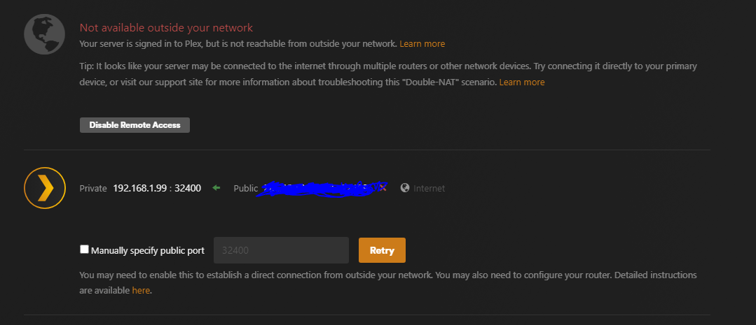

I had remote access working fine for years but all of a sudden i was noticing that my remote streams were limited to 2mbps and it looked like it was going through the Plex Relay and my server wasn't reachable remotely.

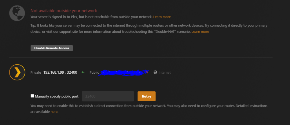

I have upnp enabled in my asus router but it still doesn't seem to work.  I tried setting up a port forwarding (external & internal ports set to 32400 and internal ip 192.168.1.99) and selected the Manually Specified Public Port in plex, but it still doesn't work.
Anyone have any ideas?  I haven't changed anything network related for years, so i dont think its a double NAT issue, but i dont completely understand it.
Edit: i had a remote stream going and it was playing indirect
The only think i have changed recently is installed jellyfin, so i deleted the docker and when i checked back on Remote Access in plex it was all green, but now its back to red.
Edit2:
This is bizarre.  I have a vpn setup through built in wireguard.  I have Sabnzbd setup to go through the vpn (i use ssl but cant be too safe) but plex is on Host mode.  I went and dissabled the vpn on wireguard and BAM!  All green and running a remote test it all working fine.
How the hell did that affect my plex?
