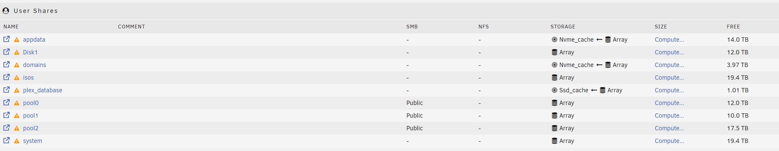

question on cache drives and mover
If I want something to primarily run on the cache drive I have it set as primary and then I have the HDD as the secondary.
Do I have this setup correctly or should the mover go the other direction?
I'm thinking this config nothing would get put in the HDD unless the cache drive fills is that correct? So you have no backup of the cache?
I guess my intuition says I want things to primarily run in the cache but write-through to the HDD at some point (whether that's hourly or daily).
The way it's set the mover will move the data from array to cache.

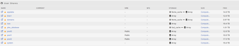

Is there a way to write-through to HDD say once daily but still operate out of the Cache?
Do I just set the mover the other direction? But if it moves the data then does it no longer operate out of the cache?
Edited by xokia
Yes.
Correct
