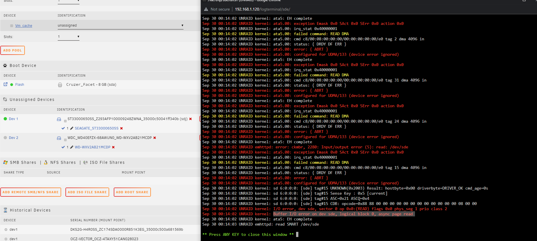

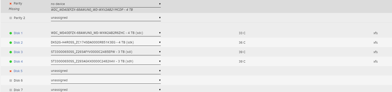

September 29, 20233 yr Author Currently trying to complete the clone using ddrescue. My array is is stopped and all the disks are unmounted so I can clone disk 3 to another disk of the same size. However, while doing so my parity drive (which was fine when I restarted unRAID and first stopped the array) suddenly dropped out of the array, now shows a "missing disk" in the parity spot and the parity drive is in unassigned devices, unable to be assigned to the array and having a heap of read errors. Meanwhile the new disk I am attempting to clone Disk3 too is dropping in and out of the unassigned devices. I could accept bad luck with two drives (which are older), but surely the parity drive (which is near new) hasn't given up the ghost too? unraid-diagnostics-20230929-2359.zip Edited September 29, 20233 yr by rts.empire
September 29, 20233 yr Community Expert That looks more like a power/connection issue, do you have another PSU you could use?
September 29, 20233 yr Author I'll have to borrow the one from my desktop tomorrow and see how that goes.
