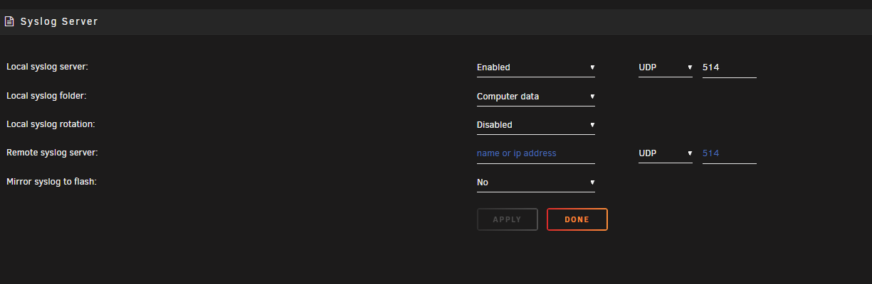

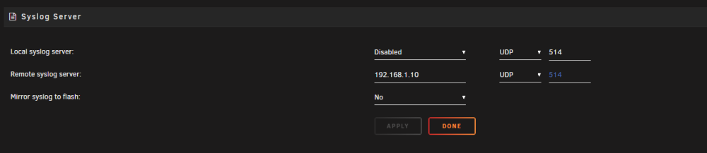

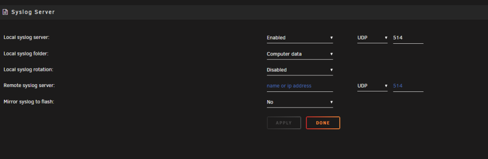

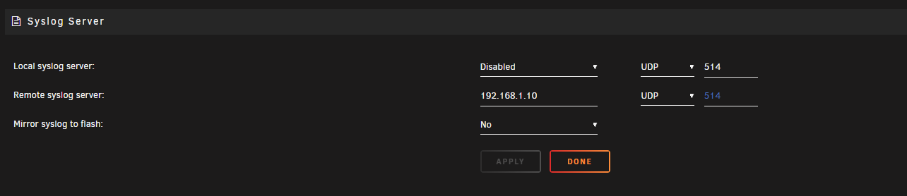

I think I had this all setup wrong the whole time...Is this how I need to set this up?
The first pic is the machine I am trying to get the data from.
This is the machine I am trying to get to record the data....I had it setup completely different before, but after reading around...I think this is right now?
or do I need it on for "local syslog server" on the machine im trying to get the data from as well?
You need to set the remote syslog server IP, use the local server IP, or just enable the mirror to flash drive option.
