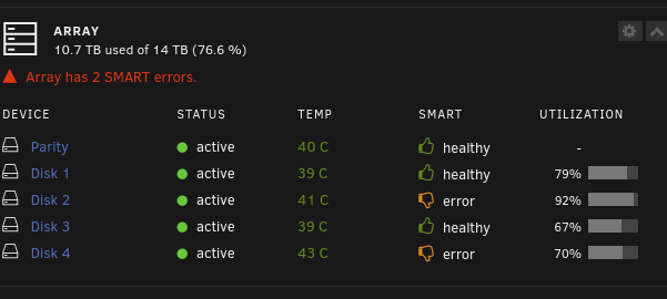

Disk spewing errors, performance tanking. Advice?
image.thumb.png.c150280db1e3d52fdd402ae023a96f51.pngimage.png.f401f1677bc46982ee111ef11703e191.png

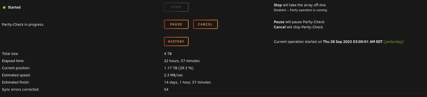

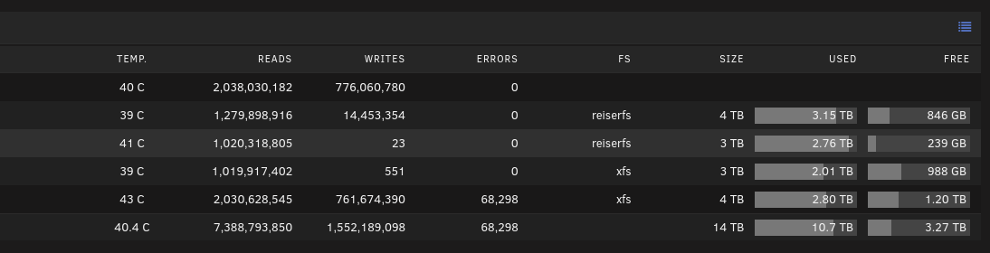

It looks like I should replace Disk 4 which has terrible performance and is barely able to read data from (though, I can.. I did manage to copy a few files off it to test). Disk 2 seems fine from a performance standpoint. unRAID has not marked Disk 4 as bad. However, the syslog has a ton of sector read errors. It has to be replaced, clearly.
How should I proceed? Should I manually remove this disk from the array and let parity take over? The disk is not marked as bad. Can I buy a couple 8TB disks to take over? This should give me a bit more room and get some of the ageing disks out of the array. Or should I shut it down and replace them then?
I have a full backup at home on another machine, so there is no concern there. But it would be nice to avoid needing to copy all 14TB back over gigabit slowly :)
Edited by sincero
Solved by JorgeB
Disk4 has a lot of reallocated sectors, and the errors are logged as a disk problem, probably should just replace it now, but you can also run an extended SMART test to confirm, disk2 should also be replaced when possible, since it has a failing now SMART attribute, though one that usually doesn't cause read errors.
It is also worth pointing out that disk1 and disk2 are still using reiserfs which is now deprecated.    Maybe now is the time to consider getting these converted to one of the other file system types supported by Unraid.
 Thanks! So if I understand correctly, I can proceed with a parity swap once I order a new disk?
