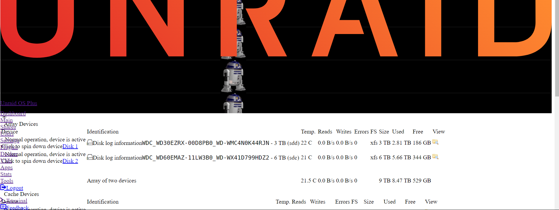

I had Nextcloud, mariadb and swag installed on my system and then got stuck around 12:40 minutes in the video, where he opens up the terminal and types in the command. I tried to do the same, but it wouldn't work for me (I don't remember the exact error I got in the terminal) So I just left the window open and figured I would somehow solve the issue a bit later. On the same day I tried to acces Jellyfin from my TV, which didn't work anymore. It said, it couldn't reach the server. So I went back to the unraid webui, which suddenly looked really wrong. Just like this picture from another thread:
