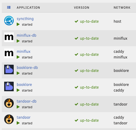

March 13Mar 13 I really hope that this will be part of the UI one day, instead of having to manage the extra networks in the "Post Arguments".The UI already supports showing the multiple networks, so it is a recognized thing, but just not manageable in the UI.
