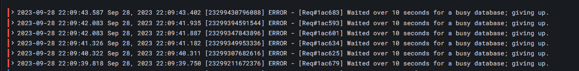

I am experiencing an issue with Plex that I have tried a few things to get around but so far no luck. Plex is becoming 100% unresponsive and requires a bounce. When this happens it spits out these logs:
It seems to happen while Plex Meta Manager is applying new overlays and something triggers a scan. They recommended I boost the "Database Cache Size (MB)" which I set to 16 GB

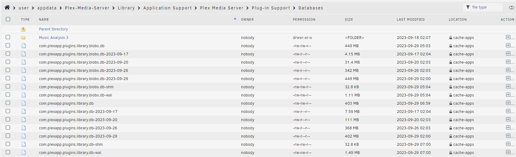

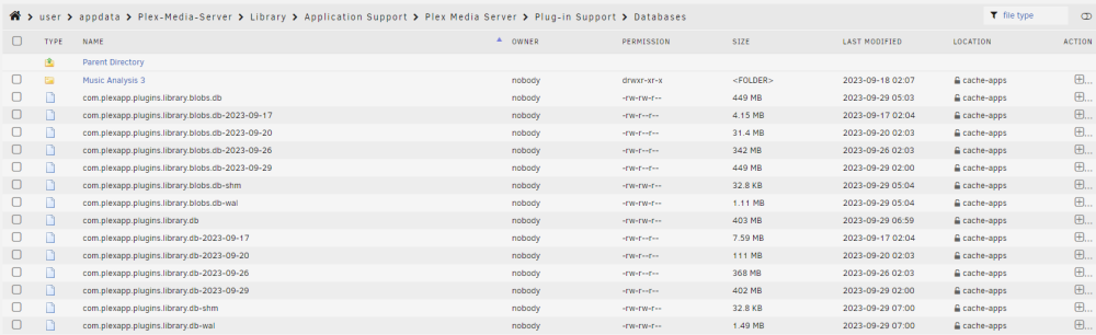

I also read on here that it was faster to point Plex right at the cache than at the user share so I tried that:
All of my DB files are on a Raid 1 2x2TB Crucial P3 Plus NVME SSD which is specced for 5000 MB/s read, 4200 MB/s write. I read I could move them to a RAM disk but that seems like a bad idea as the author of the guide for that had no plans for unexpected shutdowns and everything would be lost.
