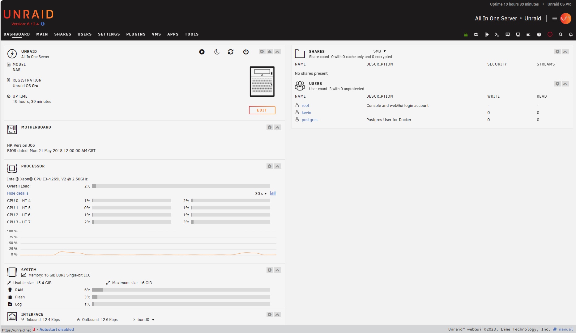

Hi guys, yesterday my unraid server's CPU is very high. When I check, I found dmesg used 99% CPU. I don't know why?
I try to reboot and shutdown -r now in terninal, but system can't response.
I have try run echo "b" > /proc/sysrq-trigger to force system reboot.
I lost docker menu when system reboot.
Unraid version is 6.12.4.
How I can recover docker menu?

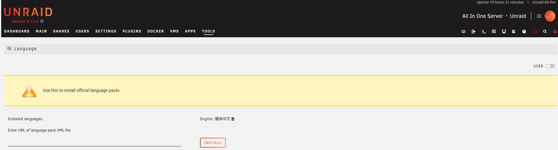

Hi guru, docker appear again when I enabled docker service. But switch language doesn't work any more.
I reinstall language package, the same issue exist.

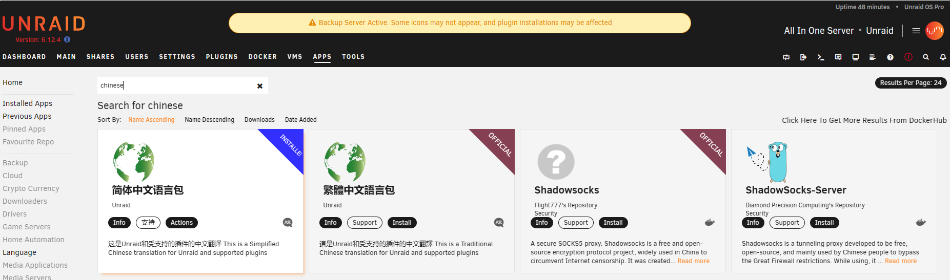

How are you reinstalling the language?  IIRC what you are seeing can happen if Chinese wasn't up to date (issue with one of the language releases).  You want to update Chinese via Apps, Installed Apps
I installed chinese language pack from Apps. But switch language doesn't work any more when I re-enable docker service again. Before that, switch language have worked fine.

Hi guys, I track web source code.
switch language actually use /usr/loca/emhttp/webGui/include/LanguageReset.php which read /boot/config/plugins/dynamix/dynamix.cfg and search locale variable.
I don't know why system can't set locale variable even if I reinstall language pack.  I have to set it manually to "zh_CN".
Every thing is OK.

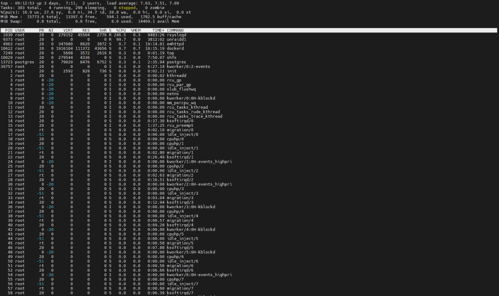

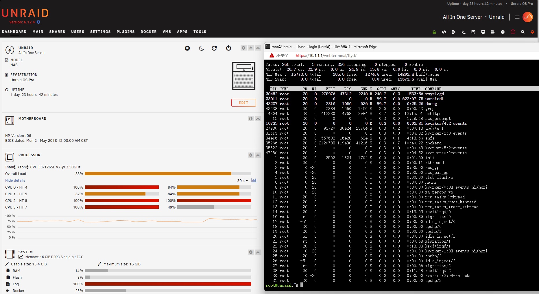

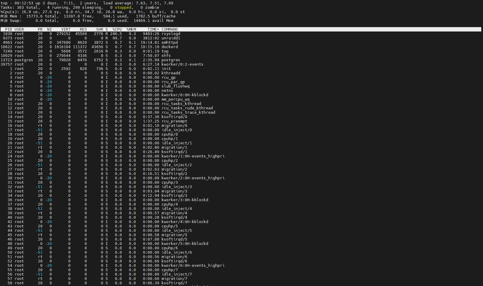

Hi Squid, I tried to shutdown my server and remove the one flash driver as your instruction.  But I found I can't access web which prompt http 500 error.  I have to login via ssh.
I found CPU reached 100% again.
Can I can diags from command.  BTW,  shutdown doesn't work any more.
I have never force cold reboot because I am afraid this situation disappear after reboot and I have to wait for a few days until CPU become high again.
