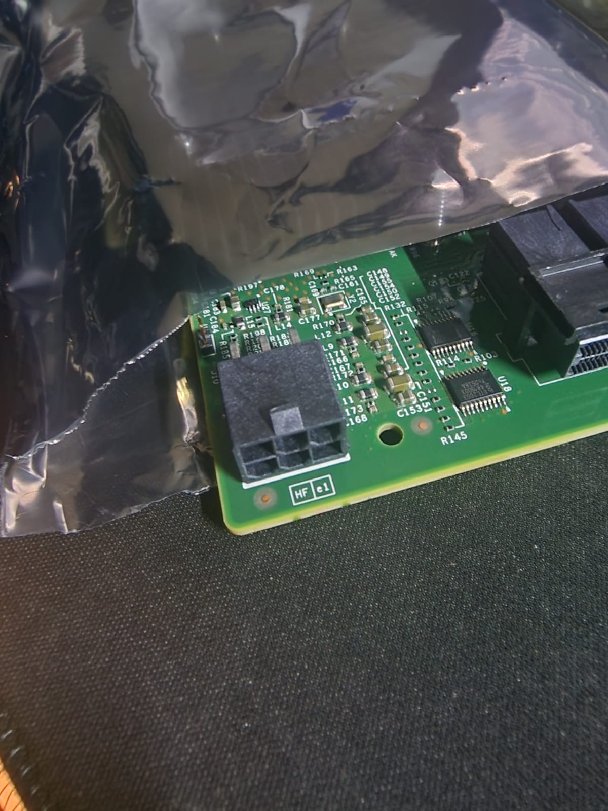

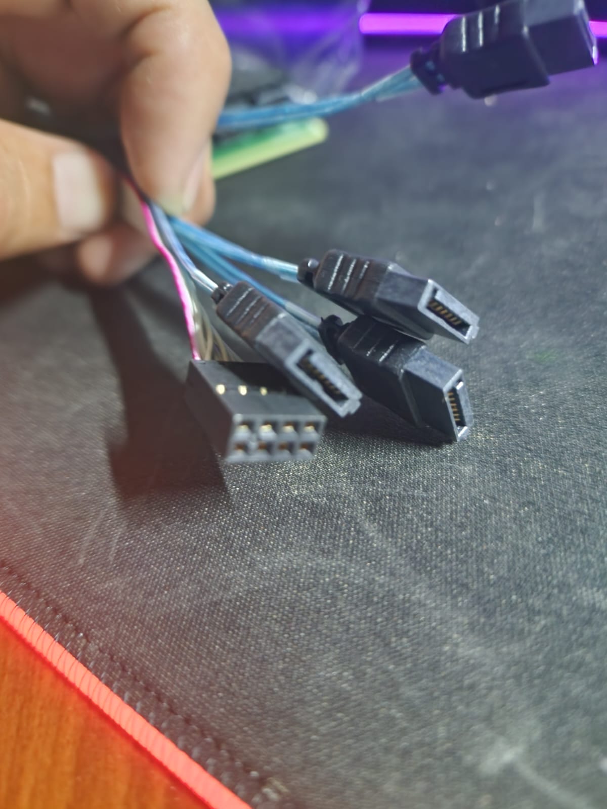

Just got the new card but was wondering about one of the plugs on the cables and one on the card. what are these for?
