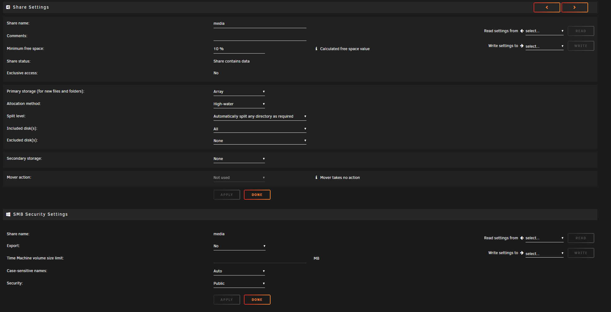

My problem, as stated in the title is pretty self explanatory, as my media share fills up, its ONLY putting data on disk1 (the 8tb drive), now I assumed based on the "highwater" setting that it probably wouldn't start to fill up disk2 (the 4tb) until the 8tb drive was about halfway full.

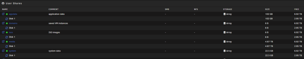

But at this point, disk1 is a little over 5tb out of 8 filled up, and nothing is spilling over into disk2, so I'm starting to get concerned why it doesn't seem to be including disk 2 in the share, like I originally (or so i thought) set it up to do.

That is expected behaviour.    The potential cutover points are based on the size of the largest data drive.   Since you say this is 8GB the first cutover point will occur when disk1 has 4TB left.    Since at this point no drive has more than 4TB free then disk1 will continue to be used until it has 2TB free.    It as that point you should expect disk2 to be used until it is down to 2TB free, etc
This is described in some detail here in the online documentation accessible via the ‘Manual’ link at the bottom of the GUI or the DOCS link at the top of each forum page.
