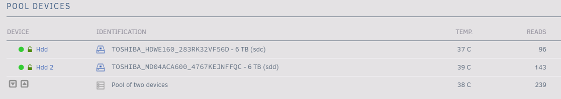

But now, I found some abnormal on safe-mode, the disk actually will self spinup because system reading it, so pls don't test under safe mode.
** edit : periodic reads in safe mode should only happen on POOL DEVICES **
