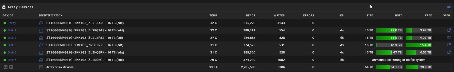

Hello,
I had a power failure this week end which my UPS took over and made a gracefull shutdown. I found out today that the drive was mounted read only with no disk access and once I shutdown the server, checked all connection and start it back, I was greeted with this:
Now, I don't know what happen to the disk. It had no smart error and was working fine. If I "reformat" the drive, will the array rebuild itself and put the data back?
At the sametime, a parity check started yesterday (parity ran each 1st of the month). Could that lead to problem (I cancelled the parity check)? I installed a new drive about 2 weeks ago so I know the parity should be good.
Thank you

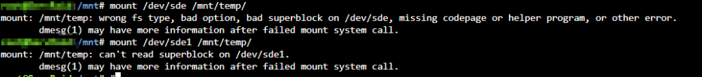

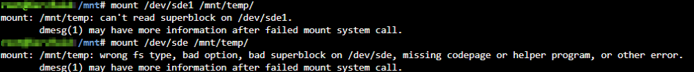

I tried manual mount in a temp folder, greeted with these error

tried mounting
Ok, this is the output. Do I manually mount or start the array not in maintenance mode?
