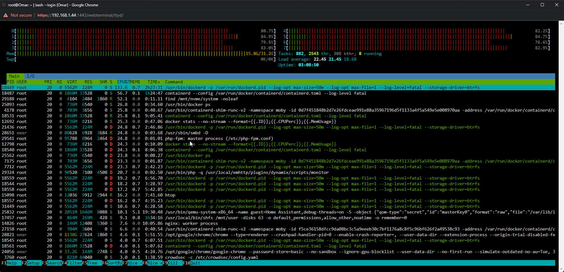

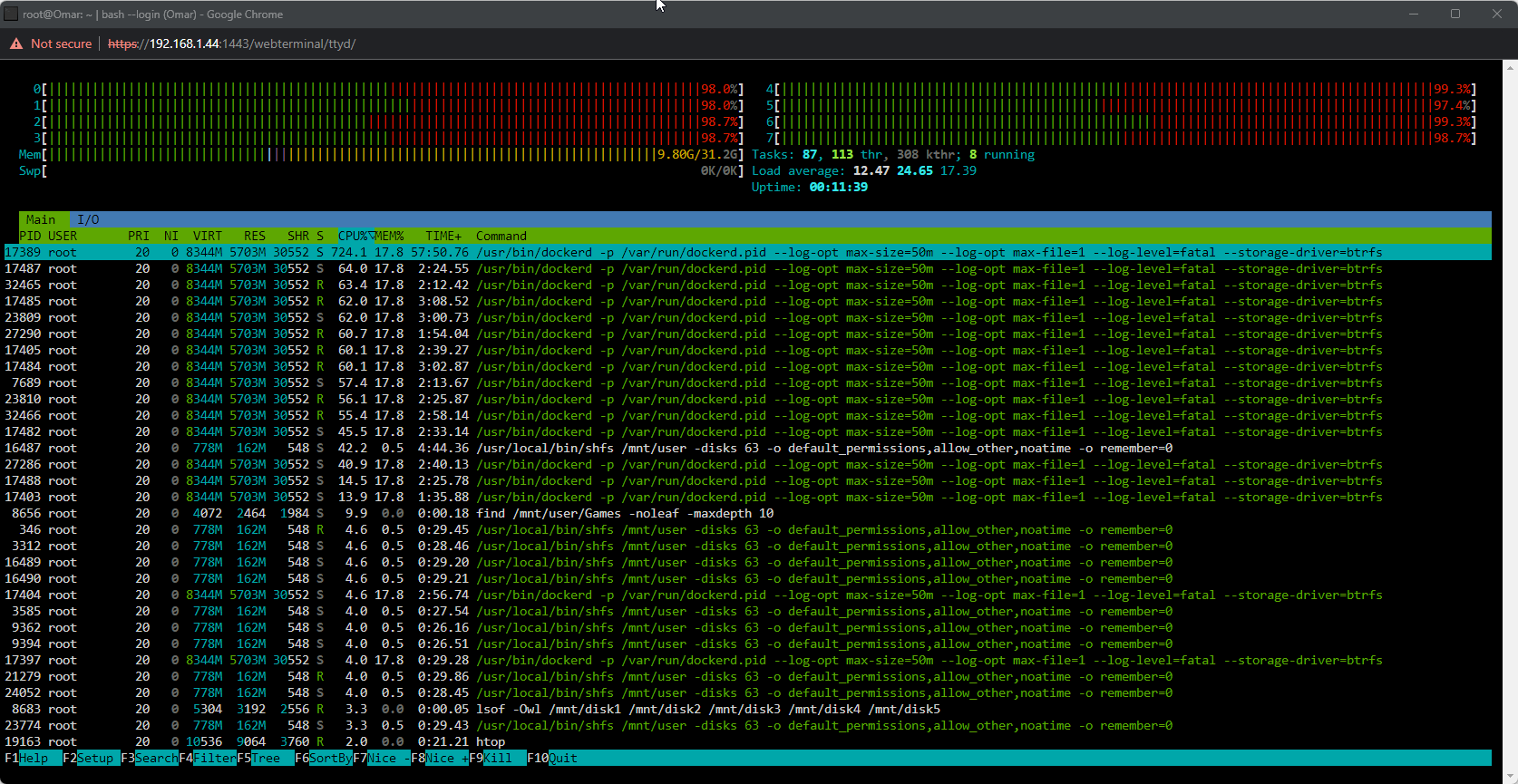

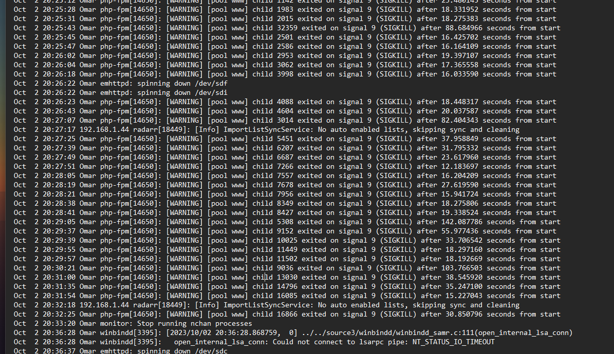

October 2, 20233 yr Hi, I've been having an issue with unraid freezing up, and have been working on tracing it but cannot seem to find an issue. This last time, I was looking at HTOP and noticed very high CPU usage across the board, and checked syslog with a bunch of php-fpm errors. Screenshots and diagnosis attached. Would appreciate any thoughts / help, thanks! Unraid version 6.12.4 omar-diagnostics-20231002-2055.zip Edited October 14, 20233 yr by bucketphobia

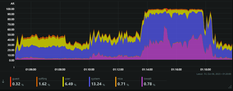

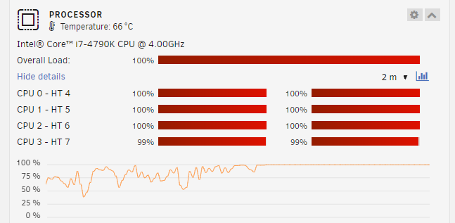

October 5, 20233 yr Author Another thing I noticed - is if the dashboard is open on a tab, system load and iowait goes up, but seems to go down to normal-ish after it is closed. Scratch that, went back to very high CPU usage a short while. (Initial Graph) (10-ish mins later) Edited October 5, 20233 yr by bucketphobia

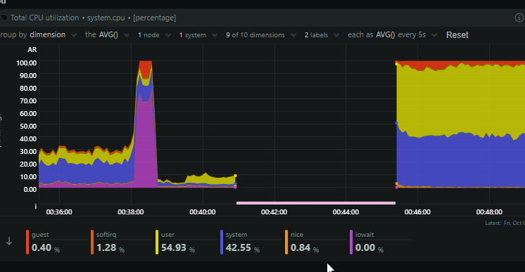

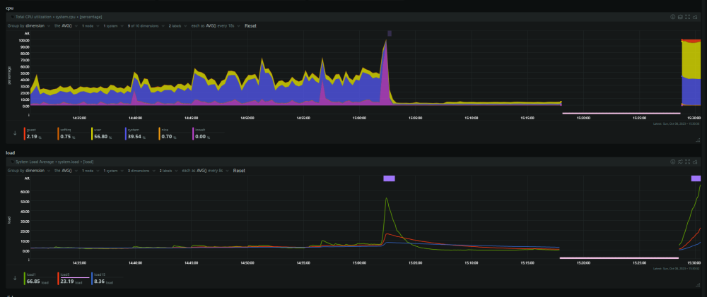

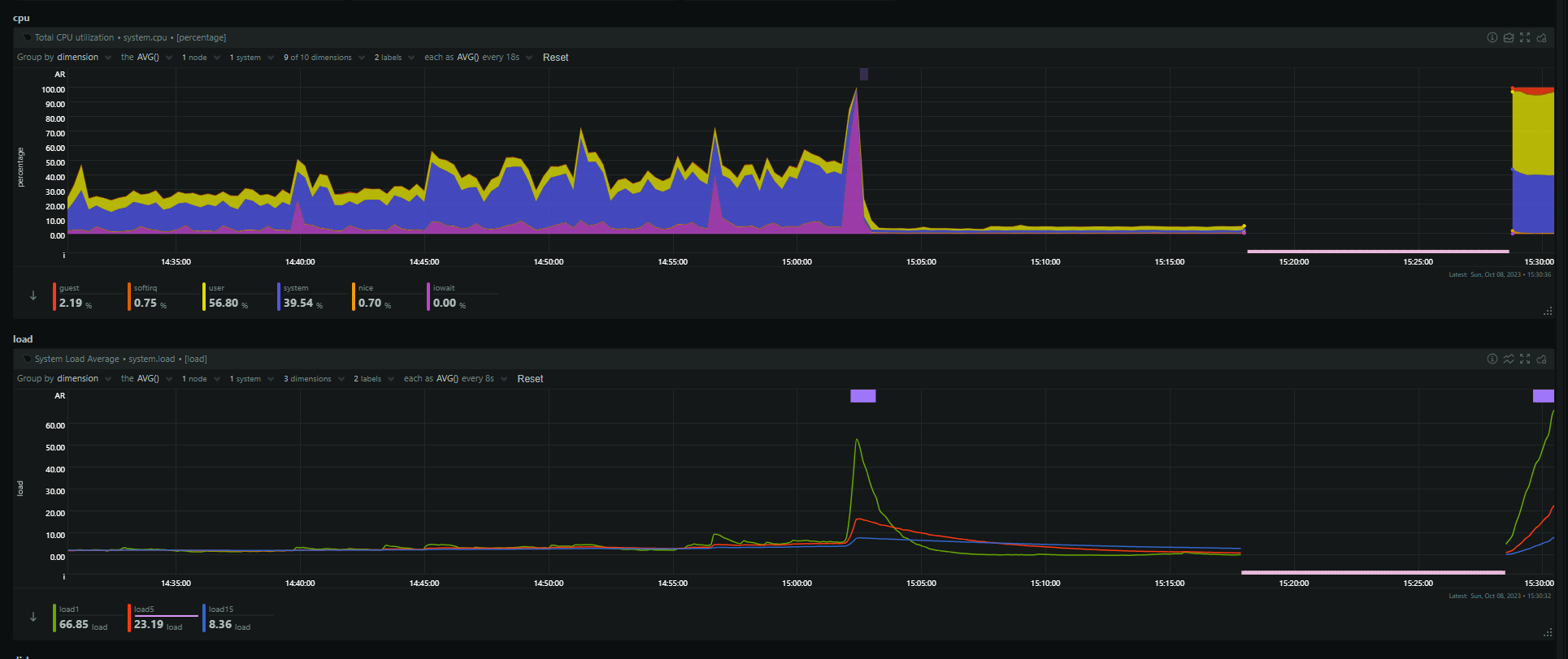

October 8, 20233 yr Author To rule out any issue with docker containers - ran the server with all containers stopped, and issue still persisted with a server crash. I guess it's an issue with the docker service itself. Any idea on potential fixes? Netdata: After the spike in iowait, server goes down and is unresponsive unless manually hard restarted. Stats across the board also drop (i.e., disk io, network, RAM, etc....) Syslog right before this latest crash: Oct 8 15:01:50 Omar usbhid-ups[5576]: nut_libusb_get_report: Input/Output Error Oct 8 15:01:52 Omar usbhid-ups[5576]: device->Product is NULL so it is not possible to determine whether to activate max_report_size workaround Oct 8 15:01:52 Omar usbhid-ups[5576]: libusb1: Could not open any HID devices: insufficient permissions on everything Oct 8 15:01:52 Omar upsd[5580]: Data for UPS [ups] is stale - check driver Oct 8 15:01:54 Omar usbhid-ups[5576]: device->Product is NULL so it is not possible to determine whether to activate max_report_size workaround Oct 8 15:01:56 Omar upsmon[5584]: Poll UPS [[email protected]] failed - Data stale Oct 8 15:01:56 Omar upsmon[5584]: Communications with UPS [email protected] lost Oct 8 15:01:58 Omar usbhid-ups[5576]: libusb1: Could not open any HID devices: insufficient permissions on everything Oct 8 15:01:58 Omar usbhid-ups[5576]: device->Product is NULL so it is not possible to determine whether to activate max_report_size workaround Oct 8 15:01:59 Omar usbhid-ups[5576]: libusb1: Could not open any HID devices: insufficient permissions on everything Oct 8 15:02:00 Omar usbhid-ups[5576]: device->Product is NULL so it is not possible to determine whether to activate max_report_size workaround Oct 8 15:02:01 Omar usbhid-ups[5576]: libusb1: Could not open any HID devices: insufficient permissions on everything Oct 8 15:02:01 Omar upsmon[5584]: Poll UPS [[email protected]] failed - Data stale Oct 8 15:02:02 Omar usbhid-ups[5576]: device->Product is NULL so it is not possible to determine whether to activate max_report_size workaround Oct 8 15:02:03 Omar usbhid-ups[5576]: libusb1: Could not open any HID devices: insufficient permissions on everything Oct 8 15:02:04 Omar usbhid-ups[5576]: device->Product is NULL so it is not possible to determine whether to activate max_report_size workaround Oct 8 15:02:05 Omar usbhid-ups[5576]: libusb1: Could not open any HID devices: insufficient permissions on everything Oct 8 15:02:06 Omar upsmon[5584]: Poll UPS [[email protected]] failed - Data stale Oct 8 15:02:06 Omar usbhid-ups[5576]: device->Product is NULL so it is not possible to determine whether to activate max_report_size workaround Oct 8 15:02:07 Omar usbhid-ups[5576]: libusb1: Could not open any HID devices: insufficient permissions on everything Oct 8 15:02:08 Omar usbhid-ups[5576]: device->Product is NULL so it is not possible to determine whether to activate max_report_size workaround Oct 8 15:02:09 Omar usbhid-ups[5576]: libusb1: Could not open any HID devices: insufficient permissions on everything Oct 8 15:02:10 Omar usbhid-ups[5576]: device->Product is NULL so it is not possible to determine whether to activate max_report_size workaround Oct 8 15:02:11 Omar usbhid-ups[5576]: libusb1: Could not open any HID devices: insufficient permissions on everything Oct 8 15:02:11 Omar upsmon[5584]: Poll UPS [[email protected]] failed - Data stale Oct 8 15:02:12 Omar usbhid-ups[5576]: device->Product is NULL so it is not possible to determine whether to activate max_report_size workaround Oct 8 15:02:13 Omar usbhid-ups[5576]: libusb1: Could not open any HID devices: insufficient permissions on everything Oct 8 15:02:15 Omar usbhid-ups[5576]: device->Product is NULL so it is not possible to determine whether to activate max_report_size workaround Oct 8 15:02:15 Omar usbhid-ups[5576]: libusb1: Could not open any HID devices: insufficient permissions on everything Oct 8 15:02:16 Omar upsmon[5584]: Poll UPS [[email protected]] failed - Data stale Oct 8 15:02:17 Omar usbhid-ups[5576]: device->Product is NULL so it is not possible to determine whether to activate max_report_size workaround Oct 8 15:02:17 Omar usbhid-ups[5576]: libusb1: Could not open any HID devices: insufficient permissions on everything Oct 8 15:02:19 Omar usbhid-ups[5576]: device->Product is NULL so it is not possible to determine whether to activate max_report_size workaround Oct 8 15:02:19 Omar usbhid-ups[5576]: libusb1: Could not open any HID devices: insufficient permissions on everything Oct 8 15:02:21 Omar usbhid-ups[5576]: device->Product is NULL so it is not possible to determine whether to activate max_report_size workaround Oct 8 15:02:21 Omar usbhid-ups[5576]: libusb1: Could not open any HID devices: insufficient permissions on everything Oct 8 15:02:21 Omar upsmon[5584]: Poll UPS [[email protected]] failed - Data stale Oct 8 15:02:23 Omar usbhid-ups[5576]: device->Product is NULL so it is not possible to determine whether to activate max_report_size workaround Oct 8 15:02:23 Omar usbhid-ups[5576]: libusb1: Could not open any HID devices: insufficient permissions on everything Oct 8 15:02:25 Omar usbhid-ups[5576]: device->Product is NULL so it is not possible to determine whether to activate max_report_size workaround

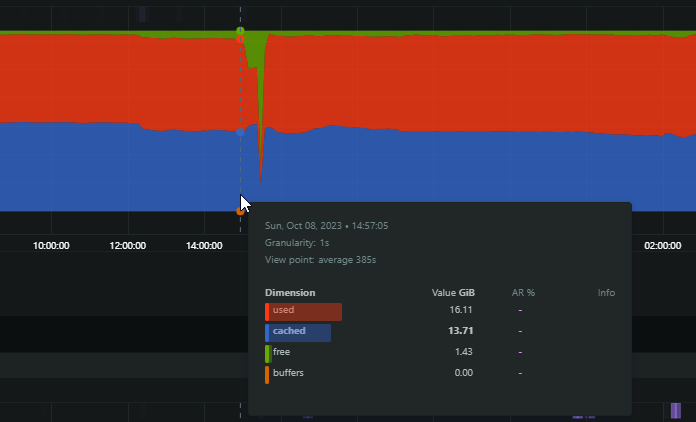

October 9, 20233 yr Community Expert Check the memory stats, does it get close to full memory use before crashing?
October 9, 20233 yr Author 4 hours ago, JorgeB said: Check the memory stats, does it get close to full memory use before crashing? It does not, RAM usage seems to be pretty stable.
