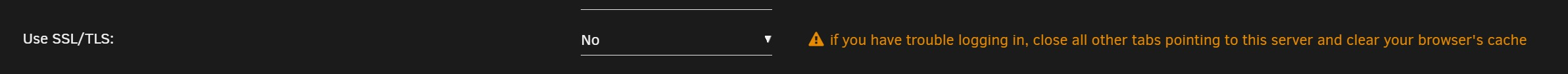

When you enable/disable SSL there is a warning in the webgui:
Basically, your browser is remembering that it used to use SSL for this url and it wants to keep using it. If you run into this, you need to close any other browser tabs that are pointed to the server and then clear your browser's cache. That should convince your browser to let you log in using the newly configured url.
Thanks, that solved the issue.
