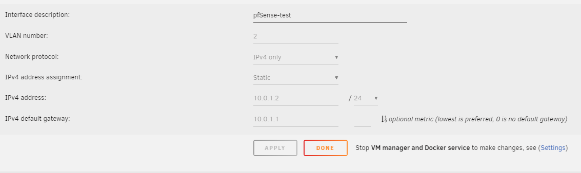

  1. create a vlan no 2 from br0 ---> br0.2, with ip 10.0.1.2/24 (my Unraid ip is 192.168.x.x)

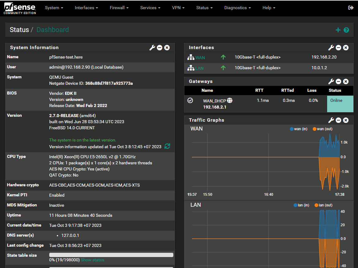

  2. create a pfSense VM on Unraid, by using vtnet0 as WAN interface and vtnet0.2 as LAN interface. The WAN address is 192.168.x.20

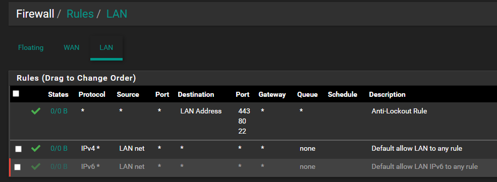

  3. create a LAN firewall rule to allow LAN net to access any ip/port
  4. create dhcp server for LAN interface as 10.0.1.1/24

  1. my desktop pc can't access pfSense test from my main LAN (on my production pfSense). I have to disable the test pfsense rule by command line pfctl -d
  2. the test pfsense can access internet by its builtin resolver (in pfsense console, can ping 8.8.8.8 or ping google.com)
  3. the debian vm can't access internet at at all. (Update: this has been solved by changing LAN interface ip from 10.0.1.2-->10.0.1.1)

  1. I don't know I did it all wrong or I can just set some more firewall rules on my test pfsense to allow internet access from my debian vm (Update: this has been solved. From pfSense webui, I change LAN interface ip from 10.0.1.2 to 10.0.1.1)
