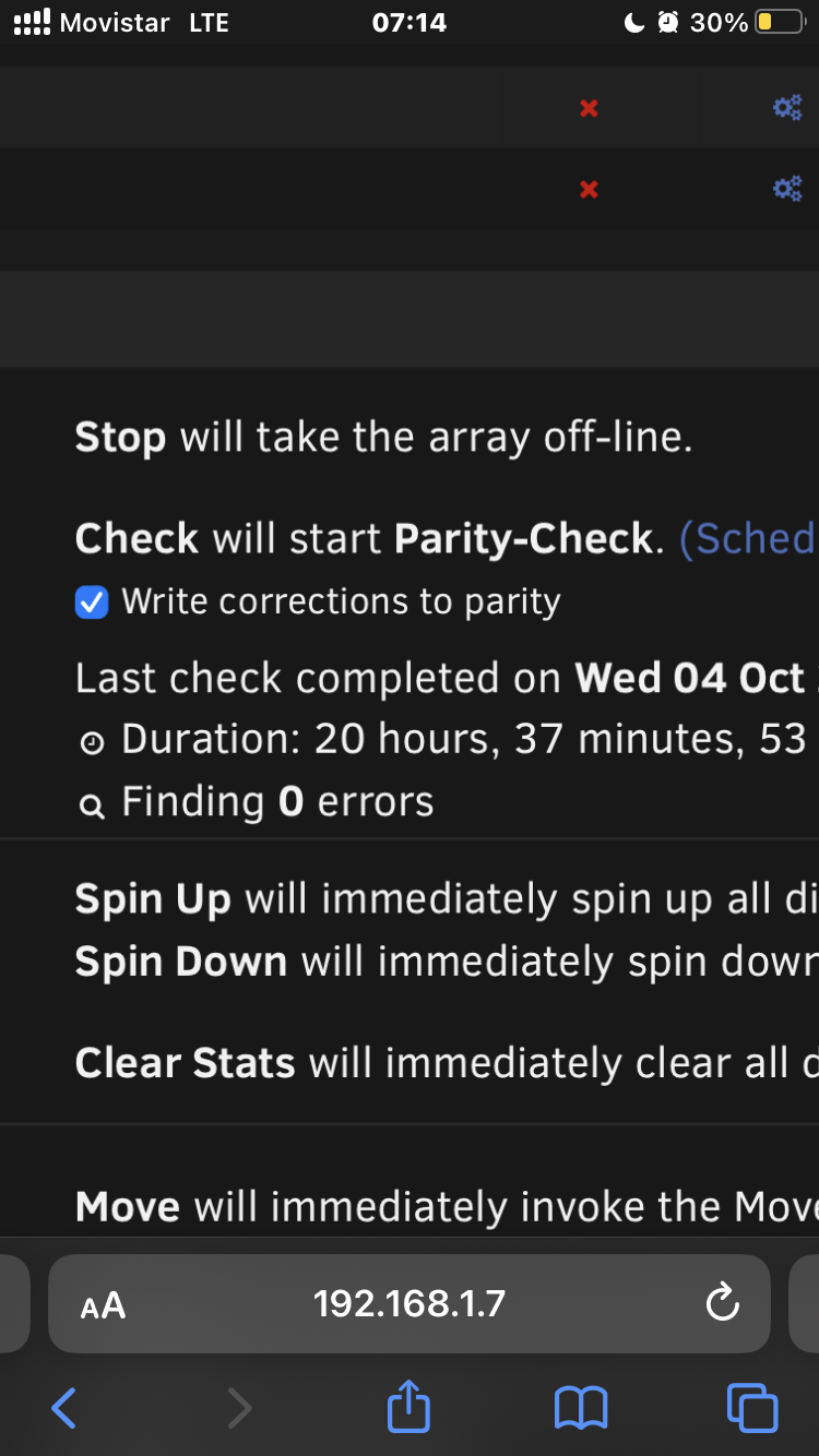

Third check and correct said 0 errors

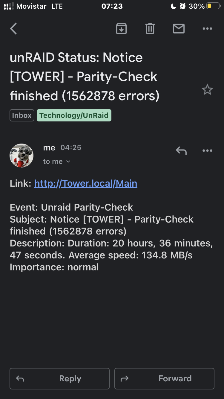

but strangely the email was a repeat of that last one - exactly.  Same over 1.5 million errors.
seems that email is stuck and sends the same thing.  That’s new.
added a scn shot of the parity status and the email that was sent.
That's a known issue.
