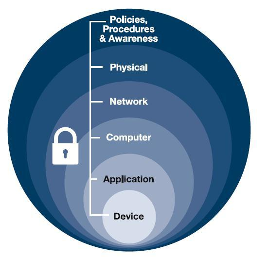

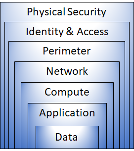

And I don't believe you're grasping the concept of defense in depth.  What the hell is "vulnerability and hardening in the host is also defense in depth."
Arrogance and ignorance are bad partners. So you talk about defense in depth and you mention 2 network security controls, IPS/IDS and traffic encryption. This is the youtube level knowledge of defense in depth. So basically you have 2 security controls in one of the layers of defense in depth. Can you call it defense in depth? well innacurate but yeah... I didn't complain about it the first time you wrote it, but then you were so arrogant to say that you know what defense in depth is and I had no idea.
So where it is configuration and vulnerability management in defense in depth, they are in the host/device/compute layer.
And configuration management (hardening) involves many things but basically is ensure the secure configuration of the assets. for example you can follow the recomandation of DISA, or CIS or whatever you preffer
Complete STIG List (stigviewer.com)
Red Hat Enterprise Linux 8 Security Technical Implementation Guide (stigviewer.com)  Sadly there is nothing for slackware becuase is not used by almost anyone but most of the controls are valid among different distros. In any case you have the same for ubuntu, debian, suse...
Bonus track, I'm sure you know how an IPS works, and that 90+% of the rules of the IPS are created to work with unencrypted traffic, so in order to have an effective IPS you need to do SSL offloading (traffic decryption) in you IPS, if not only a few basic rules will work and app detection based on SNI (which can be easily faked). The same happens with a WAF.
So if you want to use the IPS to be effective you have to deploy certs in unraid, dockers, vms, ideally deploying an internal PKI and configuring ssl offloading or traffic decryption in your FW (in case the IPS is there).
