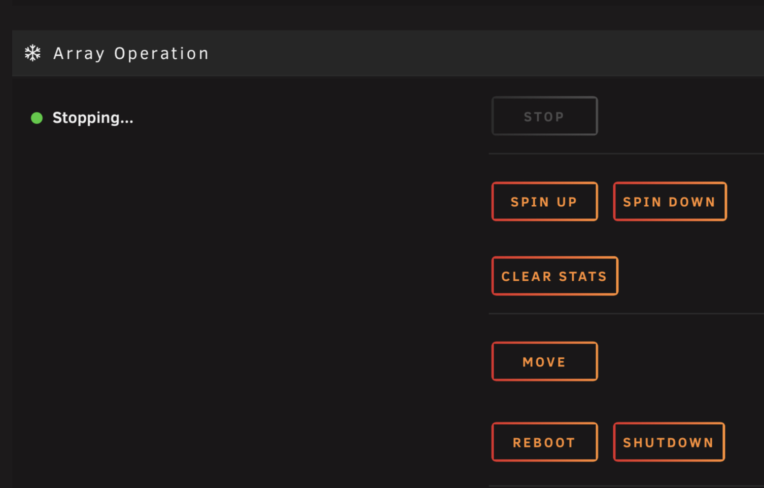

October 3, 20232 yr Author 27 minutes ago, Mainfrezzer said: Mhmm, that does seem odd and i couldnt find anything to indicate that something is "wrong". The only reason i could find is that it tried to attach to a network that didnt exist, still weird it started over cli But another question: Thats your only issue? Im surprised your server hasnt crashed yet since youre running a bridge with macvlan and have call traces. https://docs.unraid.net/unraid-os/release-notes/6.12.4/#fix-for-macvlan-call-traces The vm,start with consol vnc wotk but the stop button doesn’t work

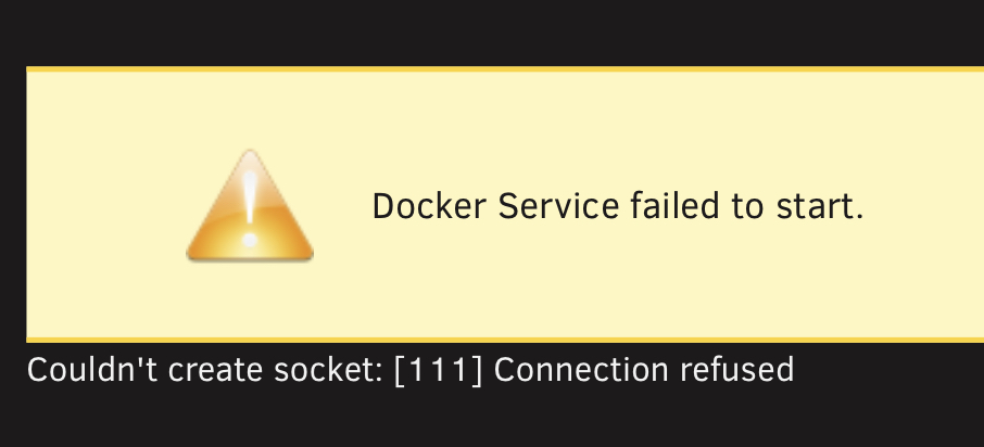

October 3, 20232 yr Author I need re re-create the docker vdisk ? If a do that i have to recreate all my containers? (I have more than 50...)
October 3, 20232 yr Community Expert 1 minute ago, JamesAdams said: If a do that i have to recreate all my containers? (I have more than 50...) Once a new image is created then you can tick them off under Apps->Previous Apps to get all the ones earlier installed via the Apps tab automatically reinstalled with the previously used settings.

October 3, 20232 yr Author but i still have a problem with the button for start the vm his doesn’t work and i have the same problem for the docker container
October 3, 20232 yr Author Solution The problem come from old plugin i uninstall few plugins and it’s work
