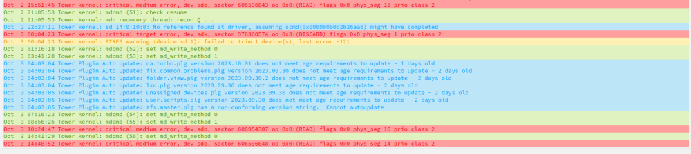

not really, no error/file  was listed after scrub start
That snippet does not appear to cover a scrub, start a new one and post new diags once it's done.

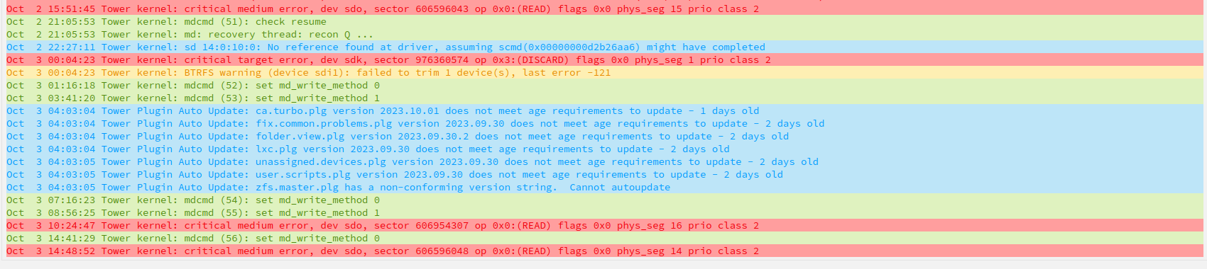

tower-syslog-20231006-0728.zip
Don't see any errors, the scrub result still shows errors?
