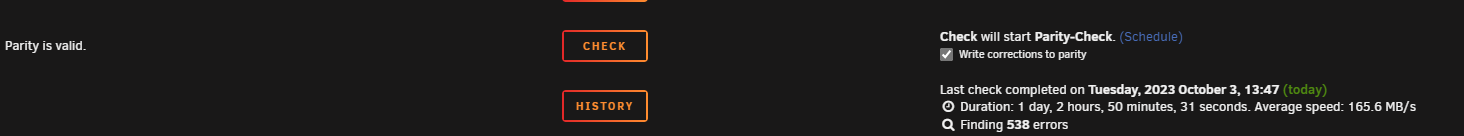

I had a file corruption on one of my disk yesterday. I finally have it fixed running xfs_check -L. After that, I start a parity check without the "write correction". It founded 538 errors. Is there a way to see these error? Is there a way to run the fix without running the entire parity check again?
Thank you
Running xfs_repair would not affect parity it done correctly, it would if ran on the sdX device.
Nope.
ok. So there's no way to know what are the 538 errors?
Nope, you should just correct parity.
