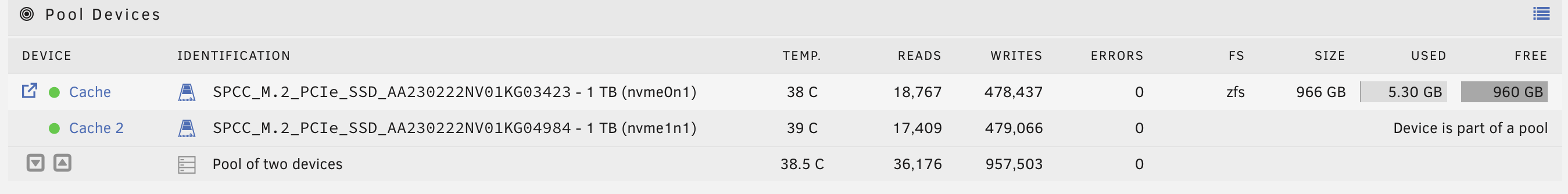

I am a new Unraid user who's experiencing the following problem.
A couple of days ago my Unraid NAS went unresponsive. I suspect there was a hw failure connected to my nvme0n1 configured as mirror drive of a zfs cache:
1825806409_Screenshot2023-10-03at20_32_00.thumb.png.1cd585ff16088feaf050563b77e45f29.png
When the error occured, I found in the system log the suggestion to add nvme_core.default_ps_max_latency_us=0 as a boot parameter. After updating the Syslinux Configuration accordingly, I rebooted the NAS. After a successful parity check, the NAS was ready and responsive as before.
Unfortunately inside the system log there are now some worrisome lines regarding BTRFS and device loop2 still my cache pool is zfs and my array is xfs!. These lines are repeated in a loop:

Oct  2 11:01:54 Valbotower emhttpd: /usr/sbin/zpool status -PL cache 2>&1
Oct  2 11:01:54 Valbotower emhttpd:   pool: cache
Oct  2 11:01:54 Valbotower emhttpd:  state: ONLINE
Oct  2 11:01:54 Valbotower emhttpd: status: One or more devices has experienced an unrecoverable error.  An
Oct  2 11:01:54 Valbotower emhttpd:  attempt was made to correct the error.  Applications are unaffected.
Oct  2 11:01:54 Valbotower emhttpd: action: Determine if the device needs to be replaced, and clear the errors
Oct  2 11:01:54 Valbotower emhttpd:  using 'zpool clear' or replace the device with 'zpool replace'.
Oct  2 11:01:54 Valbotower emhttpd:    see: https://openzfs.github.io/openzfs-docs/msg/ZFS-8000-9P
Oct  2 11:01:54 Valbotower emhttpd:   scan: resilvered 7.20M in 00:00:00 with 0 errors on Mon Oct  2 11:01:54 2023
Oct  2 11:01:54 Valbotower emhttpd: config:
Oct  2 11:01:54 Valbotower emhttpd:  NAME                STATE     READ WRITE CKSUM
Oct  2 11:01:54 Valbotower emhttpd:  cache               ONLINE       0     0     0
Oct  2 11:01:54 Valbotower emhttpd:    mirror-0          ONLINE       0     0     0
Oct  2 11:01:54 Valbotower emhttpd:      /dev/nvme0n1p1  ONLINE       0     0     0
Oct  2 11:01:54 Valbotower emhttpd:      /dev/nvme1n1p1  ONLINE       0     0     2
Oct  2 11:01:54 Valbotower emhttpd: errors: No known data errors

Oct  3 20:03:07 Valbotower kernel: btrfs_dev_stat_inc_and_print: 352 callbacks suppressed
Oct  3 20:03:07 Valbotower kernel: BTRFS error (device loop2): bdev /dev/loop2 errs: wr 594, rd 0, flush 0, corrupt 0, gen 0
Oct  3 20:03:07 Valbotower kernel: loop: Write error at byte offset 930349056, length 4096.
Oct  3 20:03:07 Valbotower kernel: I/O error, dev loop2, sector 1817088 op 0x1:(WRITE) flags 0x0 phys_seg 1 prio class 2
Oct  3 20:03:07 Valbotower kernel: BTRFS error (device loop2): bdev /dev/loop2 errs: wr 595, rd 0, flush 0, corrupt 0, gen 0
Oct  3 20:03:07 Valbotower kernel: loop: Write error at byte offset 932839424, length 4096.
Oct  3 20:03:07 Valbotower kernel: I/O error, dev loop2, sector 1821952 op 0x1:(WRITE) flags 0x0 phys_seg 1 prio class 2
Oct  3 20:03:07 Valbotower kernel: BTRFS error (device loop2): bdev /dev/loop2 errs: wr 596, rd 0, flush 0, corrupt 0, gen 0
Oct  3 20:03:07 Valbotower kernel: loop: Write error at byte offset 931659776, length 4096.
Oct  3 20:03:07 Valbotower kernel: I/O error, dev loop2, sector 1819648 op 0x1:(WRITE) flags 0x0 phys_seg 1 prio class 2
Oct  3 20:03:07 Valbotower kernel: BTRFS error (device loop2): bdev /dev/loop2 errs: wr 597, rd 0, flush 0, corrupt 0, gen 0
Oct  3 20:03:07 Valbotower kernel: loop: Write error at byte offset 932847616, length 4096.
Oct  3 20:03:07 Valbotower kernel: I/O error, dev loop2, sector 1821968 op 0x1:(WRITE) flags 0x0 phys_seg 1 prio class 2
Oct  3 20:03:07 Valbotower kernel: BTRFS error (device loop2): bdev /dev/loop2 errs: wr 598, rd 0, flush 0, corrupt 0, gen 0
Oct  3 20:03:07 Valbotower kernel: loop: Write error at byte offset 930365440, length 4096.
Oct  3 20:03:07 Valbotower kernel: I/O error, dev loop2, sector 1817120 op 0x1:(WRITE) flags 0x0 phys_seg 2 prio class 2
Oct  3 20:03:07 Valbotower kernel: BTRFS error (device loop2): bdev /dev/loop2 errs: wr 599, rd 0, flush 0, corrupt 0, gen 0
Oct  3 20:03:07 Valbotower kernel: loop: Write error at byte offset 932864000, length 4096.
Oct  3 20:03:07 Valbotower kernel: I/O error, dev loop2, sector 1822000 op 0x1:(WRITE) flags 0x0 phys_seg 1 prio class 2
Oct  3 20:03:07 Valbotower kernel: BTRFS error (device loop2): bdev /dev/loop2 errs: wr 600, rd 0, flush 0, corrupt 0, gen 0
Oct  3 20:03:07 Valbotower kernel: loop: Write error at byte offset 931704832, length 4096.
Oct  3 20:03:07 Valbotower kernel: I/O error, dev loop2, sector 1819736 op 0x1:(WRITE) flags 0x0 phys_seg 1 prio class 2
Oct  3 20:03:07 Valbotower kernel: BTRFS error (device loop2): bdev /dev/loop2 errs: wr 601, rd 0, flush 0, corrupt 0, gen 0
Oct  3 20:03:07 Valbotower kernel: loop: Write error at byte offset 933548032, length 4096.
Oct  3 20:03:07 Valbotower kernel: I/O error, dev loop2, sector 1823336 op 0x1:(WRITE) flags 0x0 phys_seg 2 prio class 2
Oct  3 20:03:07 Valbotower kernel: BTRFS error (device loop2): bdev /dev/loop2 errs: wr 602, rd 0, flush 0, corrupt 0, gen 0
Oct  3 20:03:07 Valbotower kernel: loop: Write error at byte offset 930398208, length 4096.
Oct  3 20:03:07 Valbotower kernel: I/O error, dev loop2, sector 1817184 op 0x1:(WRITE) flags 0x0 phys_seg 2 prio class 2
Oct  3 20:03:07 Valbotower kernel: BTRFS error (device loop2): bdev /dev/loop2 errs: wr 603, rd 0, flush 0, corrupt 0, gen 0
Oct  3 20:03:15 Valbotower kernel: veth013e42e: renamed from eth0
Please help me understand the cause of this error and if I need to replace the nvme disk.
I have also attached the diagnostics for further reference.
Thanks in advance!
unraid-diagnostics-20231003-2021.zip
loop2 is the docker image, you need to recreate it.
Also do a zpool clear and then scrub.
