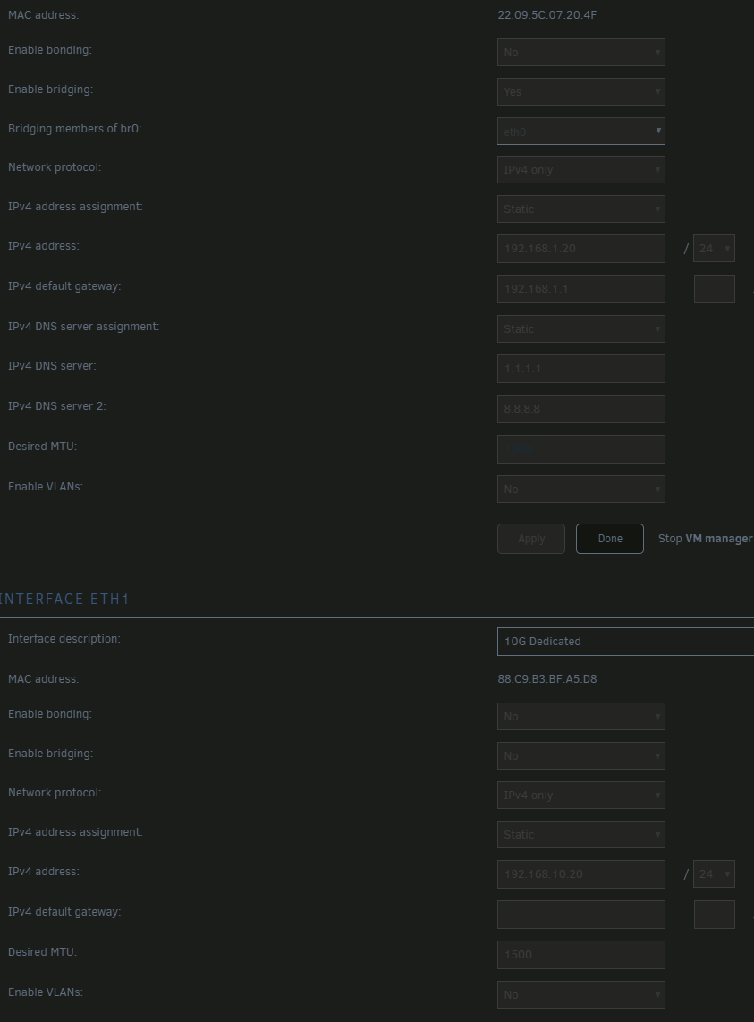

Both interfaces are using the default MTU of 1500.
At the other end, on my windows computer i also have jumbo packets disabled (10G NIC is a direct connection between the server and the workstation).

I dont have any MTU above the default 1500 and i updated everything.
