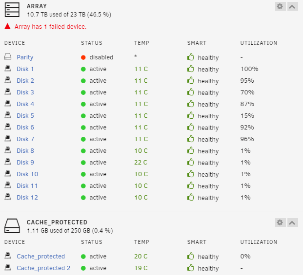

October 4, 20232 yr So... I've been away from home for a week and on return noticed that my 6.12.3 system is reporting the following and that the parity disk is offline. I've checked the logs and found (from my own novice checks) that the disk looks to have had a hardware error, is that right? Kind of annoying considering it's only about 2 months old and still under warranty. before I do any shutdown/reboots etc I just wanted to check with the experts what my next steps should be as I'm thinking I'll have to RMA the faulty disk and when a replacement arrives re-install and let the parity rebuild. Am I ok to carry on using the (unprotected) system in the meantime, it's only really a media server? Is it ok to stop the array, pull the faulty physical disk and restart, I could use a spare 1.92 SSD as a temp parity but I was under the impression that spinners were better than SSD's hence my reason for the 4Gb in the first place? Thanks in advance. Diagnostics attached. Sep 29 19:03:10 Borg kernel: hpsa 0000:03:00.0: scsi 1:0:8:0: resetting physical Direct-Access ATA ST4000LM024-2AN1 PHYS DRV SSDSmartPathCap- En- Exp=1 Sep 29 19:03:16 Borg kernel: hpsa 0000:03:00.0: invalid command: LUN:0000000000800701 CDB:01030000000000000000000000000000 Sep 29 19:03:16 Borg kernel: hpsa 0000:03:00.0: probably means device no longer present Sep 29 19:03:16 Borg kernel: hpsa 0000:03:00.0: scsi 1:0:8:0: reset physical failed Direct-Access ATA ST4000LM024-2AN1 PHYS DRV SSDSmartPathCap- En- Exp=1 Sep 29 19:03:16 Borg kernel: sd 1:0:8:0: Device offlined - not ready after error recovery ### [PREVIOUS LINE REPEATED 2 TIMES] ### Sep 29 19:03:16 Borg kernel: sd 1:0:8:0: [sdi] tag#883 UNKNOWN(0x2003) Result: hostbyte=0x05 driverbyte=DRIVER_OK cmd_age=65s Sep 29 19:03:16 Borg kernel: sd 1:0:8:0: [sdi] tag#883 CDB: opcode=0x35 35 00 00 00 00 00 00 00 00 00 Sep 29 19:03:16 Borg kernel: I/O error, dev sdi, sector 0 op 0x1:(WRITE) flags 0x800 phys_seg 0 prio class 2 Sep 29 19:03:16 Borg kernel: sd 1:0:8:0: [sdi] tag#884 UNKNOWN(0x2003) Result: hostbyte=0x05 driverbyte=DRIVER_OK cmd_age=65s Sep 29 19:03:16 Borg kernel: sd 1:0:8:0: [sdi] tag#884 CDB: opcode=0x88 88 00 00 00 00 00 70 0c 9d 80 00 00 00 08 00 00 Sep 29 19:03:16 Borg kernel: I/O error, dev sdi, sector 1879874944 op 0x0:(READ) flags 0x0 phys_seg 1 prio class 2 Sep 29 19:03:16 Borg kernel: md: disk0 read error, sector=1879874880 Sep 29 19:03:16 Borg kernel: sd 1:0:8:0: [sdi] tag#885 UNKNOWN(0x2003) Result: hostbyte=0x05 driverbyte=DRIVER_OK cmd_age=65s Sep 29 19:03:16 Borg kernel: sd 1:0:8:0: [sdi] tag#885 CDB: opcode=0x8a 8a 00 00 00 00 00 70 0c 9d 78 00 00 00 08 00 00 Sep 29 19:03:16 Borg kernel: I/O error, dev sdi, sector 1879874936 op 0x1:(WRITE) flags 0x0 phys_seg 1 prio class 2 Sep 29 19:03:16 Borg kernel: md: disk0 write error, sector=1879874872 Sep 29 19:03:16 Borg kernel: sd 1:0:8:0: rejecting I/O to offline device Sep 29 19:03:16 Borg kernel: I/O error, dev sdi, sector 0 op 0x1:(WRITE) flags 0x800 phys_seg 0 prio class 2 Sep 29 19:03:16 Borg kernel: I/O error, dev sdi, sector 955866864 op 0x0:(READ) flags 0x0 phys_seg 16 prio class 2 Sep 29 19:03:16 Borg kernel: md: disk0 read error, sector=955866800 Sep 29 19:03:16 Borg kernel: md: disk0 read error, sector=955866808 Sep 29 19:03:16 Borg kernel: md: disk0 read error, sector=955866816 Sep 29 19:03:16 Borg kernel: md: disk0 read error, sector=955866824 Sep 29 19:03:16 Borg kernel: md: disk0 read error, sector=955866832 Sep 29 19:03:16 Borg kernel: md: disk0 read error, sector=955866840 Sep 29 19:03:16 Borg kernel: md: disk0 read error, sector=955866848 Sep 29 19:03:16 Borg kernel: md: disk0 read error, sector=955866856 borg-diagnostics-20231004-1135.zip Edited October 4, 20232 yr by maric

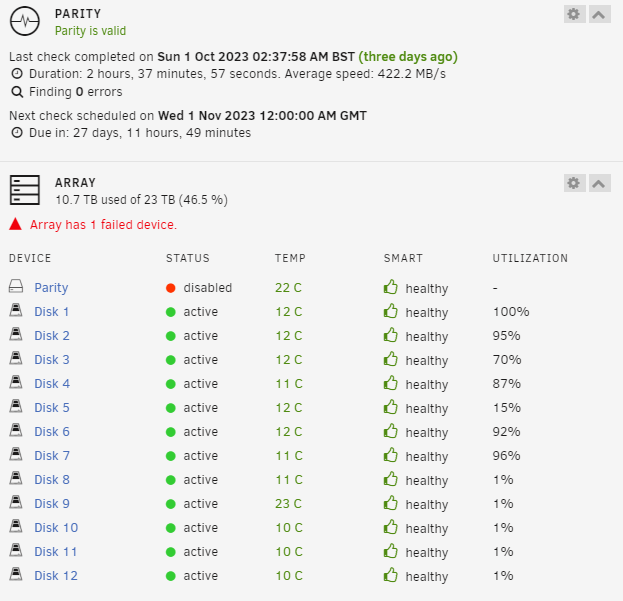

October 4, 20232 yr Author The SMART report looks ok (I think) but system still shows disk as failed. borg-smart-20231004-1252.zip
October 4, 20232 yr Community Expert 1 minute ago, maric said: The SMART report looks ok (I think) but system still shows disk as failed. Technically the disk is shown as 'Disabled' rather than failed. This will happen if a write to it fails for any reason so that the data disks and parity are no longer in sync. You need to rebuild the disk to clear the disabled status.
