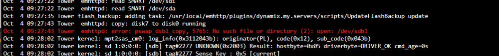

October 4, 20233 yr Hey all, I had a disk become disabled so I bought a new drive to replace it. New drive is larger than my largest/parity so I wanted to use the parity swap procedure. I followed the steps here (https://docs.unraid.net/unraid-os/manual/storage-management/#parity-swap), but when I try to execute step 14: Quote Put a check in the Yes I want to do this checkbox (older versions: Yes, I'm sure), and click the Copy button _Now patiently watch the copy progress, takes a long time (~20 hours for 4TB on a 3GHz Core 2 Duo). All of the contents of the old parity drive are being copied onto the new drive, then the remainder of the new parity drive will be zeroed. The page reloads and nothing starts happening. In the server log I see the following: I would really like to use the parity swap if possible, but I guess I could do it piecemeal instead... diags are attached thank you for any help you can provide! tower-diagnostics-20231004-0933.zip
October 4, 20233 yr Community Expert Solution Old parity doesn't have a partition, IIRC this can happen if it was added with a new config and then a parity check was done instead of a parity sync. You can clone parity with dd but then would need to manually force disable the disk to rebuild, also a parity check will be needed after the rebuild to make sure rest of parity past the original disk size is in sync, while possible it would be easier if you just find a new disk of the same size of the old one, then replace parity after.
