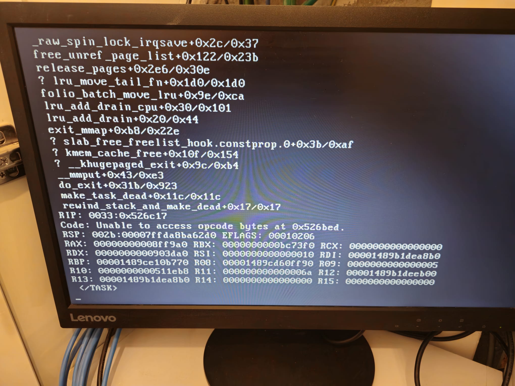

Long time user, my 3~ years old server has been crashing randomly (usually in the middle of the night).
I have no idea what can be the issue, but I'm attaching the diagnostics and the screenshot of the issue on the screen, maybe someone can have some ideas.

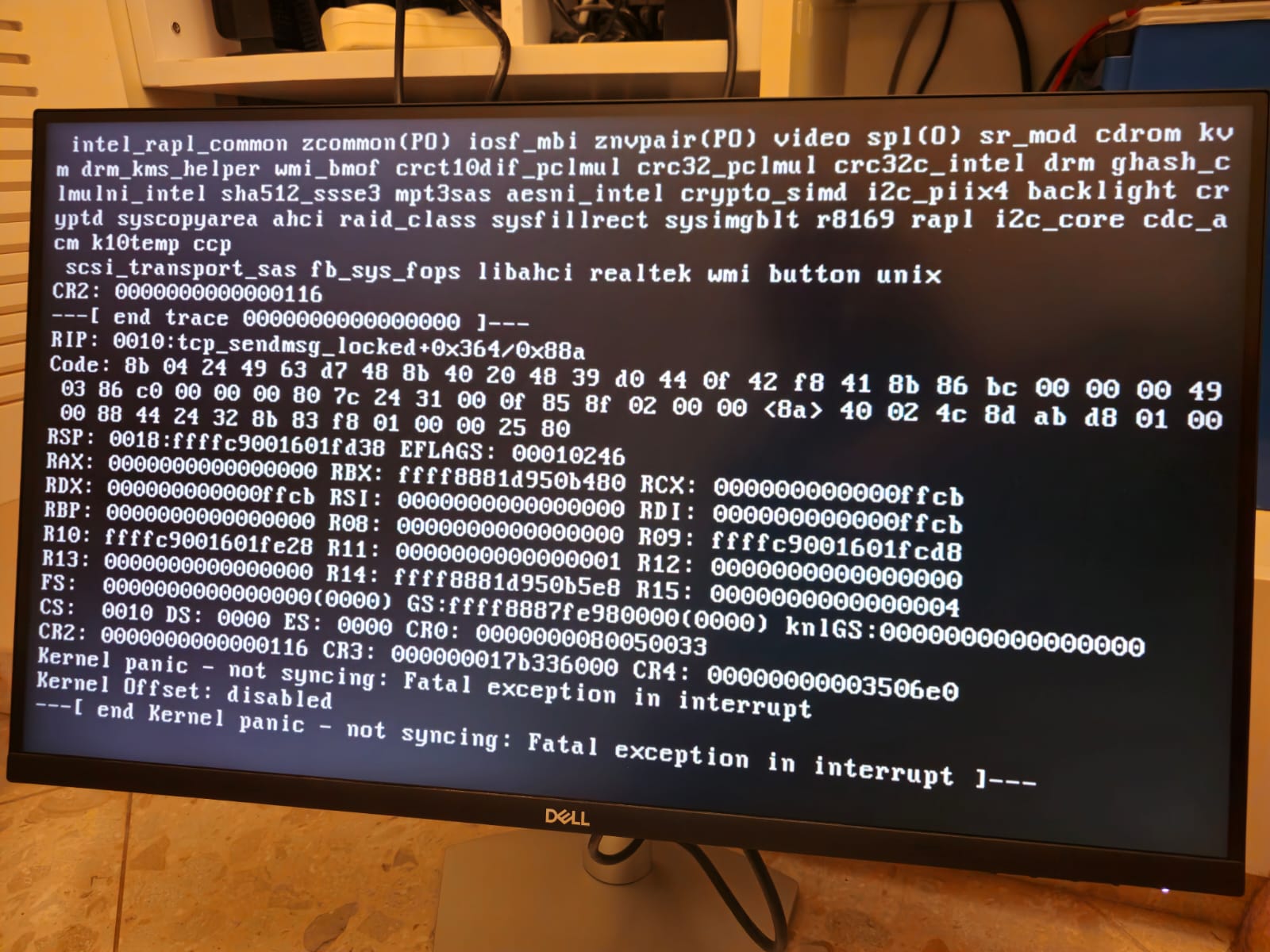

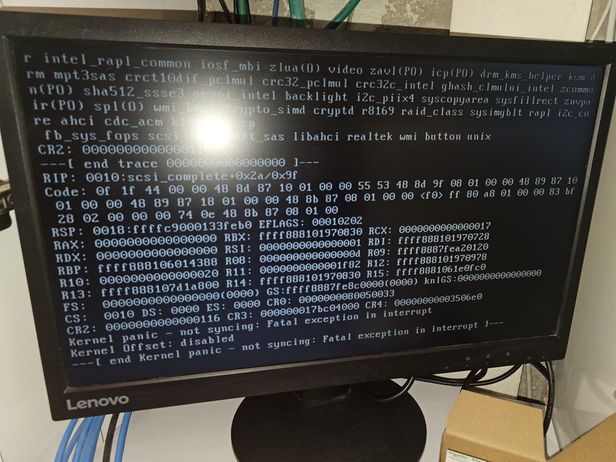

Took a while but I got syslogs for 2 cases. also attached screen shots of the issue.
one from a month ago and one from last night.

Nov 15 06:16:34 KTower kernel: macvlan_broadcast+0x10a/0x150 [macvlan]
Nov 15 06:16:34 KTower kernel: ? _raw_spin_unlock+0x14/0x29
Nov 15 06:16:34 KTower kernel: macvlan_process_broadcast+0xbc/0x12f [macvlan]
There may be other issues but the macvlan call traces will usually end up crashing the server, switching to ipvlan should fix it (Settings -> Docker Settings -> Docker custom network type -> ipvlan (advanced view must be enabled, top right)), then reboot.
