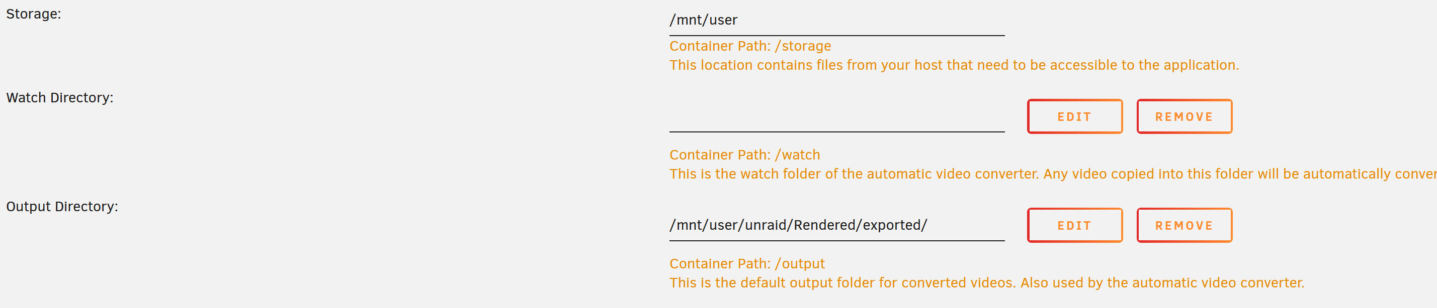

When I tried to output unraid to my SMB share it said that I don't have permission to read or write. May I ask if anyone can guide me on how to add permission to unraid so that it can output converted files to my SMB share drives?

I was hoping to allow handbreak running unraid as a docker container to export its transcoded files to the already "shared" folder smb so I don't have to transfer it over to access it from my PC after handbreak finished.
The transcode taking place source is from "input folder" which is shared via SMB. I copy files from my PC and put it there. Then in handbreak I chose the input folder (which unraid can access). However when I sent export destination to and choose my output folder shared via SMB it doesn't have permission. The transcoding happining within Unraid server as handbreak is running as a docker container.
However I think even though the allowed destination for me to export the file default is "output" in handbreak. I went to the setting and change the default destination to my SMB shared drives and I think it worked. I am not sure how, but I think it worked.
