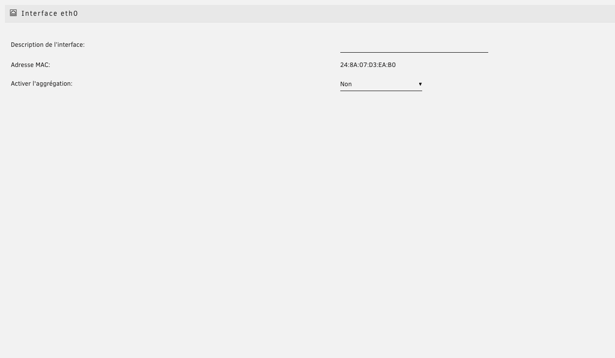

Each time i change a network setting i'm stuck.
I have no more access to network settings page only the choice of giving a name to eth0.
docker network custom br0 is no more selectable in docker template.

it seems to be the macvlan call traces problem.
So if i understand correctly i have to disable bridging on eth0.
it's too odd.
I reboot to regain access to network settings.
i deactivated bridging on eth0 and network settings disappeared again.
edit: unraid doesn't create a custom docker network with macvlan driver. I tried to create one with portainer but after validation the network get created with driver: "none"

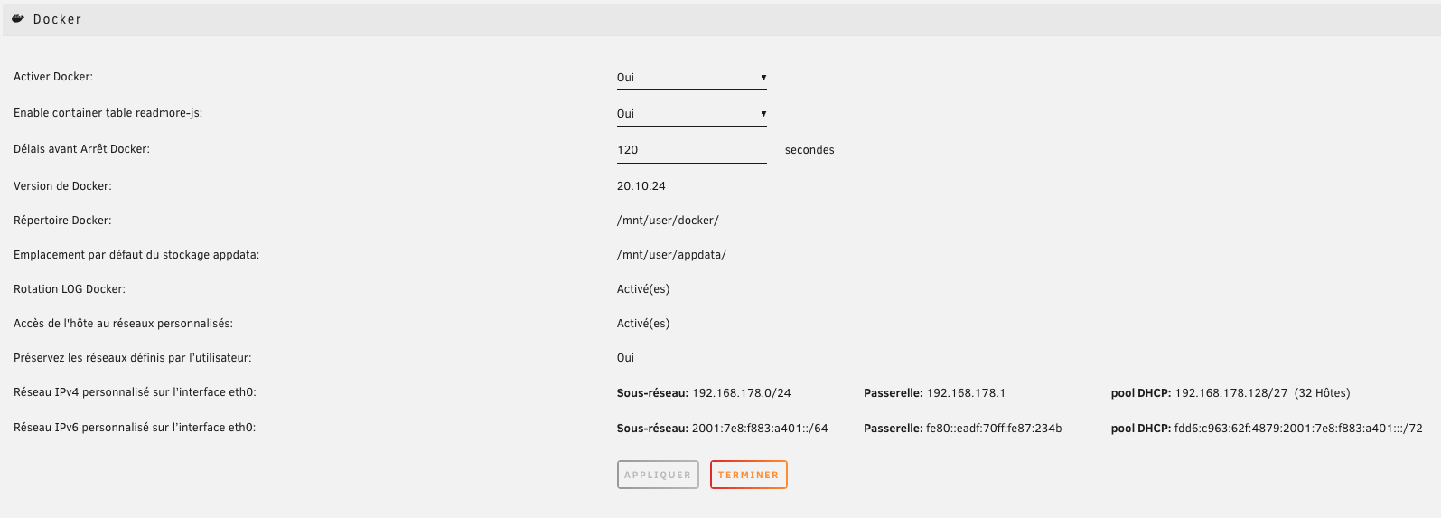

and the gui:
i've been able to create a custom docker network with macvlan but ipv6 is not enabled for it.

deleted docker.cfg, network.cfg and rebooted.
custom docker network eth0 with macvlan driver, ipv6 enabled and parent interface vhost0 get created upon reboot.
I had to set up docker parameters and it started correctly.
