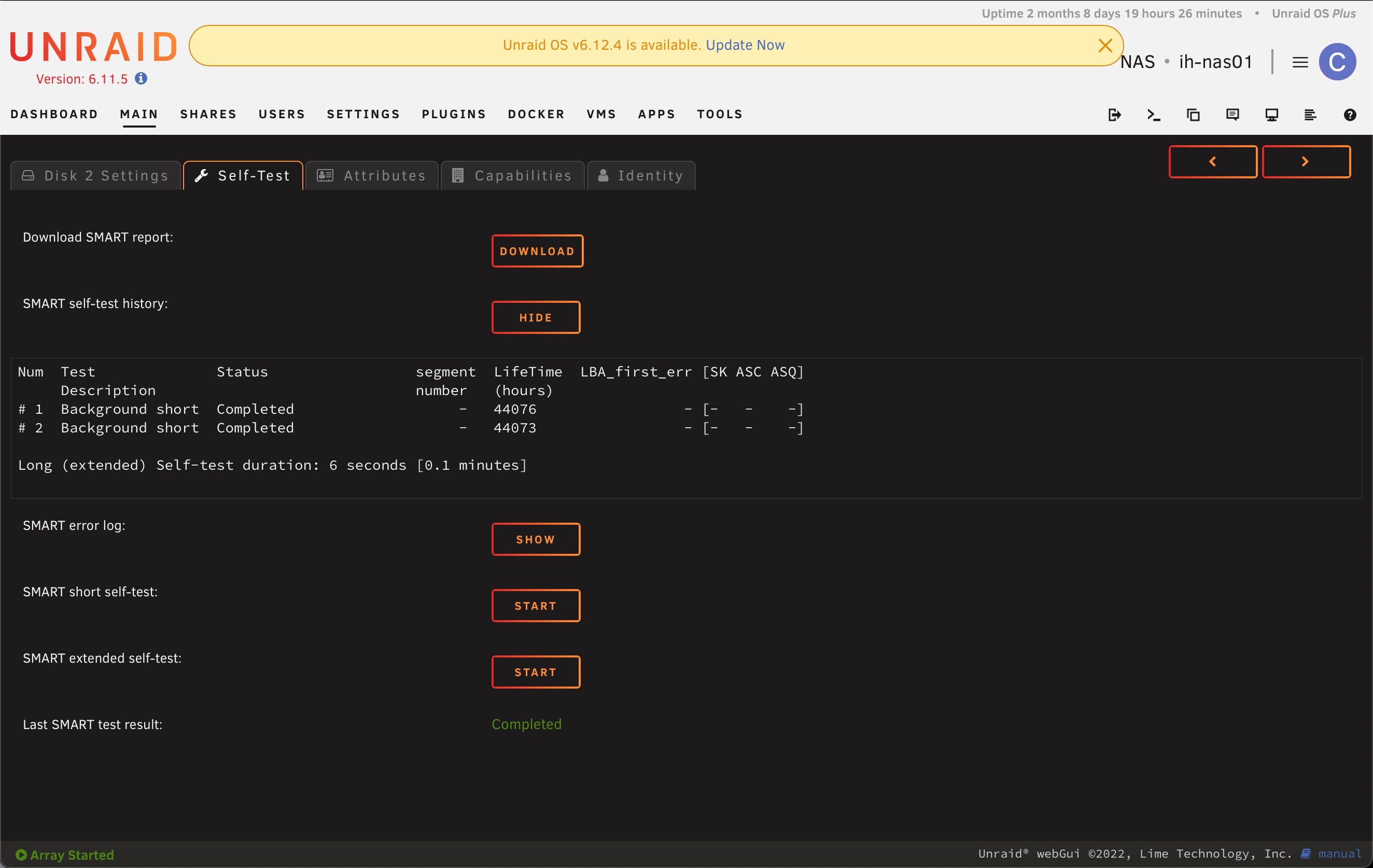

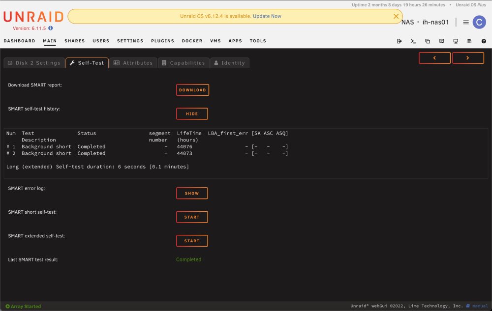

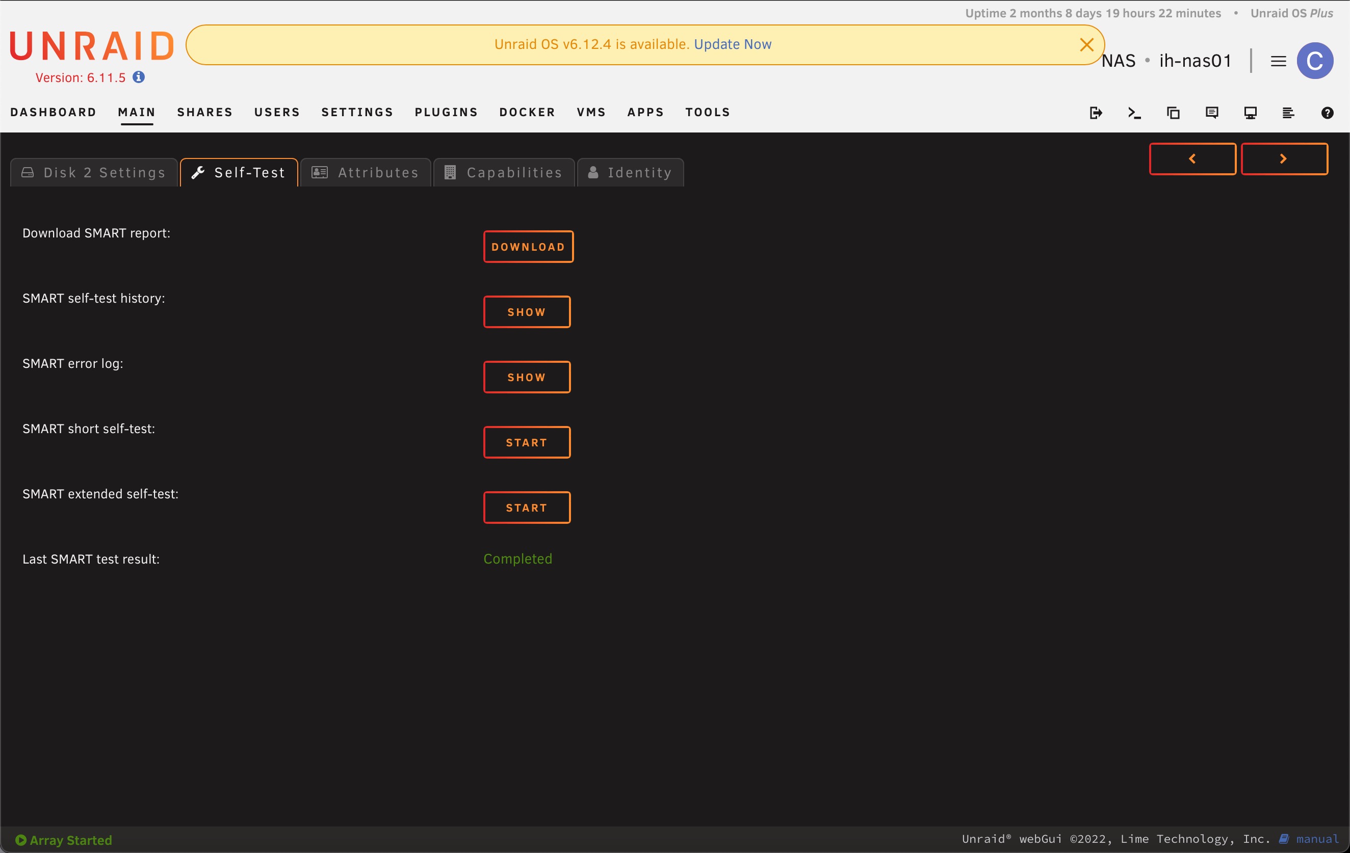

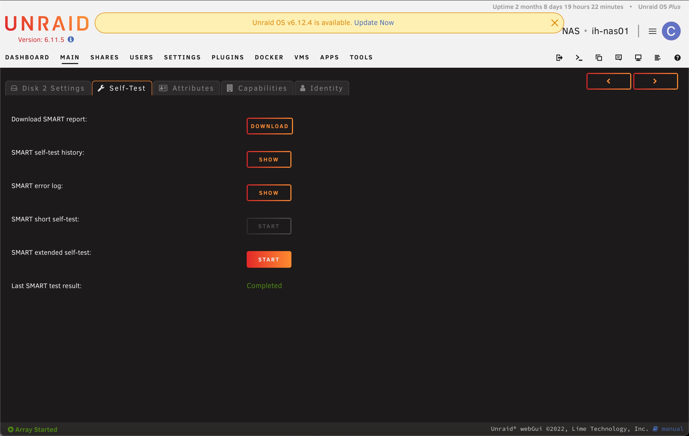

I am trying to run the SMART extended self-test on a single disk in my array, but clicking the START button immediately changes it to STOP, then back to START again. It's like it's trying to start the test, fails, and then goes back to the starting position again. Disk 2 is showing some read errors, so I want to run the extended test to make sure it's not on the verge of failing
I can, however, run SMART short self-tests just fine.
Before clicking START:
After seeing STOP briefly, then back to START:
Here's the report of test results as well:

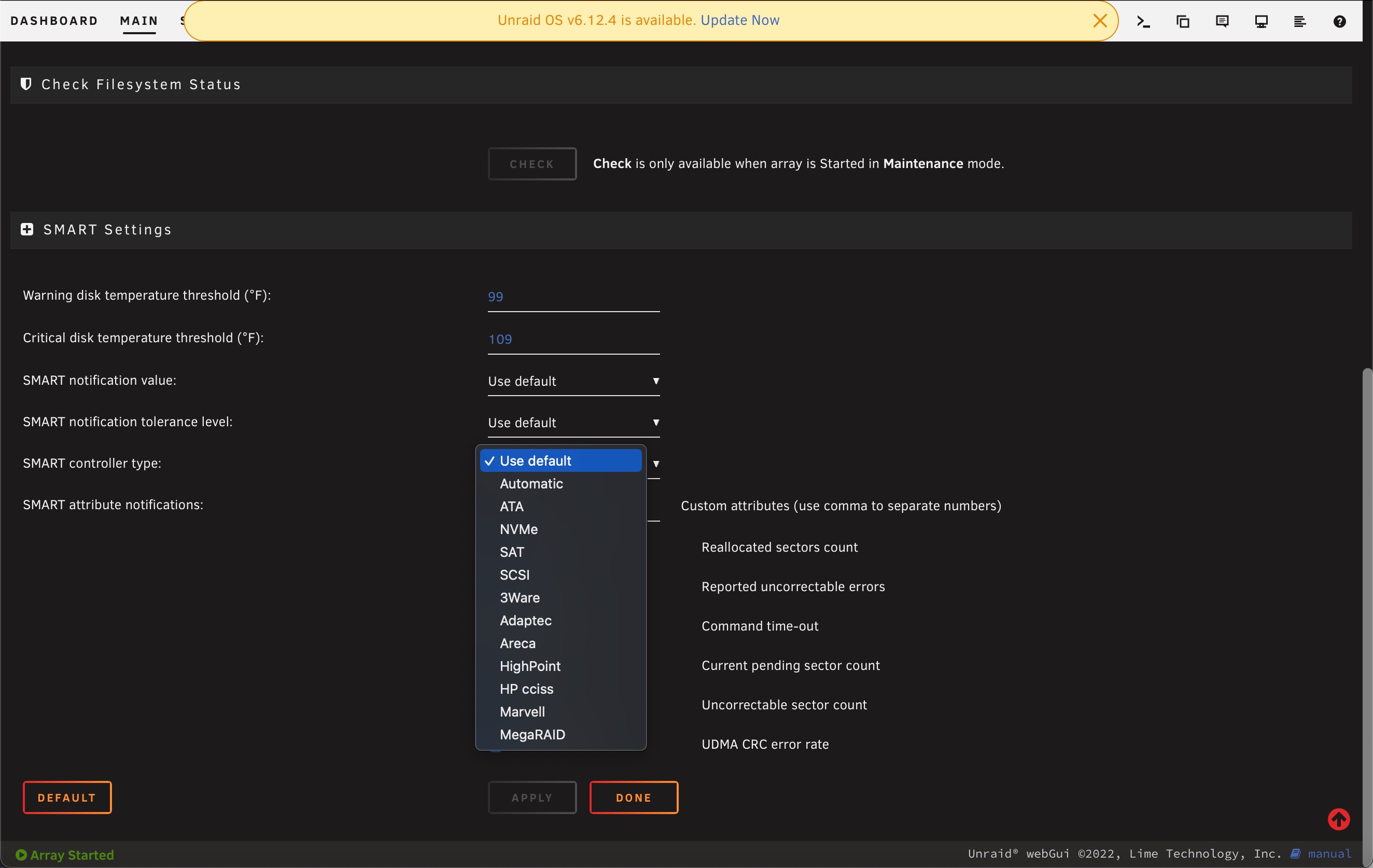

Try setting on of the Smart Controller Types in Main, Click on the Disk#, SMART Settings.
Hi @Squid, here are the settings I see in that drop-down menu:
I'm running SAS disks , so I would guess I want ATA. Are there any others you'd suggest I try here?
(FWIW, running that "smartctl" command with "-d ata" didn't work, so I'm hesitant to try that same option here.)
Either way, it sounds like the approach would be:
1. Set the controller type and apply changes.
2. Re-run the extended self-test to see what the results are.
3. Rinse and repeat previous two steps for other controller types.
Let me know if you think I should try any others. Thanks very much!

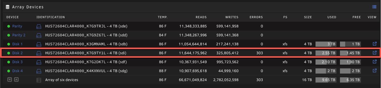

On 10/9/2023 at 6:17 PM, crescentwire said:
/dev/sdi doesn't exist in this list

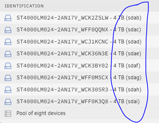

It's not on that list, it's what you see on main, e.g.:
[unsupported field in scsi command]
This looks like a device error, try a different disk, ideally from a different brand/model.
Here's what I see under Main:
With that in mind, "/dev/sdi" would be correct. Would you agree?
I don't have any other array disks in my server--these are all HGST 4 TB SAS drives. It sounds like I'm unable to run an extended SMART self-test with these drives. Whether that's a limitation of them being SAS or the exact make/model, I'm not sure.
Are there any other options I have to assess the health of this disk, given the read errors I'm seeing?
Swap cables/slot with a different disk and run a parity check, if the errors follow the disk it's likely a disk problem.
