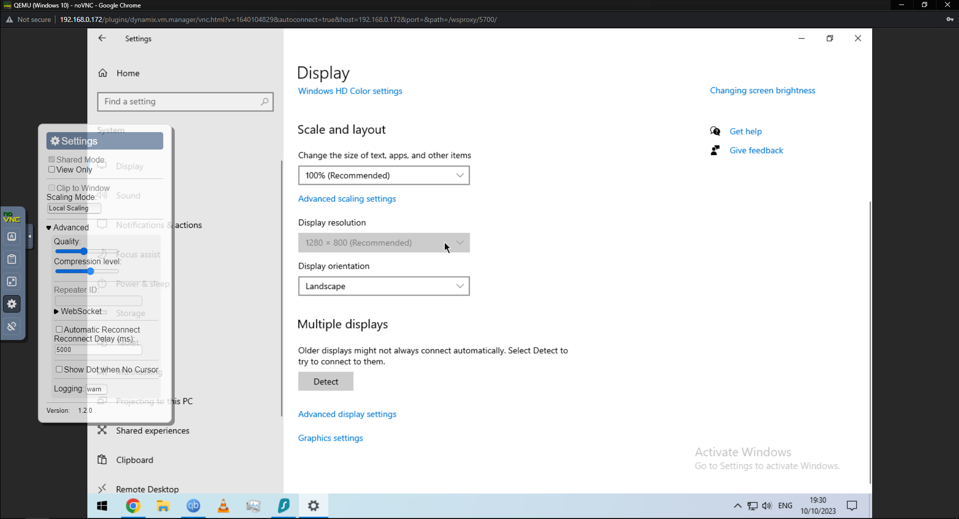

October 10, 20233 yr It's been a while and I cannot recall how, but I used to be able to change the OS level display resolution of my Windows 10 VM, which is currently at 1280x800. As you can see in the screenshot, the resolution option is greyed out at its current setting. Any help would be appreciated.
October 10, 20233 yr Community Expert Solution 49 minutes ago, eChristopher said: It's been a while and I cannot recall how, but I used to be able to change the OS level display resolution of my Windows 10 VM, which is currently at 1280x800. As you can see in the screenshot, the resolution option is greyed out at its current setting. Any help would be appreciated. goto device manager and load the qxl driver from the libvirt cd

July 22, 20242 yr SimonF Thank you! I was having this issue after migrating a Win 10 Pro VM from VMware to Unraid. I went to the current display adapter and updated the driver. then pointed it as the driver iso in the "disk drive." as soon as it installed the correct driver it popped to 800x800 then ungrayed the option. i was then able to change it to whatever i needed.
