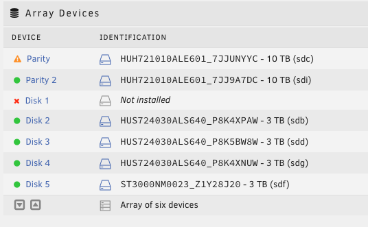

Hello,
I've been using unraid for a long time, but only in the last few months I've been using more the disks. Currently I have around 15TB of total disks size but some of my disks were having problems (mainly used Dell SAS 3TB).
Last week one of those disks were disabled, so I took him out and added a 10TB disk which I applied as Parity 2 (since 10TB was the biggest size), but the main purpose was to then replace the Parity 1 into Data (replace with the disabled disk).
I ended up finishing it, and currently I have 2 parity disks and 1 missing disk in data.
Now I'm trying to pass the Parity 1 into data, and since I cannot switch Parity 2 into 1, and Parity 1 into data, I ended up adding another 10TB disk into parity 1, and then the first Parity will go into data.
But I'm having some errors, and I can't understand why, since it is quite random.
I hope someone can help me with this. I'm a bit noob in this subject
Diagnostics is in attachment
EDIT: I ended up restarting the server, and now the Parity 1 appears with a green dot I don't know. Just in case I started the array and I'm currently doing the parity-check to make sure everything is alright

new update
Log shows issues with parity2 and disk2, both look more like a power/connection problem, check/replace cables or try again with a different PSU if available.

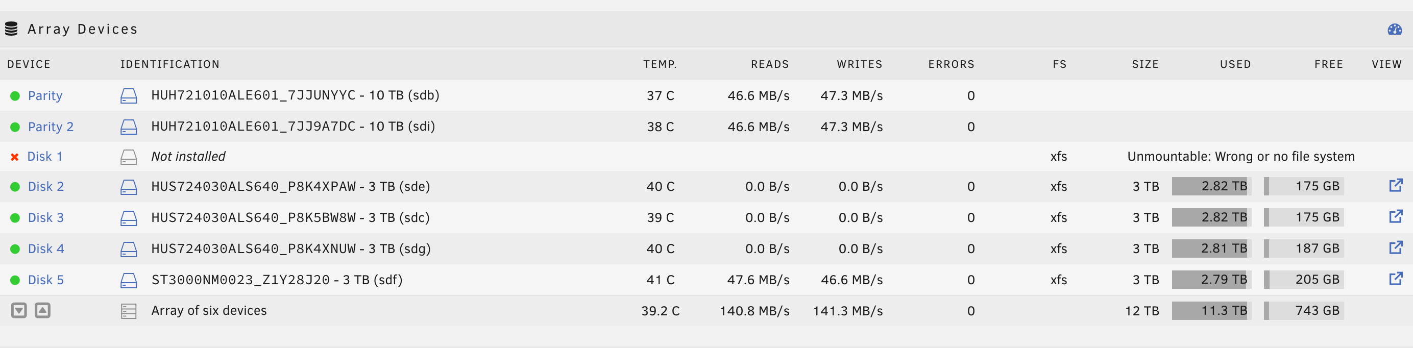

I'm copying 2.8TB but I only have 700GB left on my array, can I still copy data. After the copy I'll add this disk into the array so the storage will increase.
Right now the array tells `Device is missing (disabled), contents emulated`
You can format the emulated disk, so that it can also be used for data, then rebuild.

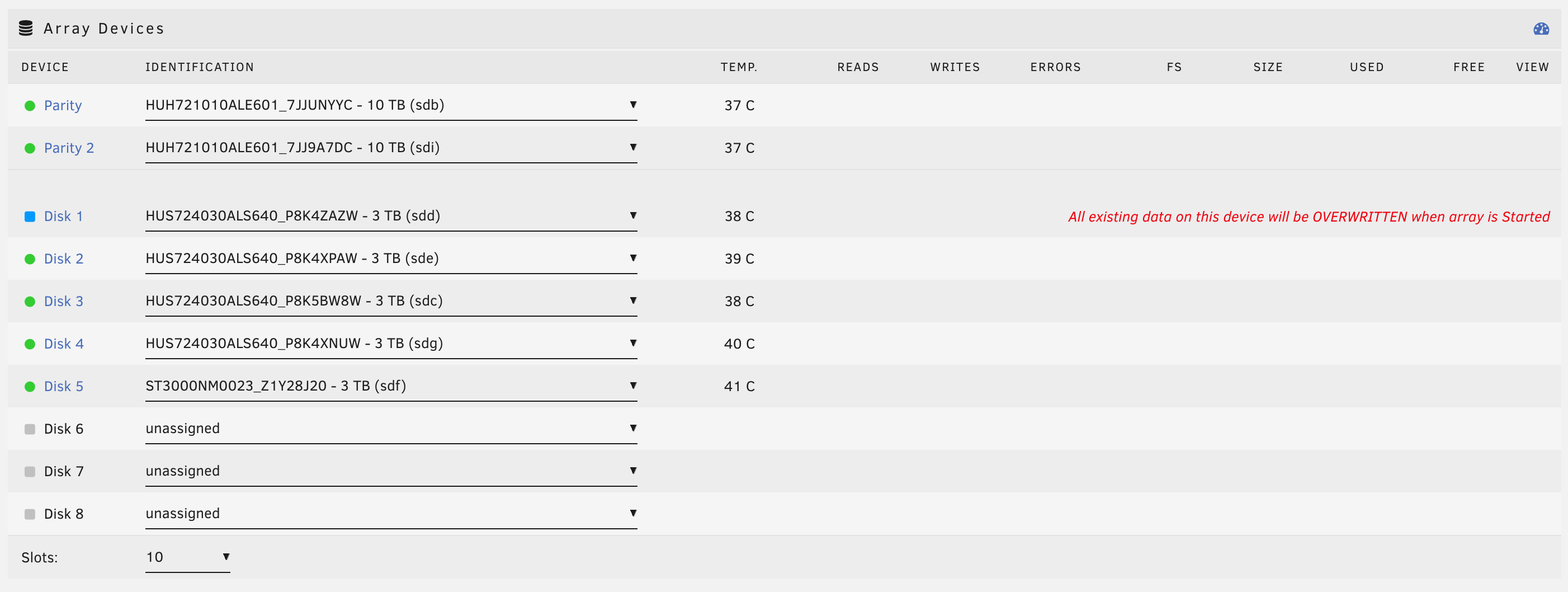

Format button is next to array stop button, there's a checkbox.
You sure that it's okay to start the array with the disk in this state?
I'm affraid Unraid will erase it's content
Don't add disk1 to the array before copying all the data, I posted about formatting the emulated disk, not the old disk.
