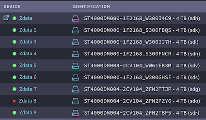

I also noticed another issue. The failing drive was zdata5, and that slot now shows the new drive ID
However, zdata8, a different drive which seems healthy is showing a red cross next to it with message "device is disabled, contents emulated"
In the zfs pool status, there is this in the 8th row
10871034331009088735 UNAVAIL 0 0 0 was /dev/sdq1
but, sdq was the previous identifier for the failed drive (it shows unassigned now) and it was in slot 5 before. The drive in slot 8 is sdo which shows online in zfs status. Is this just a UI glitch?

sdo is the exiting drive from the pool in slot 8 (which is showing a red cross). I did not touch it, yet it is somehow in play
slot 5 is the new drive, it showing as sdv. the drive before replacement in slot 5 was showing sdq
I did not touch slot 8, that was and is sdo, and became red after I started array after replace

notice the ordering difference (missing drive is same position as the red drive in UI, but sdo is showing elsewhere in 4th slot. sdv is nowhere)
I will run wipefs on sdv and see what happens

i created partitions on sdv using sgdisk and did replace as above. its resilvering now
there seems to be some odd behaviour on the slots on unraid UI vs the disk order shown by zdb or zpool status. zdb shows the failed disk as 8th drive, but thats a different order than unraid assigned slots. Then unraid seems to be doing operations based on drive index rather than drive IDs (which is why it was trying to target sdo)
I'll see how it looks after resilver and reimport, but if the drives don't line up, this may be an issue in future too
