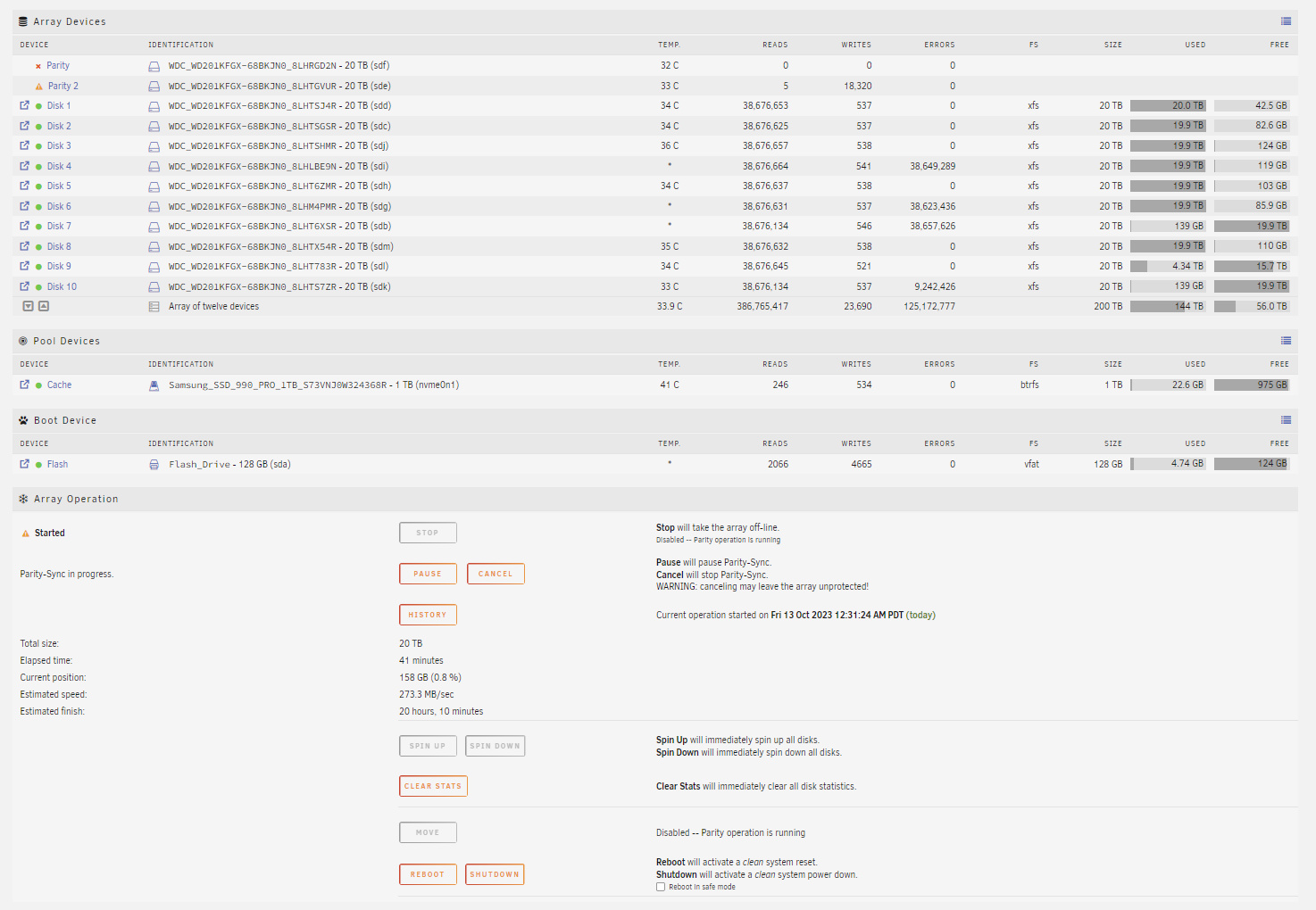

Here is what my array looks like now:
I still see a lot of warnings in the logs:

Should I let the parity run at this point?
Edit #1: I spoke too soon. There are errors on disks 7 and 10 now. Disk 7 has its own SATA cable connected directly to the motherboard, while disk 10 is connected to an HBA.
Edit #2: Disks 4 and 6 have joined the party.
raphnas-diagnostics-20231013-0113.zip
Edited by raphytaffy
Still issues, if it's not the PSU it could be a controller or cable problem.

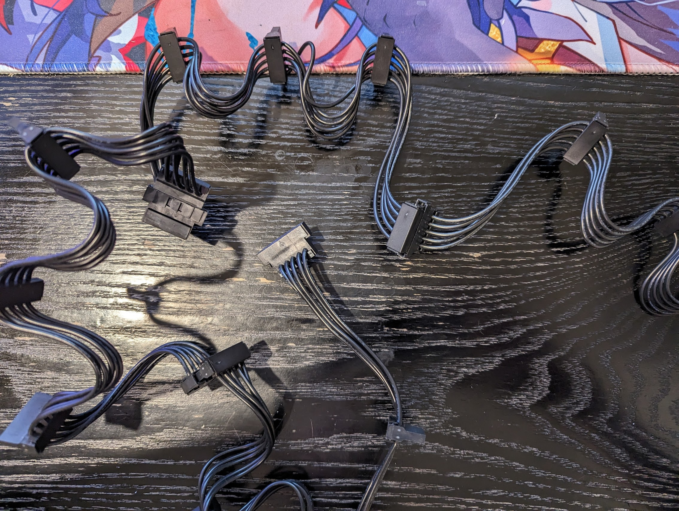

Thanks, I'm not great at debugging hardware issues, but I think I may have resolved it.
My previous PSU (Corsair CX550) only had one SATA power cable, so I daisy chained SATA extenders together (don't laugh at me haha):
This time, the array started on boot without any issues and there are zero errors on the drives so far.
Parity-Sync is currently in progress for Parity 2, however Parity 1 is still showing Parity device disabled. Should I let that continue?

43 minutes ago, raphytaffy said:
Is daisy chaining SATA extenders advised against?
Definitely don't do it.

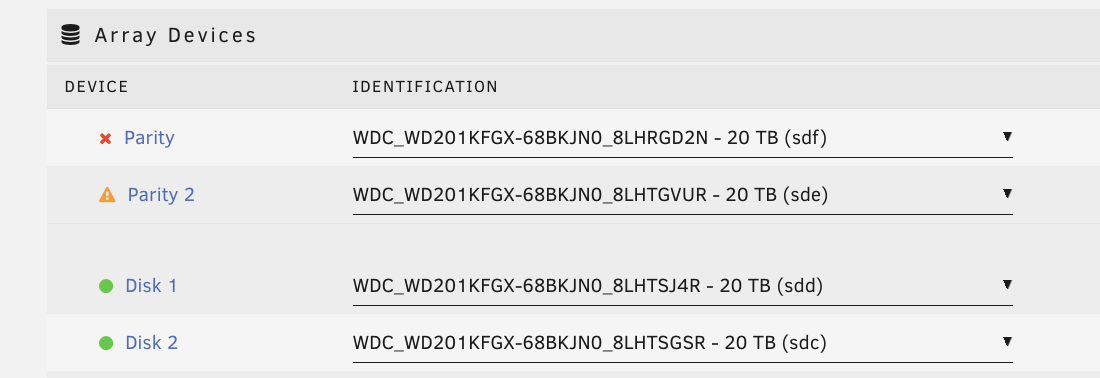

Cancel and re-enable parity1 so that both are synced together.
I've cancelled the Parity-Sync and stopped the array. Parity 1 is still showing a red X (attached).
How do I enable the Parity 1 drive?
  • Stop array
  • unassign parity1 ready to make Unraid forget current assignment
  • start array to commit change
  • stop array
  • assign parity1
  • start array to sync both parity drives
4 hours ago, itimpi said:
  • Stop array
  • stop array
  • assign parity1
Thank you! These were the steps I originally took to try to run the Parity-Sync, but I guess the power issue caused other issues to surface.
Parity-Sync is now running for both drives. Appreciate everyone's help! Fingers crossed it finishes without errors.
