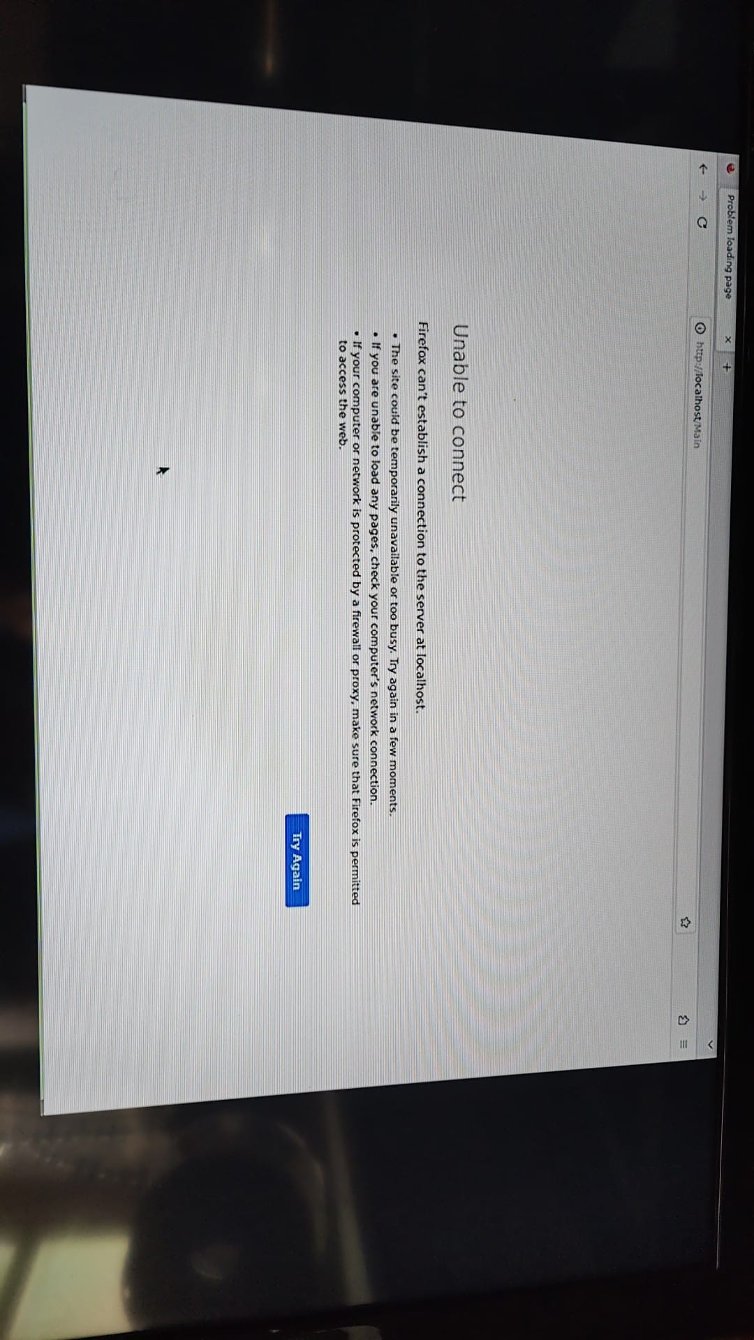

My unraid server has started crashing after starying the array. Its been stable for months.
When it crashes I can ping the server but cannot SSH. I have connected up a monitor and this what i get on the gui.

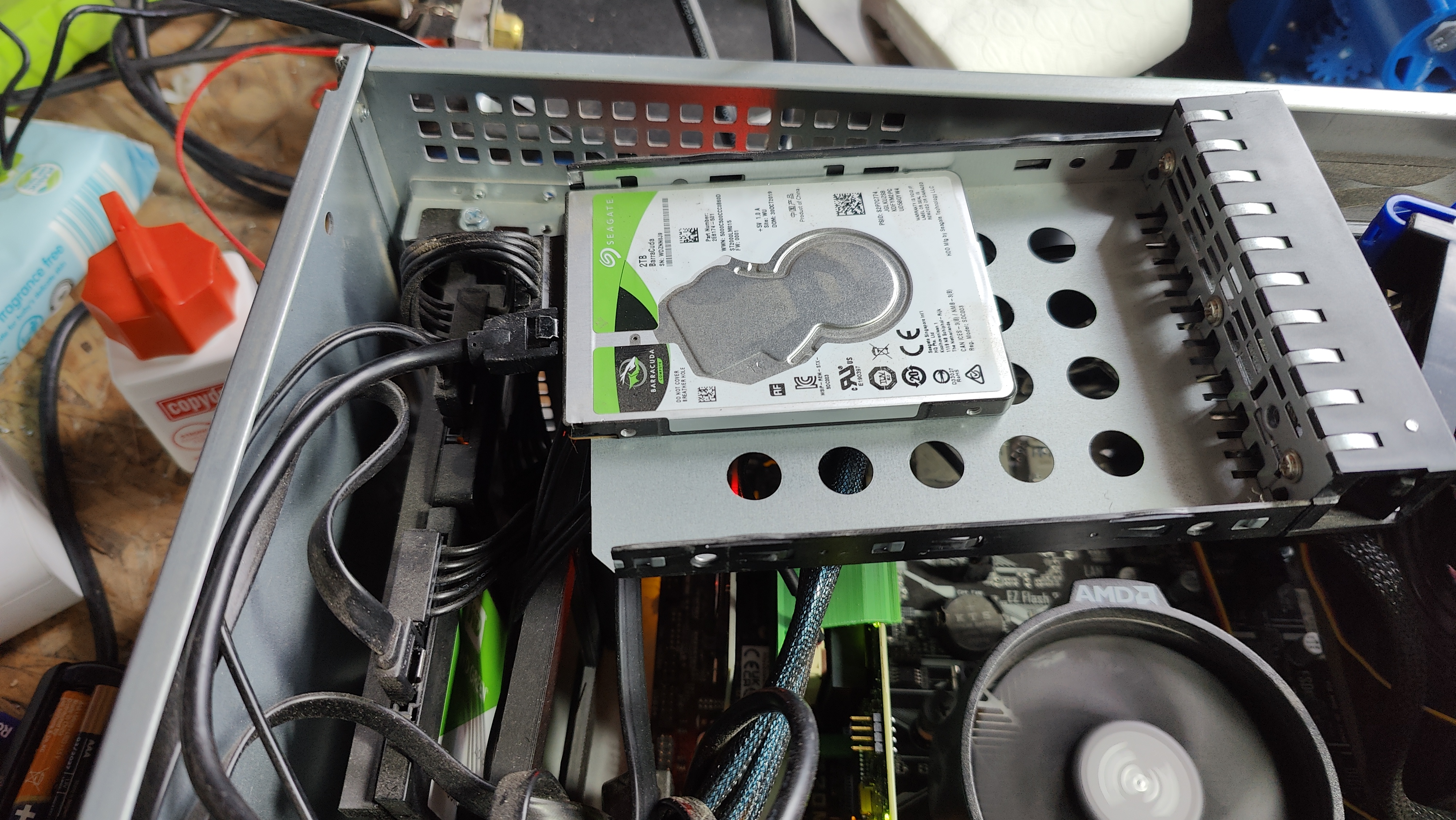

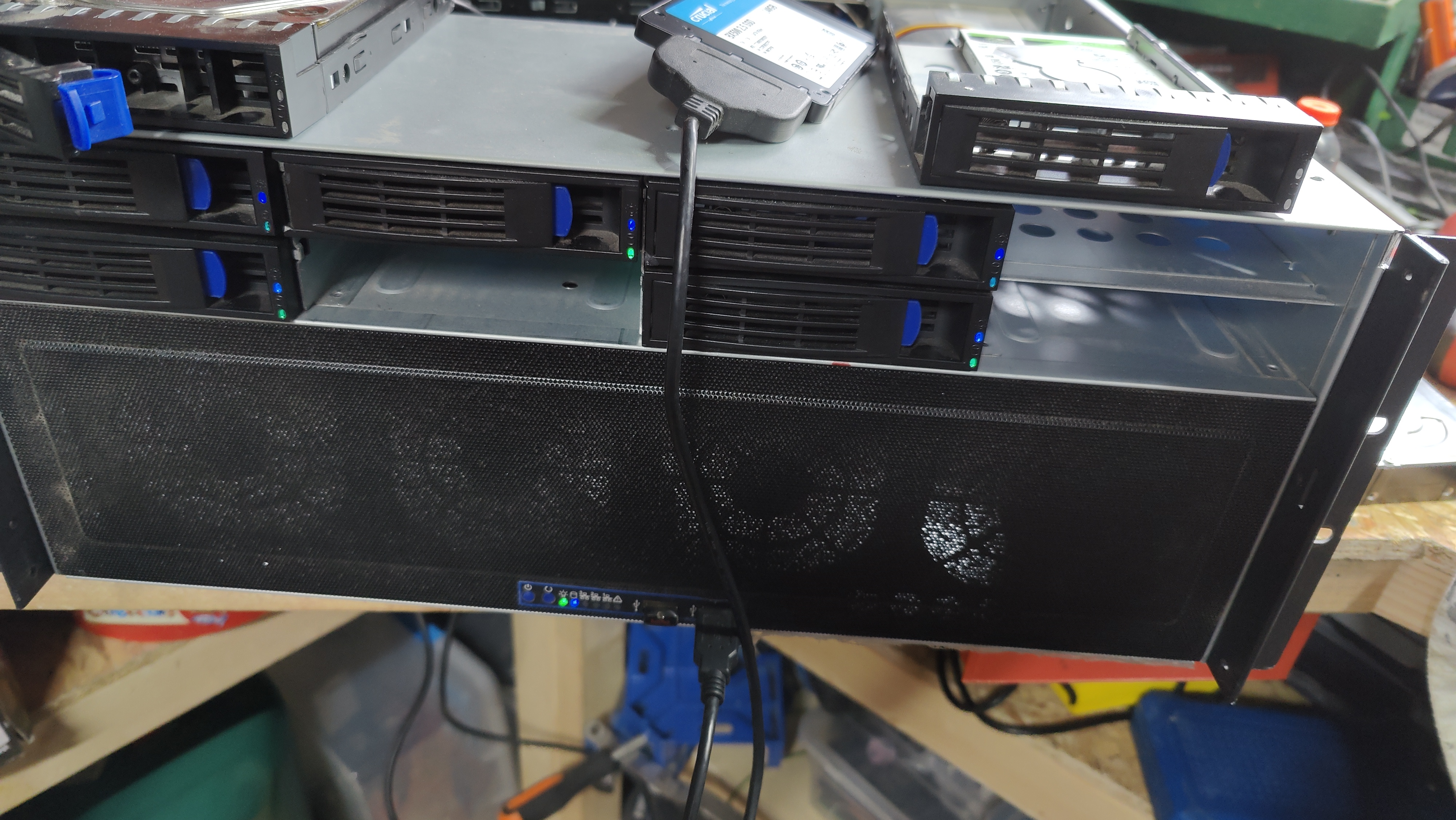

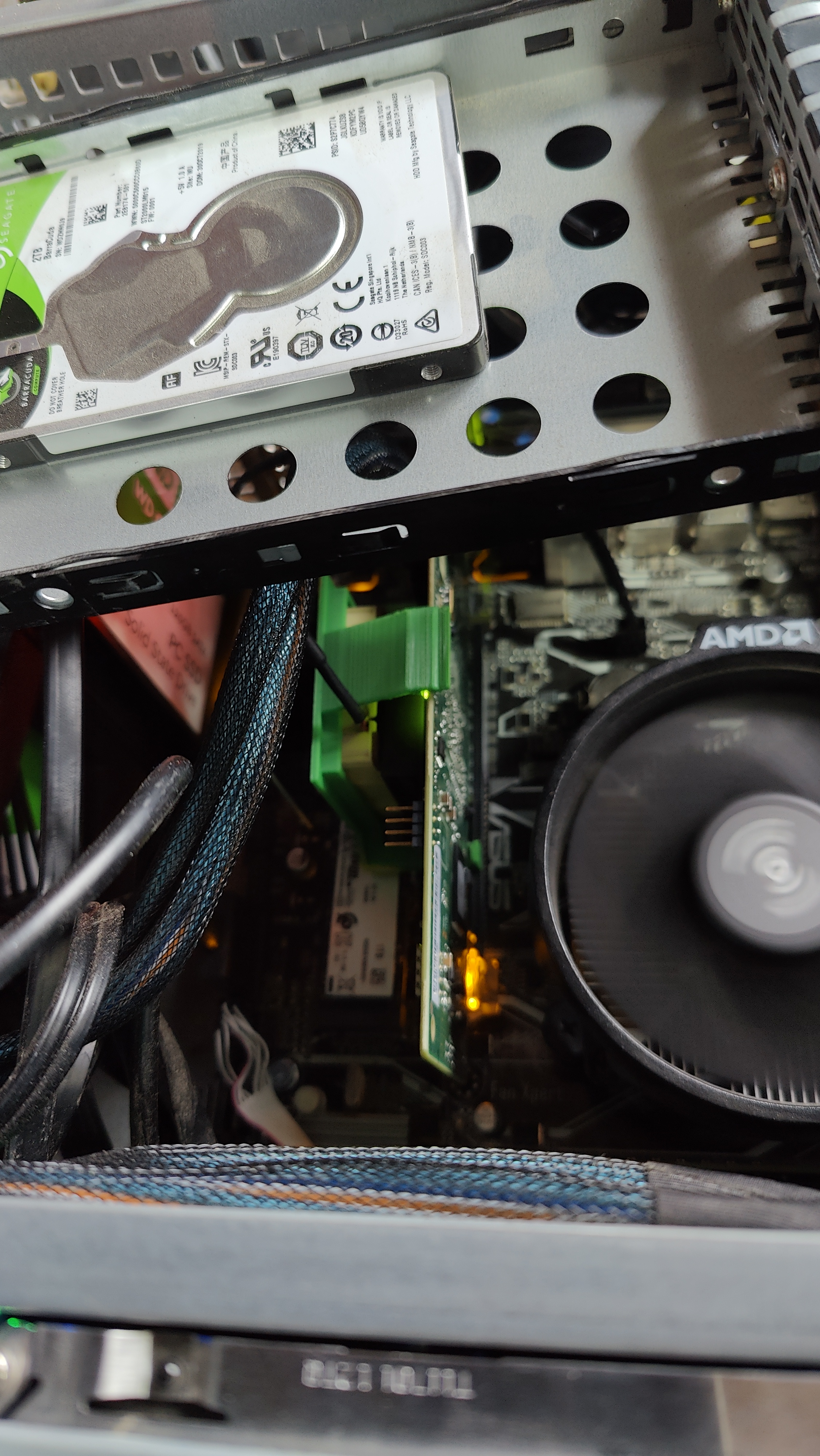

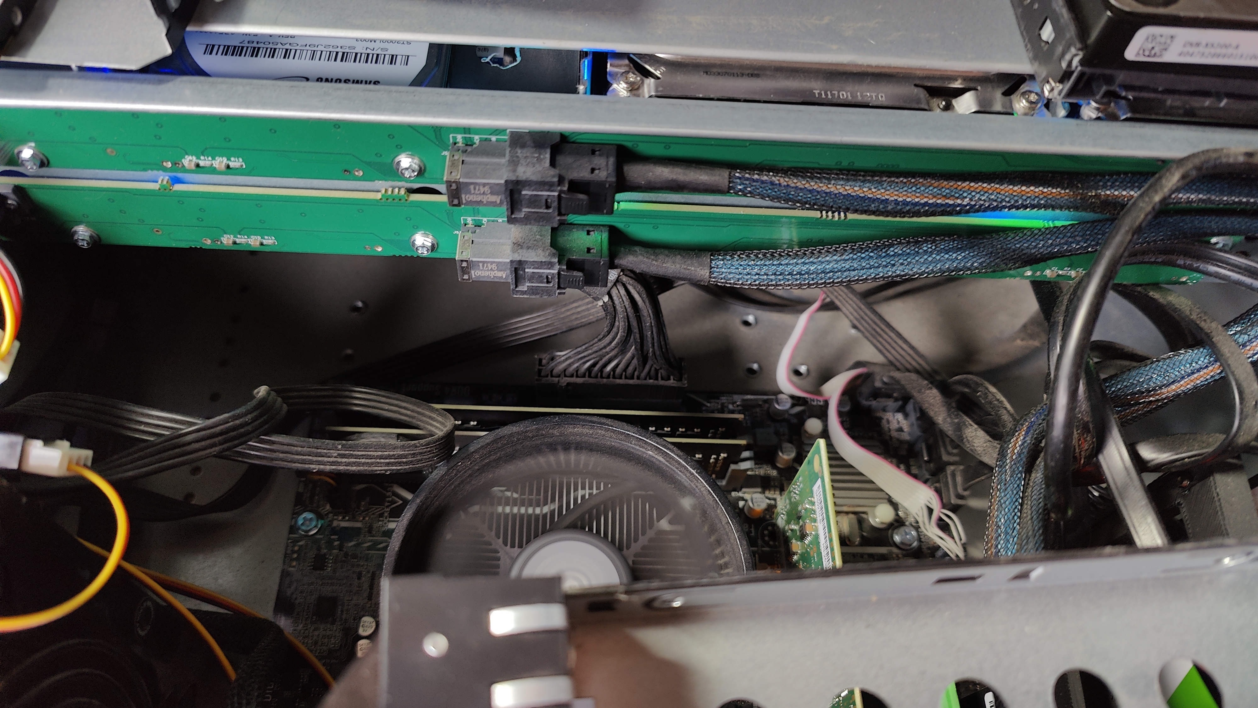

i think its defo a issue with the hard drives.
I have a HBA card into the PCE 16x slot. I have already swapped the HBA card but i am still getting errors with SOME of the drives. I have put a problamic drive into one of the sata ports and so far its fine.  Its still rebuilding the array.
