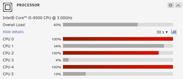

i have the problem that my unraid server becomes really unresponsive from time to time.
The Processor view often shows all cores to be used by nearly 100%:

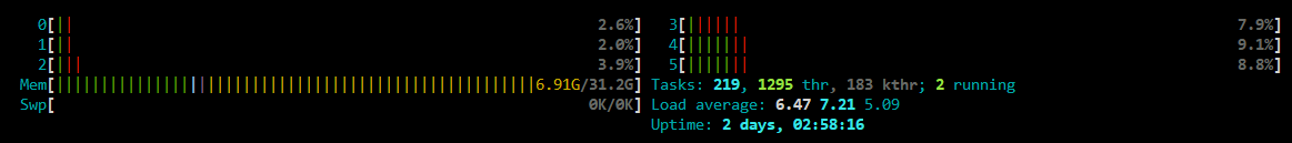

But when i look into htop everything seems to be fine:
I've ran Proxmox before on this server where i had no performance issues at all. Does anyone know what could cause this? Is it just caused by parity calculations? If thats the case, why can't i see them in htop or somewhere else?

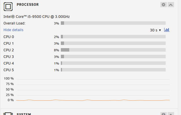

Seems like it does. I've deactivated docker now in Settings -> Docker.
After that the usage pretty much goes to zero. What could cause this?

Okay, all containers are now stopped and i've started one of the smallest containers i have (homarr)
The Usage immediately jumps up to 50%. Just for a short time but multiply this by 18 and it makes sense that there is such a high usage.
But why is it like this? Under Proxmox with all containers enabled there were no performance issues at all.
Even when i open the webpage of homarr in my browser i can see that there is a significant increase in usage in this graph.

And why can't i see this in for example htop?
htop doesn't show iowait normally, the dashboard includes it.
