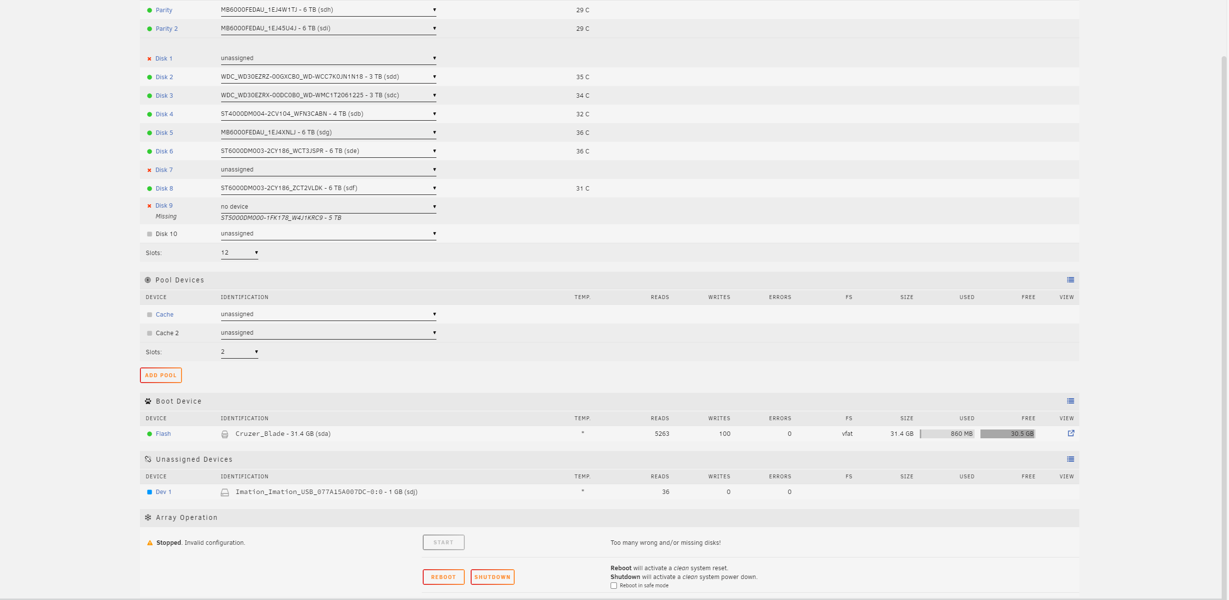

You should, post a screenshot of main.
yes once I get back to the workshop tomorrow I will post a screenshot etc diagnostic file.

That's because you have 3 missing disks, not 1. Dual parity can only tolerate the loss of 2.
What are disk 1 and disk 7? If these were intended to be permanently removed from the array previously then that was not done correctly and as a result you've been running without protection since.

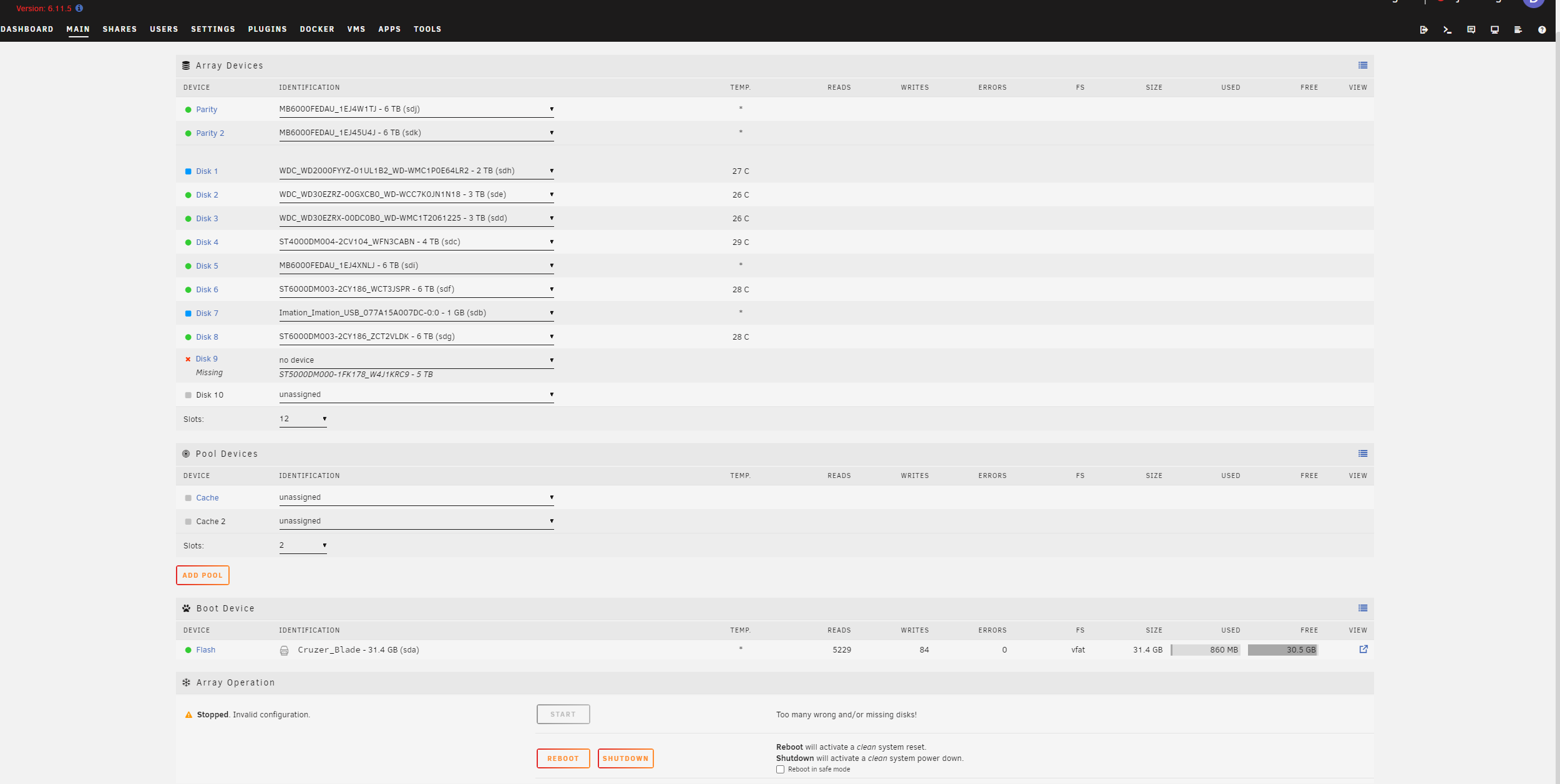

I have now added 2 new drives to the missing drive slots, but there is still no option to start the array. and still says invalid or missing configuration.
Unraid . Why can't I just start it up and retrieve the data.
That is useless at this point
But in any case all the data on drive 9 is now lost due to the fact you were running with 2 missing drives, there is no way to get it back (unless you can get that drive to work again).
To get the server running go to Tools->New Config, Preserve current assignments = All, go to the Main page, remove any drives not needed (1, 7, 9), that'll let you start and will rebuild parity.
