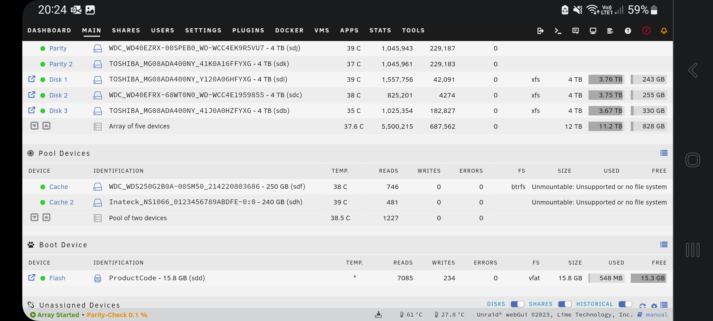

ran commands on it but no luck see screenshot so I rebooted to see if this would bring docker back up but now I have the following on my cache disks they are showing as incorrect format but some dockers are working but not all.

If the log tree is the only issue this may help:
btrfs rescue zero-log /dev/sdf1
Then re-start array, also change docker network to ipvlan.
ideal this has fixed my cache your a life saver :D

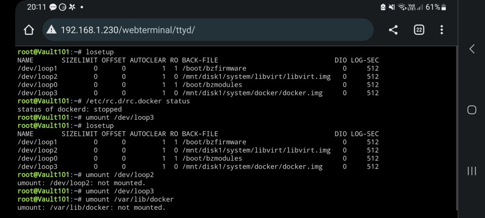

also noticed i got the pop up for unraid V6.12.4 is it worth upgrading cause it got stuck on unmounting again and i had to run the commands losetup, umount to actually get the array to stop but going by above forum that should been fixed on the version of unraid i have installed
