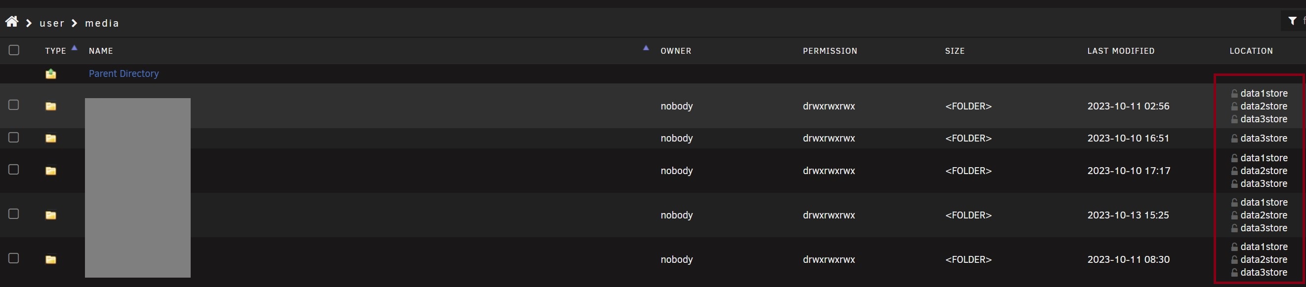

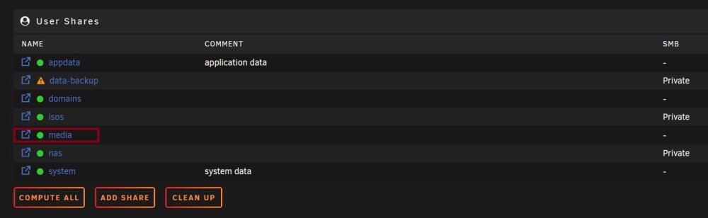

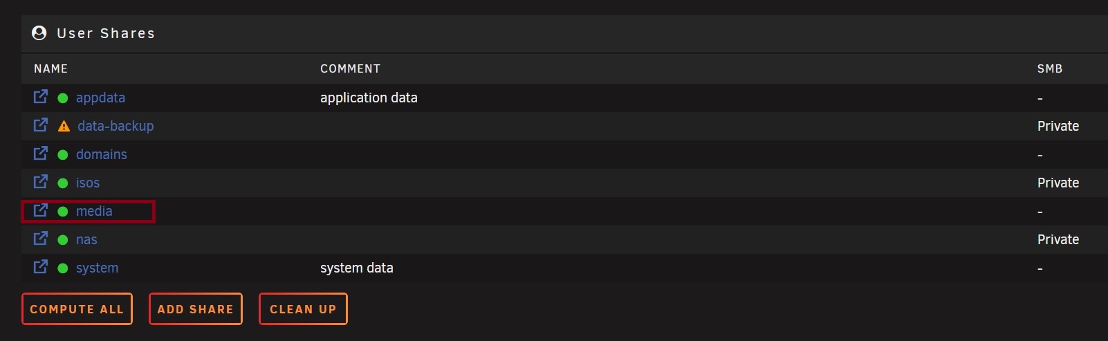

Adding some pictures for better understandig (sorry for my lousy expression):
Before the issue started, the "media" share in red was not visible in the shares section of Unraid and this is the expected bahaviour.
This share was created via SMB Extras manually.

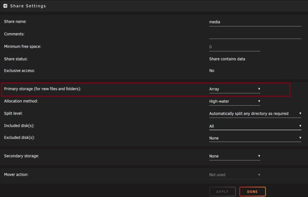

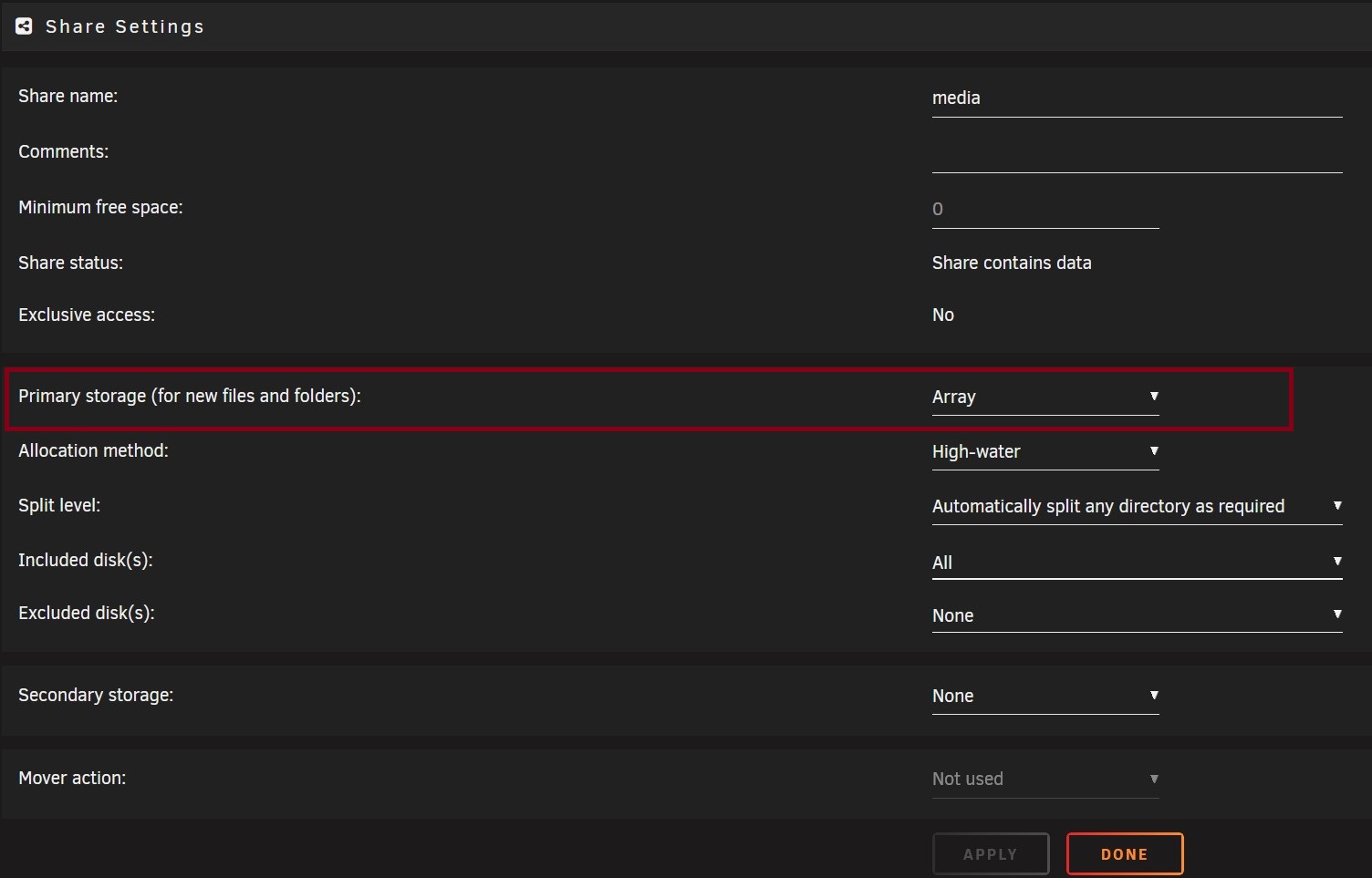

That`s what it looks like inside of the share settings. Who defined the primary storage as array?
How does Unraid know, that there is a share "media" created in SMB Extras and its location is at data1store, data2store and data3store? Which instance is then creating /mnt/user/media?

Unraid will automatically create a User Share for any top level folders on any pool that can be used for User Shares but with default settings.
the thing to do in your case is to go into the share settings and set the Primary storage to the pool, and the secondary storage to None.   This will not remove it from the GUI but it will function as expected and all its contents stored on the pool.   No need for you to manually play around with the SMB settings.

Unfortunately changing the primary storage to the pool is not working in this case, since I am accessing three pools in total merged with MergerFS.
Pool 1 ZFS mirror => /mnt/data1store
Pool 2 ZFS mirror => /mnt/data2store
Pool 3 ZFS mirror => /mnt/data3store
merged to /mnt/datastore
If I am trying to change the primary storage of "media" now, I am able to choose between data1store, data2store OR data3store but no datastore, since it is not a pool but a merged folder instead. For that reason I have created the share "media" within SMB Extras and it should not be visible in Unraids share tab.
