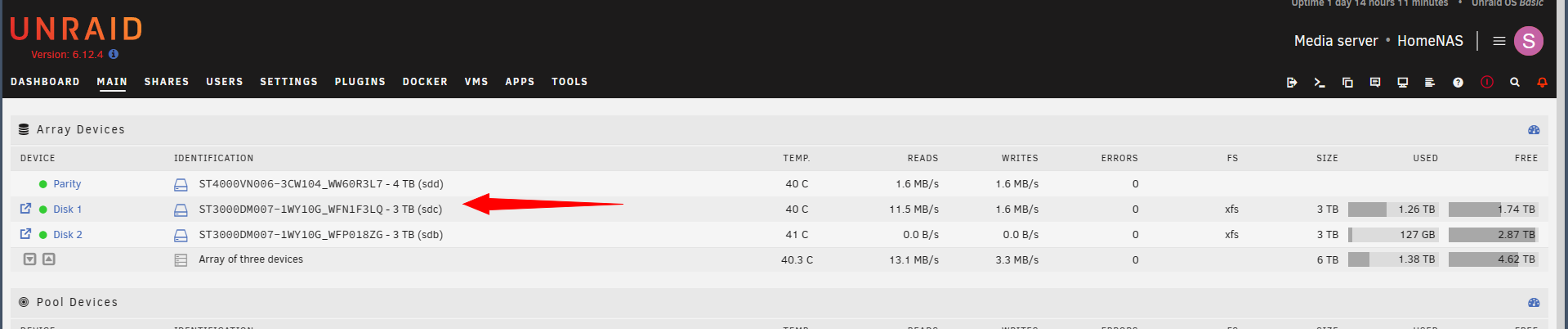

Hello, I have an disk error at disk 2 initally  and changed the error disk 2 ( WFP018ZG ). After changing the disk, the system is unable to shutdown and i made a force shutdown to my server.

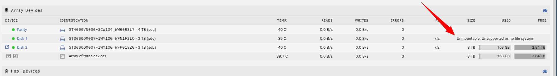

When the system restart, i am facing this error on disk 1.
I have wait until the array to rebuild for my new disk 2 and restart , the error persist. May I know what should I continue to do ?

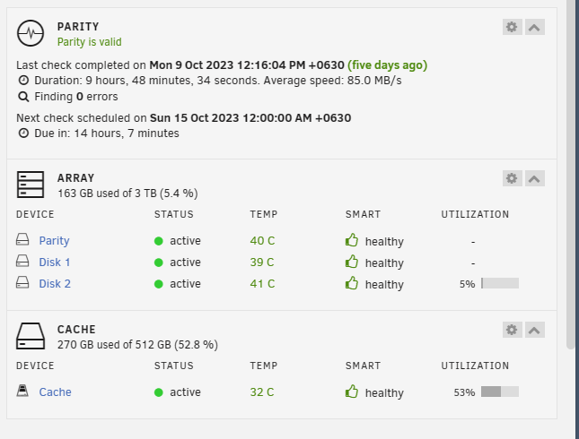

On my dashboard, it shows everything is running fine.  Parity is fine, disk 1 and disk 2 are healthy as well. ...

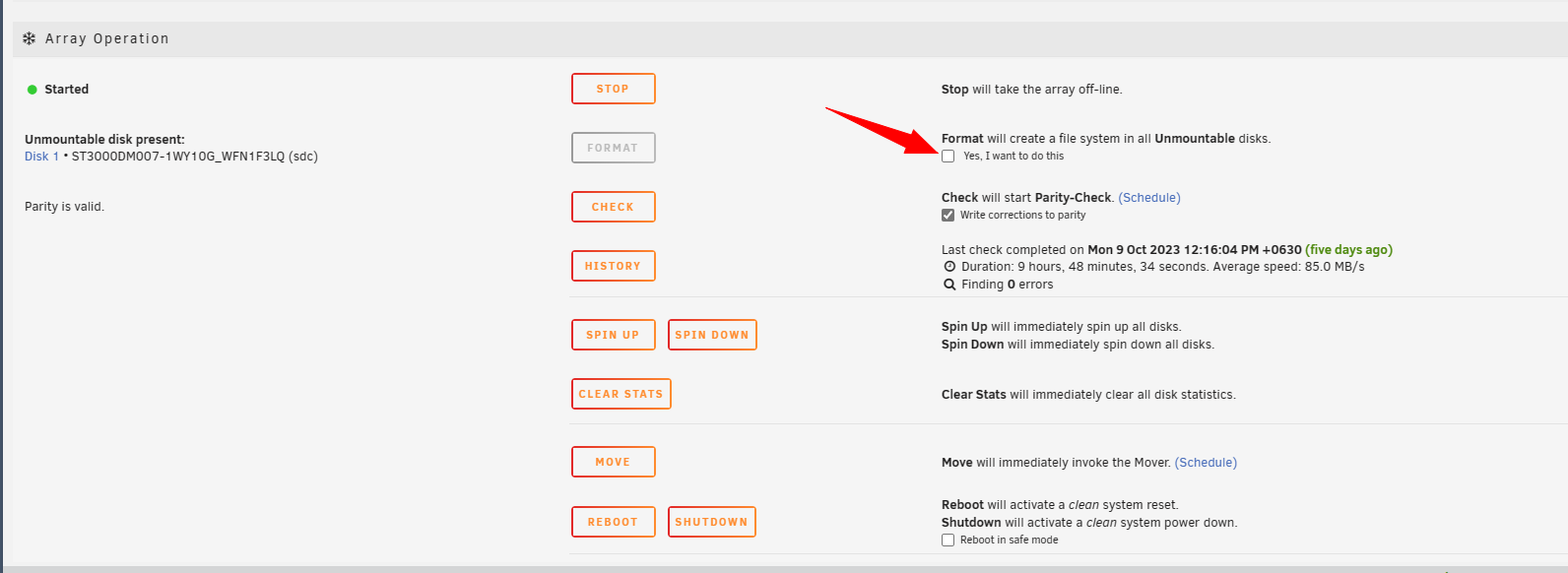

at the array option, it does show me that i can format disk 2. Should i format the disk ( 1WY10G ) and allow the disk to copy it back from parity? or will a formatted disk write make changes to my parity?
Whatever you do you must NOT format the disk unless you want to lose all its contents.

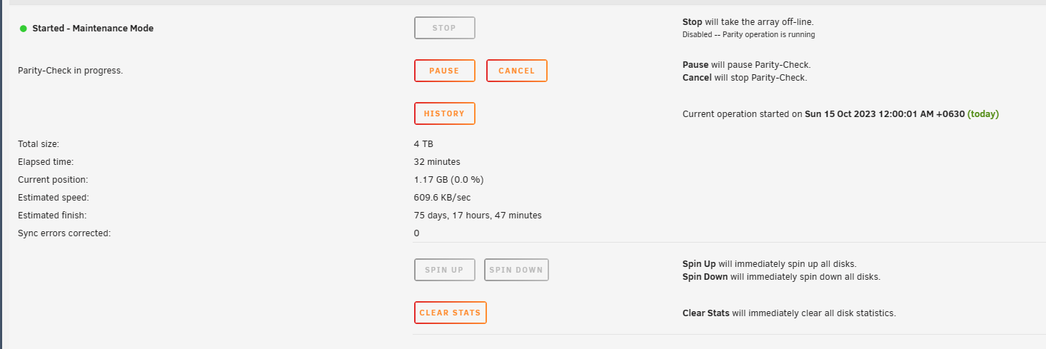

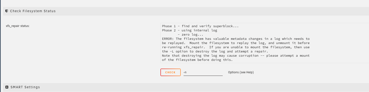

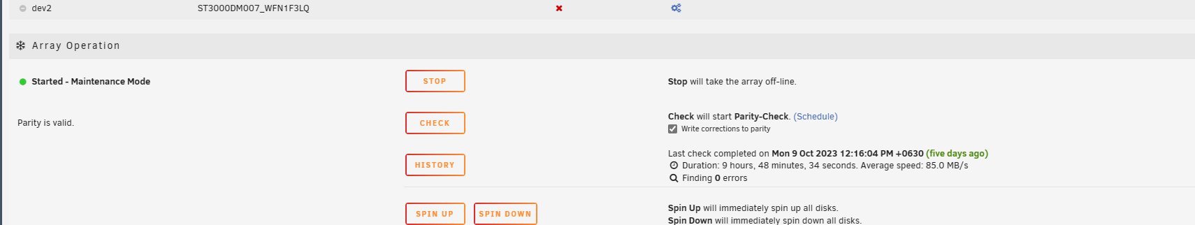

I have start the array in maintenance mode.
click on my affected disk, remove the "-n" and click on check. Error log as displayed below.
I think i have to run the xfs_repair using command?
You need to rerun that check without -n and add -L

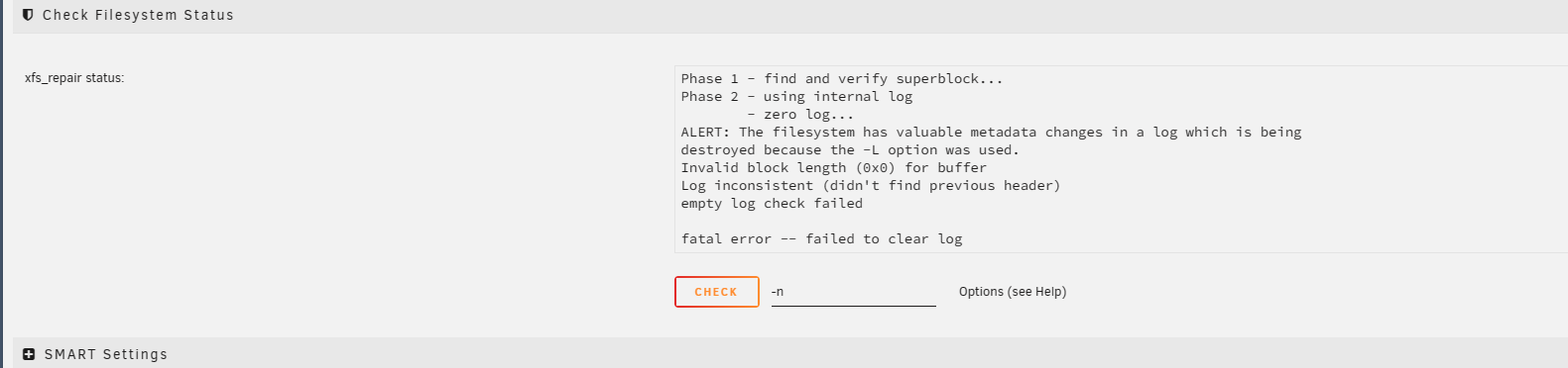

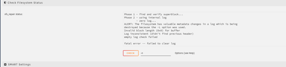

Hello @itimpi thank you for the guide,  i have rerun it without  " -n "  and added  "-L" , however, it still give me an error.
secondly, just to confirm, i am running the check with  "maintenance  mode" started.
Edited by spacezmonkey
It's failing to destroy the log, could the disk capacity be close to fully used?
I managed to "check " without " -n" and add "-L"  and it managed to complete the process without error.  Now I am able to start the array without any issue and disk is identified as well..  Thank you @JorgeB and @itimpi . It is working well as shown below and I am very glad of your kind assistance.

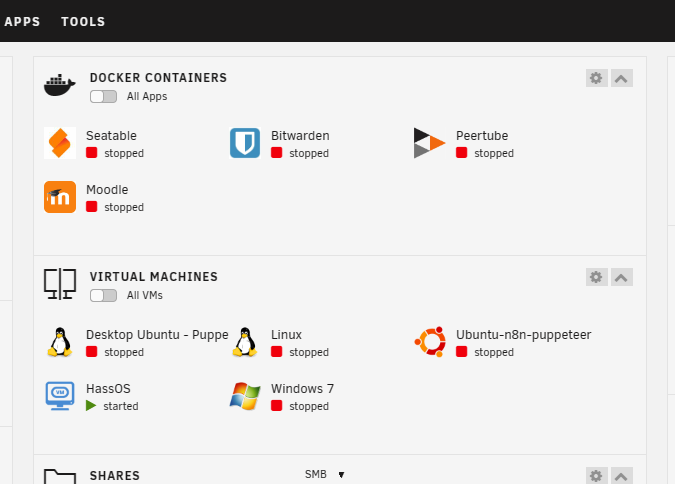

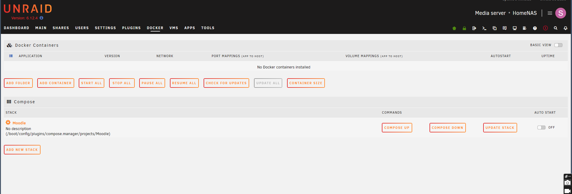

However, I am facing another issue now. My docker containers that was installed previously has disappeared.
However, i am still able to see icons of docker that i had installed using "docker-compose" on "Dashboard" page. Is there any method for me to see all my previous installed docker?
Probably can't help with that as I never used docker composer, but it's just the on dasboard? Do they show up on the docker page?
nope..it does not show up in docker page. Anyway i am reinstalling all the docker. Since harddisk is working well, my previous setting for docker containers can be retrieve easily.
Thank you once again for your help.
