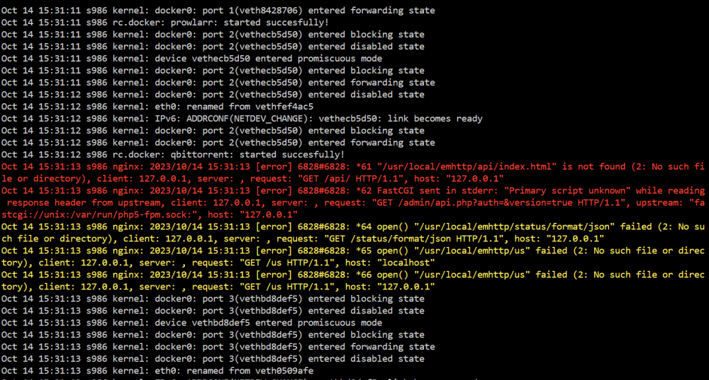

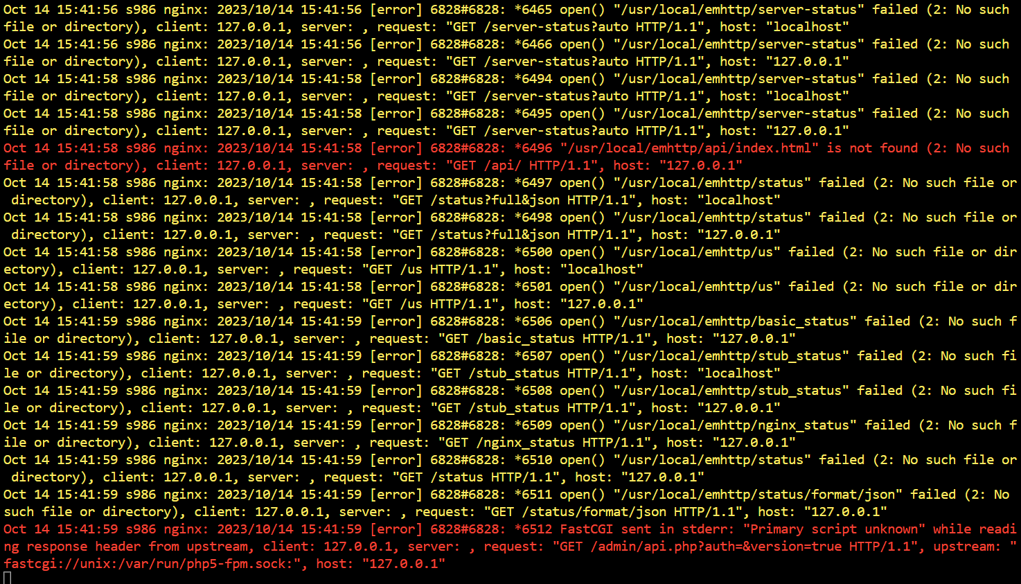

Would this help?

i only noticed below screen capture.
A single error is no reason for concern.
