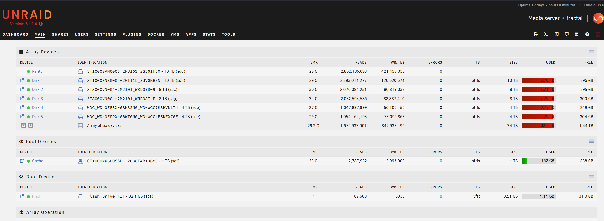

I wanted to replace the current parity 10Tb parity drive by a 12Tb in order to later replace drives in, the array by bigger ones.

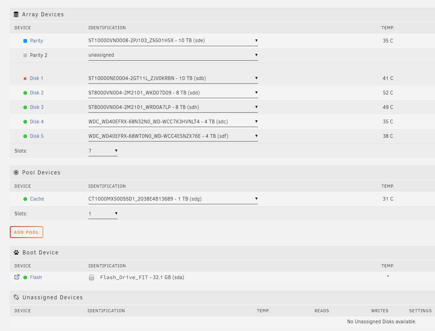

After replacing the parity drive, I booted the NAS, but disk one in the array appears as disabled.
So I put back the original parity drive, but it's now detected as new, and I therefore can't rebuild the array with a brand-new drive
Original configuration
current status

Disk was already disabled at boot so we can't see what happened, but the disk looks healthy, check/replace cables to rule that out, then and since there's no valid parity do a new config (don't assign parity for now) and start the array, if all disks mount normally re-sync parity.
I switched both sata and power cable on the faulty drive but still no luck after a reboot
Should i preserve all assignements for the new config ?
It is up to you although it is normally easiest and least error prone to start with preserve all and then make changes from that position.
