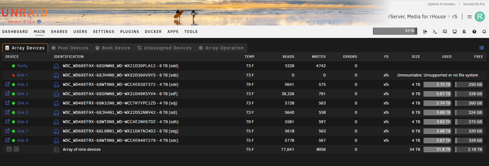

OK, I'm back.  Here is the "main" page of my unRaid gui.  I don't see my serial number or a "disk log information" icon.  I'm sure I'm looking right at it but can't see it.
3 minutes ago, JonathanM said:
OK, I see that you mean the serial number of the disk.  But that screen doesn't tell me the ATA number.  And, now I have a new error message that references an MD number.  Nor is there anything here that tells me which port the drive is attached to.  So, in this example if Disk 1 is giving me trouble I'd like to be able to know where it is in my rack and which SATA port it is connected to.
Did you click on the blue icon link to the left of the serial number?
