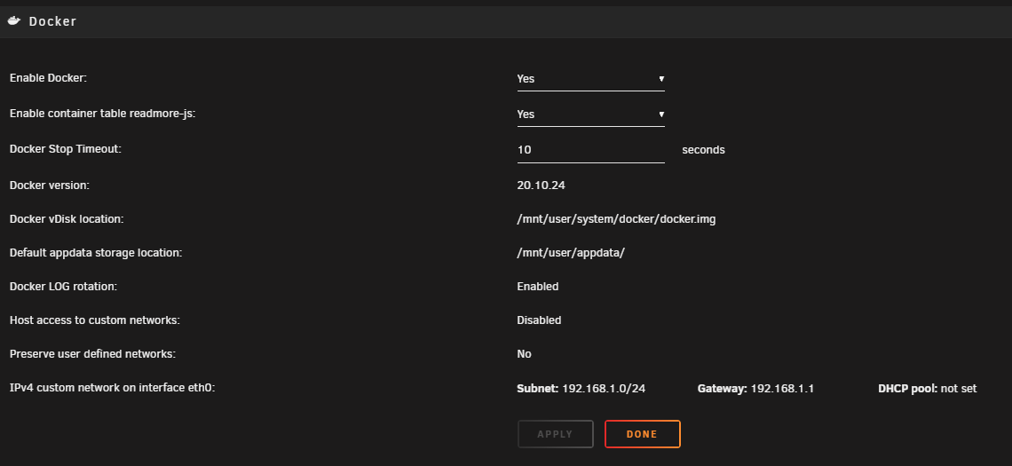

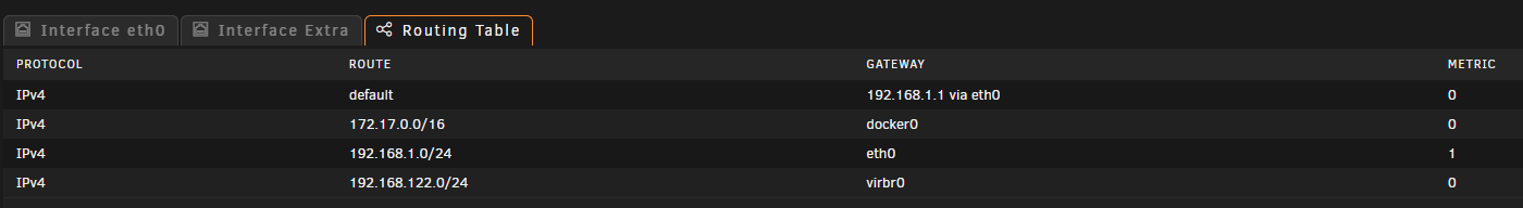

Can you share a screen of your routing table ind the network settings?

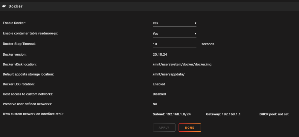

Also a screenshot of your complete Docker Settings
No worries - here is the info - but please - its New Years Eeve - you dont have to reply any time soon - I have been living with the issue for motnhs.
New years eve is currently noon in my timezone (12:40 CET) and i have three little kids (1/1/3) so I'm babysitting and messing around with my server 🙂
You have the same issue I had: vhost0 is missing in the routing table. I show you my config and my issues and how I solved it:
The Network settings should be:
- Network, Bridging off
- Network, bonding off (optional, if not really needed ...)
- Docker, host access on
- Docker, macvlan
- VM, vhost0

This was my routing table without vhost0 in it....like yours
After
- enabling docker Services AND
-Setting IP Custom Network to my standard Ip settings in the Docker Setting:
- 1561003235_Screenshot2023-12-31102754.thumb.png.ff88c0171c48e7a8e32b872eed89709c.png
Vhost0 showed up in the routing table:
Right after that I restarted the VM and everything is working as expected

routing table still the same however.

My settings are I believe the same as yours :
I dont have dhcp on the below which should not matter (all my dockers are hardcoded with IP addresses) :

I noticed I did not have host access turned on in my docker settings.  That was for unraid to access docker containers I thought - and nothing to do with VM's accessing host - once I alsoe set that on, then the routing table matches yours.
I have no ideas if the stability issues relate to this work or something else random.
For now, I have shutdown all docker containers except emby and cloudflare tunnels, and shutdown the VM engine.  Another parity check is running so I will leave that for a day, and then start bringing up the other stuff bit by bit.
All seems good and stable again - and the issue is indeed fixed and I can ping both ways.
Clincher was I suspect allowing host access in docker setup as well as the rest in your post (that is ambiguous - as I wanted to allow VM access to host)
