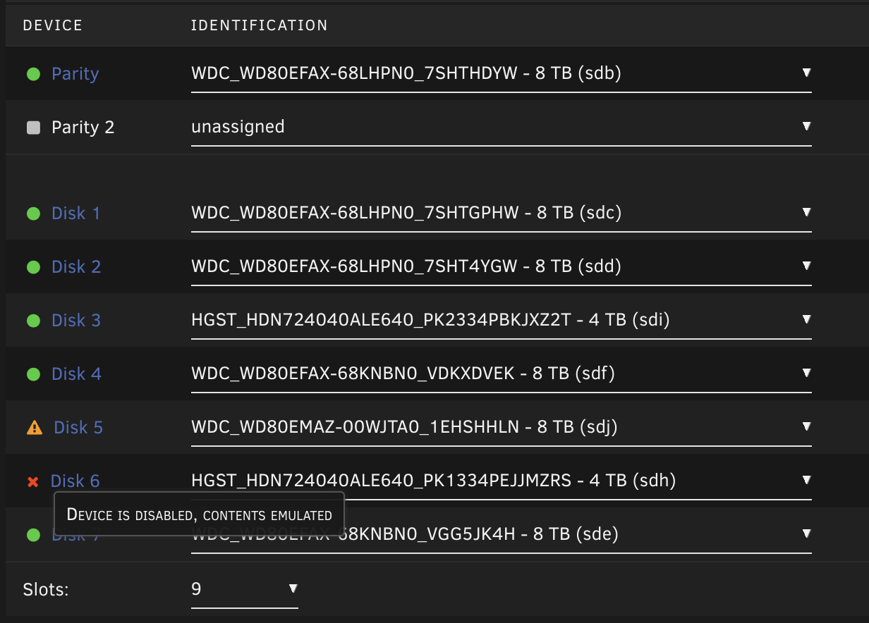

Thanks for your reply. I re-seated the HBA card, and all the sata connectors when I rebooted it initially, so that the disks would come back up, and I was able to get the SMART reports. My mobo only has one PCIe slot, so I just re-seated it. Maybe I should double check disk 5 connections, it might be the one disk that I didn't re-seat. It requires me to pull the case apart.
Is there anything I should do with that disk 5 with the `Inode allocation btrees are too corrupted` error, or does rebuilding it on top correct all those issues?
Sounds like next steps are:?
  1. Restart the array and let it emulate disk 5
  2. Check the contents of disk 5 to make sure they look alright
  3. Stop the array
  4. Remove disk 5 from the array
  5. Restart the array without disk 5
  6. Stop the array
  7. Re-add disk 5 to the array
  8. Restart it to have it start rebuilding
Steps 3-6 is how I originally had it rebuild disk 6, Is that the correct procedure?
Was there anything else I should with xfs_repair before, after, or in the middle of those steps?
Yes, run xfs_repair without -n or nothing will be done.
Steps look good, but run xfs_repair first and check contents after, also look for a lost+found folder.

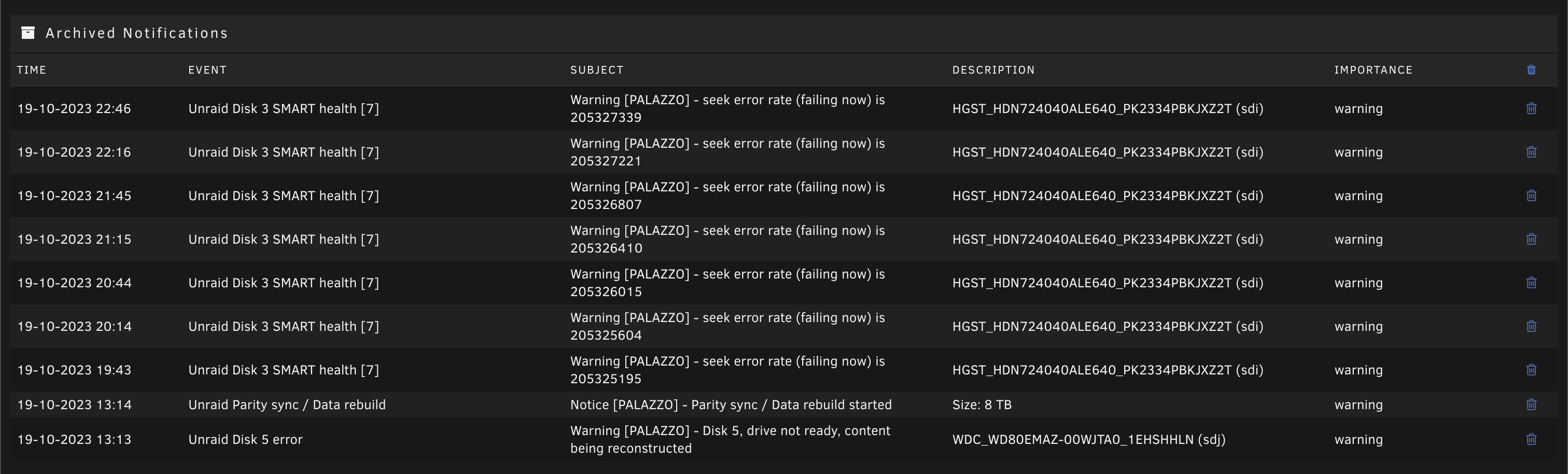

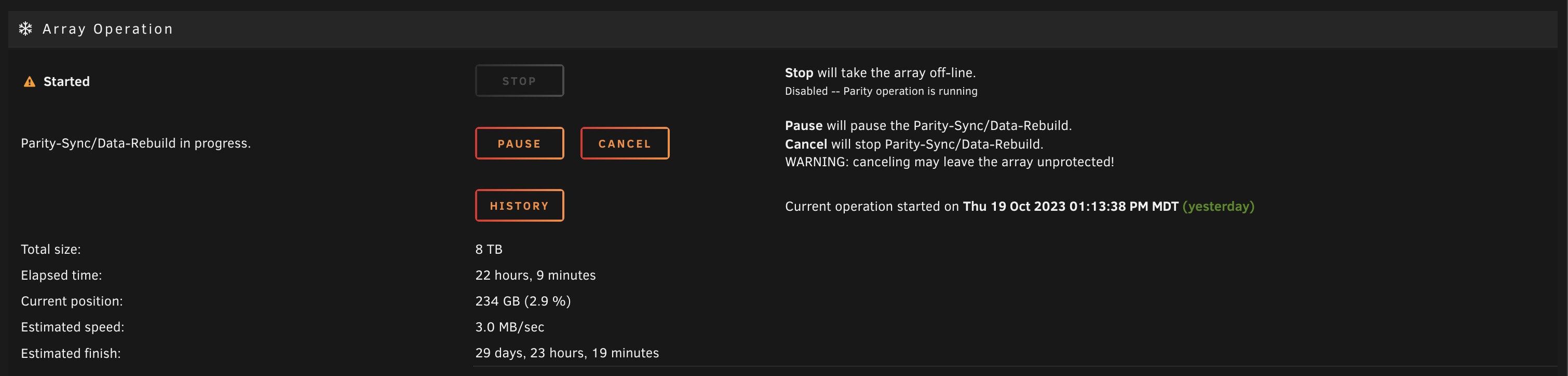

It appears that my disk 3 is having seek issues, and the rebuild is going to take forever. I'm guessing I'll just need to wait this out, and likely replace disk 3 when it's done. Is there any way to figure out what is slowing this all down? Would pause / resume help at all?
674241479_Screenshot2023-10-20at10_23_25AM.thumb.png.86f3f7c6abc225693c13874d8c07a83b.png
931002325_Screenshot2023-10-20at10_21_10AM.thumb.png.dd1c2b4629eaf3fb12af99688af95396.png
Post new diags.
No disk errors logged in the syslog so far, so for now I would let it run.

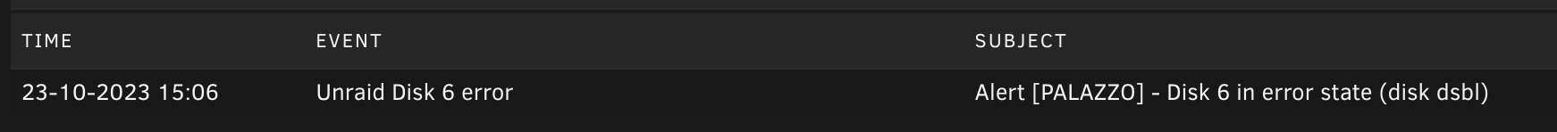

Well I got a new UPS yesterday, and got it charged up, and started running the sync again, and I just had another disk (disk 6) throw an error.image.thumb.png.b530e2ffe8093de121acbb9ceacc070c.png
Not sure what I do at this point.
palazzo-diagnostics-20231023-1509.zip
Looks more like a power/connection problem, but the disk dropped so there's no SMART
Shut down the server, pulled that disk, and re-seated it again. It came back up, and I was able to get the smart info for it. The UI is showing the disk as disabled.
Is there a way to make that disk be re-enabled, so I can continue trying to sync disk 5, or am I just going to have to start over?
That disk 6 is in a iStarUSA BPN-DE350SS-BLUE enclosure. I've ordered a new case that'll just fit the devices without this extra housing unit.
When you say power/connection problem, could it have to do with an under powered PSU? I do just have a CORSAIR CX Series CX500 PSU in there.
palazzo-diagnostics-20231024-0743.zip palazzo-smart-20231024-0742.zip
You can force enable disk6 to see if disk5 can still be emulated:
-Tools -> New Config -> Retain current configuration: All -> Apply
-Check all assignments and assign any missing disk(s) if needed
-IMPORTANT - Check both "parity is already valid" and "maintenance mode" and start the array (note that the GUI will still show that data on parity disk(s) will be overwritten, this is normal as it doesn't account for the checkbox, but it won't be as long as it's checked)
-Stop array
-Unassign disk5
-Start array (in normal mode now) and post new diags
Emulated disk5 is mounting, assuming contents look correct you can try rebuilding again.
Awesome thank you! I'm back up and running.
