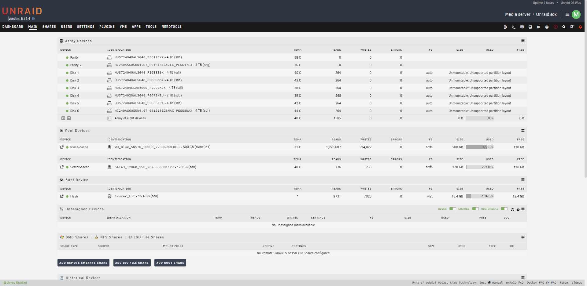

Hey everybody,
After swapping an ADAPTEC Raid Controller (ASR-5805Z) for an LSI 9211-8i I find myself with the drives saying:
"Unmountable: Unsupported partition layout".  I wanted to change because of some issues I've been having with Adaptec Card, and I knew it was bad practice running it so wanted to change.
Just to preface -  it's an Inspur "LSI 9211-8i" in IT mode. After hours of trying to get it working with my server, I finally got it working by disabling ROM boot in HBA BIOS, swapping it with what was my GPU's PCIE lane and eventually got it working by adding: "append pci=realloc=off initrd=/bzroot" to syslinux.cfg. All those things being necessary to get it to work. Drives always showed in HBA BIOS, but never passed through to the OS.
After this I could finally access webgui I noticed the SAS drive names were slightly different. So I proceeded to create a new config and started the array. That's when I was met with the aforementioned "Unsupported partition layout" warning.

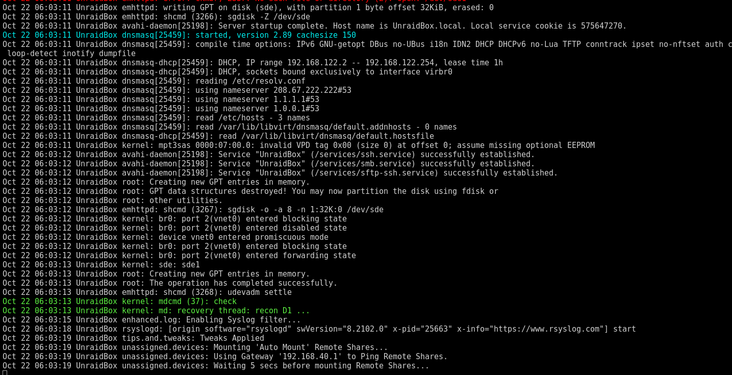

When replacing my disk with parity, I actually viewed the syslog to see what UnRaid was doing to create the GPT partitions:
Screenshot from GPU using capture card.. (not sure if gui syslog would have been running to see)
194705945_Screenshotfrom2023-10-2206-10-42.thumb.png.2b5c30e966bc9f83f3ef682ad00fd706.png

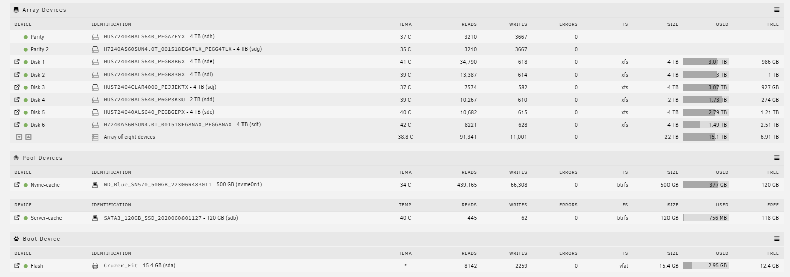

As you can see below all disks are mounted successfully.
I have some lost+found directories within the disk I mounted in R/W so that's on me. All the other disks are fine.
